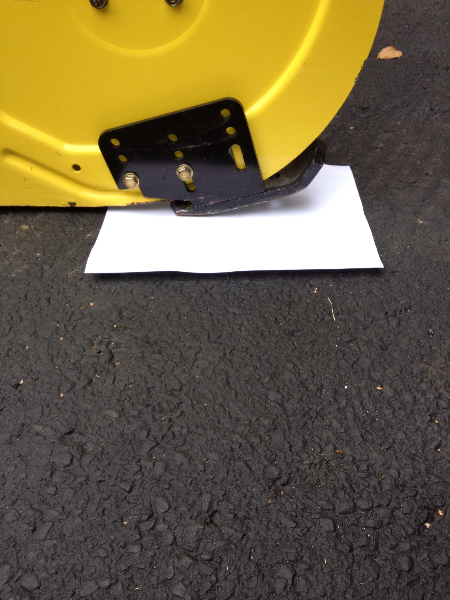

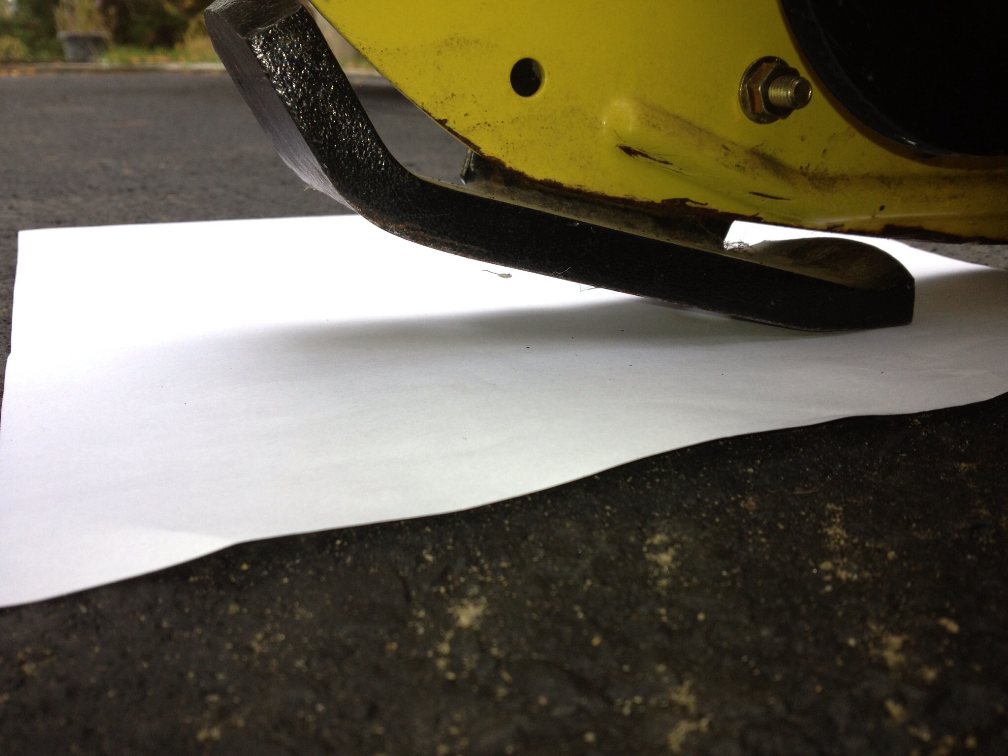

These shoes don't look like they are setup correctly.
What do you think?
   / Setting up my snow thrower an have a question? #2
They look like they are mounted in the wrong holes. The shoes should be relatively level when the blower is lowered.
   / Setting up my snow thrower an have a question? #3
Is this new? I hope not as the shoe should fit flat on the ground.
   / Setting up my snow thrower an have a question? #4
It looks to me that the shoe needs to be moved back a hole. Then I believe it would be close to level.
That's exactly what I was thinking.
The previous owner had it set up that way. It was that way when I got it.
Are those shoes gonna mark up my driveway? I just sealed it up nice on October.

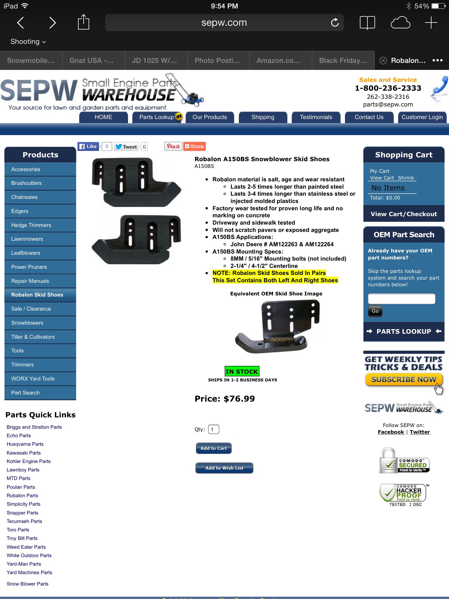

Yep, you need Robalon shoes
Found them, kinda expensive!
   / Setting up my snow thrower an have a question? #8
This is correct. They should also go on the inside, not outside.
When I set the depth on my shoes I put it on a flat surface with an 1/8 inch spacer under the cutter bar and the shoes flat on the surface.
