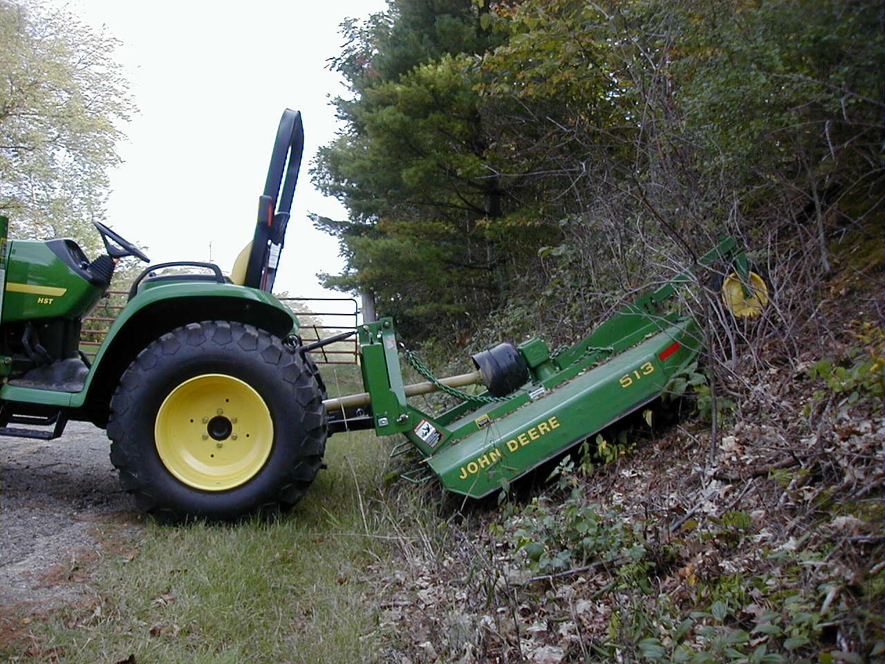

I have a pretty good idea but I'd like to hear from more experienced operators. I have a SQ480 shredder I use behind my B7300. I want to know how you set the cut height. I know about setting the height of the crazy wheel but is there anything about setting the 3pt height? I set the top link so the shredder picks up to an adequate height when transporting the shredder without cutting (lifted position). I normally just lower the shredder till the crazy wheel carries the rear weight then continue lowering till the shredder is level. Is this the proper way?
Do you set it so when the front tires of the tractor go into a dip, the "crazy" wheel doesn't lift off the ground?
Lengthen the top arm long enough so the 3 ph all the way up raises the crazy wheel about 10-12" off the ground. Then lower the 3 ph so the front edge of the deck is at the height you want to cut grass/brush. This should put the top arm connection to the u-shaped bracket hanging loose, so the rear wheels stay on the ground when the front wheels of the tractor go into a dip. Also will follow the undulations of the ground much better.
I hook my rotary cutter (shredder) to my iMatch, and replaced the straps to the rear of the cutter with chains. That gives the flexibility needed to adapt to ground dips and humps.

Beenthere; what you describe is pretty much what I do. I will never get into a situation like in your second pic so the u shaped flex link on the shredder where you attach to the adjustable top link of the tractor takes care of everything I'll ever encounter. BTW, thanks for taking the time to take the pics.
