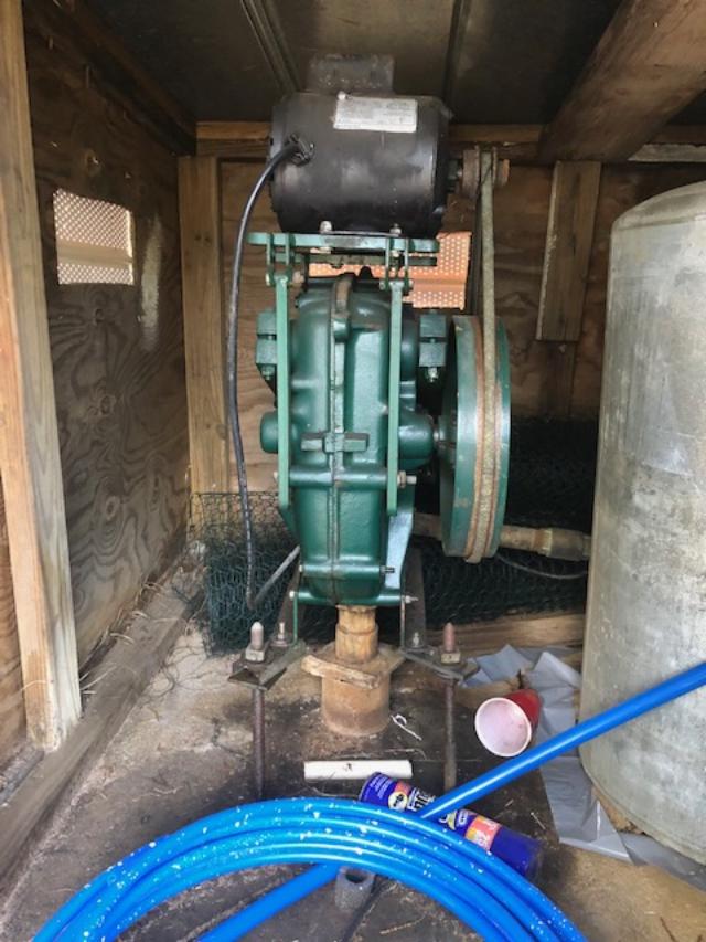

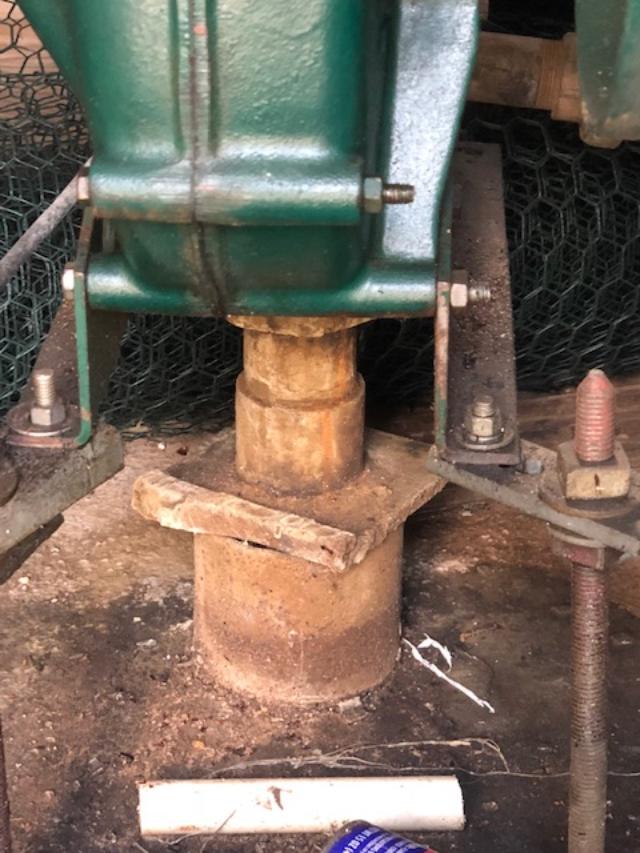

I have an old deep well on my property that isn't working. The pump works fine, just no water. From what i understand there are leather cups at the bottom that may have worn out causing a bad seal so no water can be pulled up to the surface. The pipe inside the casing is 3/4" iron pipe. Thought Id check to see if anyone on TBN had ever serviced one like this before. I've tried to call a few professionals within a 100 mile radius and I cant get anyone to either return my calls or show up for an estimate. Seems like that's the norm for customer service these days.

What is that thing? Does it need to be primed?
I don't know, but I do know the maximum you can only pull/lift water up is about 34 feet. (laws of physics).
How deep is the well?
Is that some type of "jet pump" or something similar that you have to fill/prime, that pushes a small amount of water down an inner tube that pushes (more) water up from the bottom in another pipe (i.e. 2 pipes go into well)? These require a foot valve or check valve at the bottom of the well.

To my knowledge there are three types of well pumps commonly used:
Submersible pumps that sit in the water in the well and can be at any depth.
Shallow well pumps that sit on the surface and can pull water up using suction but are limited in how high they can lift due to atmospheric pressure, about 32 feet, but really about 25 feet in practice.
Deep well jet pumps sit on the surface and shoot a stream of water down into the well to drive water up from greater depths than can be pulled.
To my uneducated eye it looks like there is just a single pipe going into the casing, which would indicate a shallow pump.
Is there a nameplate on the pump? Maybe googling will give you more info.
The two most common problems with shallow pumps are that the pump isn't primed, or that the water level in the well is too low.

A 400 ft well could still have a high static level. If I had to guess I'd say what you have is a shallow well suction pump. It may work if primed.
