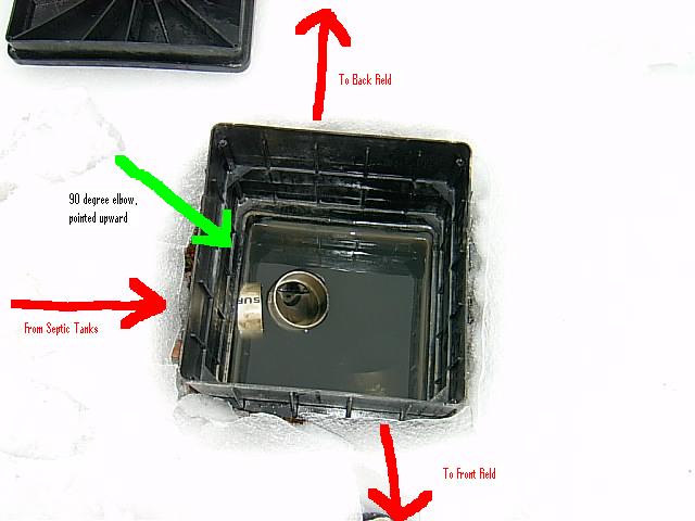

Here's a picture I took on May 12 right after the septic system failed the inspection. We moved in on April 24. It was quite a shock to us to find out a couple of weeks later that the inspector failed the system!
I bought the digital camera when we started building. I encourage anyone having a house built to take pictures every step of the way-- just in case! /forums/images/graemlins/crazy.gif

Egon:
We used to put in engineered fields around here, but the red tape in dealing with the county plus the state just got to be too much.
From looking at Andy's front yard, I am really surprised that an engineered field wasn't part of the original building permit. I can't see how that particular piece of land would perk.

5030:
Me thinks the drainage and soil type for a much larger area have to be looked at in this case.
And yes, I do not see how a conventional system would be allowed for installation.
Hakim gave some real good advice as this is one that will require detailed knowledge of the area and systems.
It could almost be alledged that a popular builder may have a little help in getting approvals.

Egon:
When I looked at Andy's picture of the water logged yard. I thought to myself 'no one in the trades with an ounce of knowledge would put an in-ground system in that area'.

To Andy, I'd get the opinion of a Sanitation Engineer, board certified and get it in writing. Secondly, I'd get a good mouth piece, one of those $250.00 per hour ones and let him lay down the law or should I say lay down the suit against the township, their inspectors as well as the general contractor for punitive as well as compensatory damages. At that point, after you have built the fire, I bet the township and the contractor will be pretty happy to resolve your problem.
