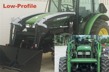

GLowplug is exactly right, you must consider your material handling applications. That is the best way to determine what you need. The self-leveling option will add approximately 20% more lift capacity to a loader. It is due to the added linkage. It adds a mechanical advantage, very similar to how using a lever in other applications adds more strength. Most self-leveling features (except the hydraulic version) will add 8" to 12" to the height of the loader causing visibility issues. Make sure you see the loader model on your specific tractor before deciding. Look for a low-profile fit if you choose the self-leveling option. See attached photo.
We have had people who love the SL feature and won't buy anything else, and we have had people who dislike it. If you are doing a lot of repetitive work like unloading trucks or stacking bales, it is a great upgrade. If you are going to do general farm yard use, handle loose fine materials or dirt work, you won't miss it. It is soley an operators preference based on materials he intends to handle.
