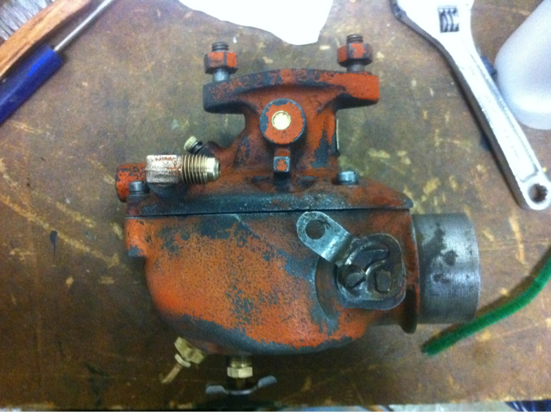

I'm ready for Saturday. Would love to try to start the wd45 that was locked. (aim high right) painted carb for it tonight.
