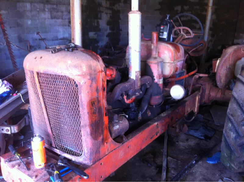

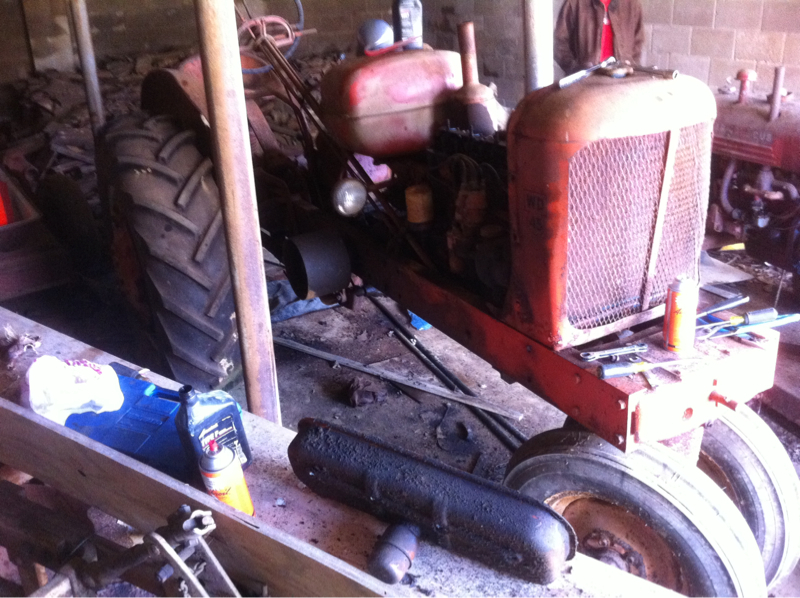

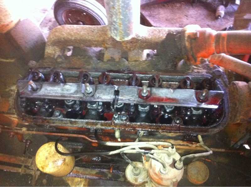

Added kroil into cylinders today. Pulled drain plug and it was oil. Soaked hood in kroil finally got it off. Pulled valve cover off and marinated with kroil and ATF. Aired tires up and gently rocked tractor with no luck. Manually pushed valves and they were all free. Rocked tractor some more and it broke free.

That Kroil is really good stuff, smart move.
/ Seized motor AC wd-45 #11
I agree, kroil is some good stuff. When I got my dozer the engine was stuck I remove the head and got all the water out of the cylinders and soaked them down with kroil went to work for two weeks came back and engine was free'ed up.
/ Seized motor AC wd-45 #12
The ol' girl looks pretty clean inside, considering..!!
#13
Yes considering how long it has set in a humid basement. It kind of looked like the oil residual turned to anti seize in the top end. Think the next step is drain crankcase and fill it up with diesel or something to loosen buildup. Then drain and fill with good oil. Wife's grandpa was so happy it broke free... now I think he wants me to get it running. I left it for now with cylinders full of ATF to soak till I return. I think I will start moving towards getting it running. Her grandpa is not doing great, but he also wants me to get another WD45 and a cub running. Both have set for long time.
