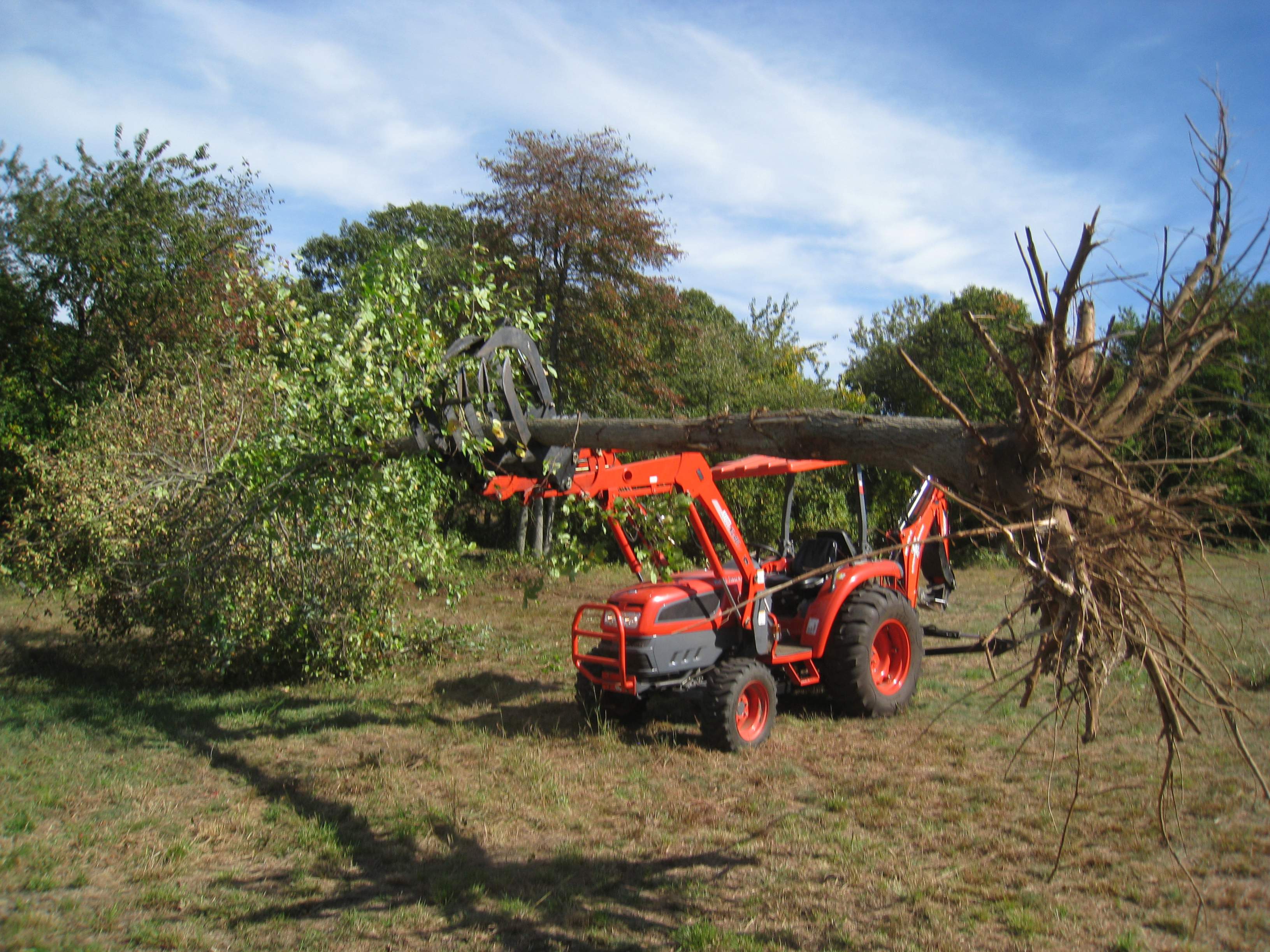

I will have to admit I have never wished for a wider grapple than my 50 inch. I have wished it were narrower a few times.
IT did you see what I built as and attachment for my 50 inch EA Wicked?
http://www.tractorbynet.com/forums/...y-wicked-grapple-bush-grabber.html?highlight=
Pretty cool James. I like both yours and rswyan's.
I've never felt the need for actually grappling the above ground portion of a sapling or small tree. My technique on smaller trees and bushes is two steps: 1) push the sucker over to expose roots, 2) once it's over the roots are exposed so I just slip my narrow grapple under the whole rootball and pop it out. With shallow rooted trash trees I can even take on bigger than sapling trees with this technique. With bigger trees I raise the grapple and push from about 8feet for leverage. Sometimes it takes pushing from more than one side to loosen up the roots but once I can see the roots pop up I just stick the grapple underneath, stick the tractor in 4wd low and push while curling the grapple. The last photo was a tree that I used my BH ripper on to cut the roots before pushing it over. Probably could do that with the grapple but it would be much messier finding all the roots. The ripper is great for that size tree.
Yeah, but I can latch on and pull grape vines out of trees!:D
   / Seeking Grapple Wisdom #35
Now that is something I would like to do. We have horrible fat vines in some of our trees. I usually dismount and wrap them around the grapple tines because it is impossible to actually clamp on them.
I think a ripper is critical.
I have tied pushing over small trees with no success.
The smaller ones just bend and the larger ones bend and break.
I'm working mostly on Ash Trees.
When my driveway was put in thru 900ft of hardwoods the excavator had to pull the stumps of lots of trees. All he used was a single tooth ripper on a large back hoe. Rip roots on both sides of the stump, reach over the top of the stump and pull the stump out. On some of the larger ones he had to rip all 4 sides several times going deeper every time. Even then at times he lifted the back of the back hoe off the ground.
Gave me new appreciation for the strength of a oak tree. Every thing over about 12" had to be ripped first.
