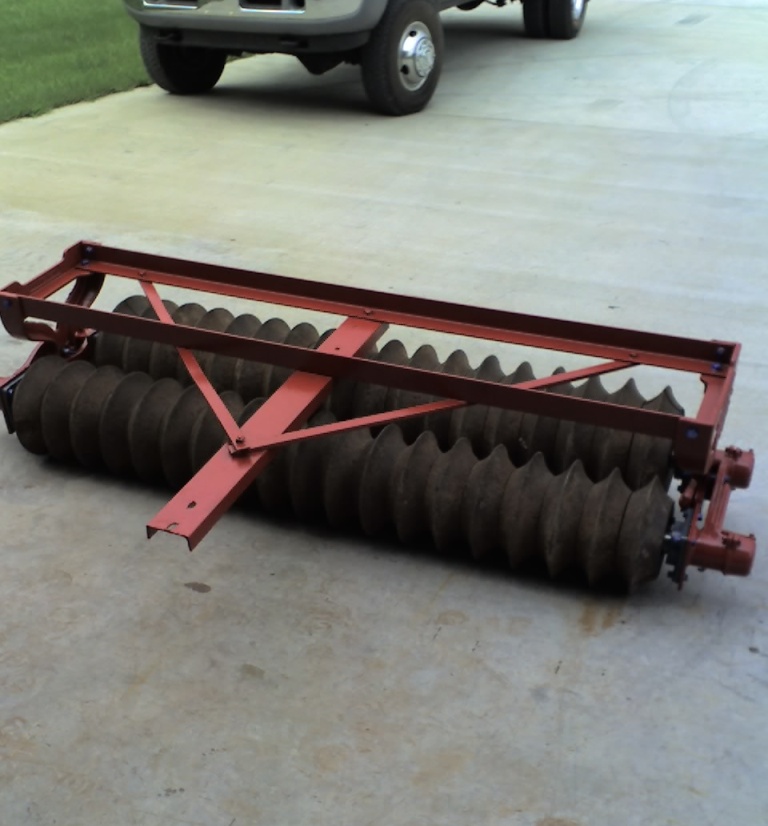

Although I have had my NH TC45DA for a few years now, I have used it mostly for construction type work, and to brush hog. Now I am facing seeding a cover crop (a mixture of fescue, clover and brome) over an 8 acre area, which will be covered with 3" of staw, all for erosion control purposes.
I will be discing the area this weekend. After that, my plan was to rent a spinner type broadcast spreader for the seed. After the seed is broadcast, what, if anything, should I be doing before a I rent a straw blower and cover the field with a layer of straw mulch? Can I simply disc it again, or do I have to run some type of harrow over it, to get the seed buried a bit?

There is a very old implement made just for that. It's called a culti-packer. Mine was made in the 1920's and works just dandy. :)

Grass seed DOES NOT need to be buried, nor does it do as well when buried. It needs to be pressed into the surface to get positive contact with the dirt though. Dargo's "cultipacker" is the ideal tool for the job. A drag will bury some (to most) of your seed effecting germination. Grass seed needs sunlight to germinate.
The best landscape seeders have a press wheel arraingment simular to a cultipacker. Grain drills with a grass seeder attachment merely drop seed on the surface and drag a chain that just BARELY touches the surface.
And IMHO, 3" of straw is WAY too much. Just enough to barely cover the ground is more than enough. 3" will cut off sunlight from your seed.

I use a harrow section if the soil is dry, then the cultipacker. When it is wet I only use the cultipacker and it pushes the seed perfectly in the ground.

I like to run the cultipacker, then seed and run the cultipacker again. Grass seed needs a firm seed bed.
