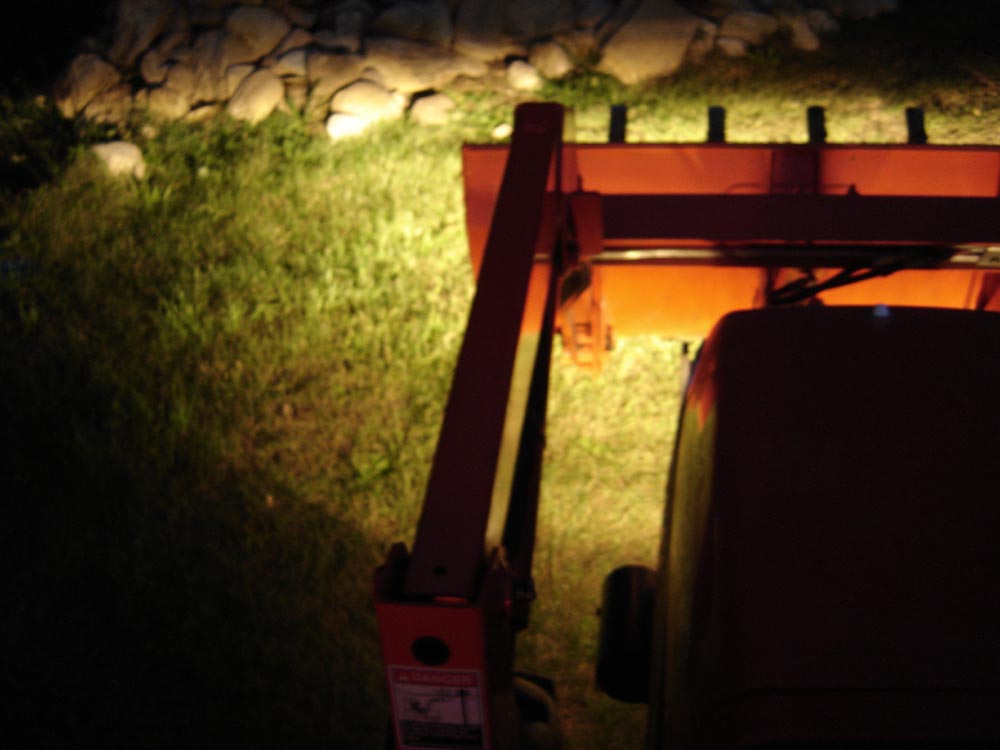

#13
They work as good as I hoped they would. After it got dark I started up the tractor and turned on the new lights - and it illuminates the ground right in front of the tractor and about 20 feet or so ahead of it. Because the lights I used are foglights the beam cuts off very sharply and most of the light gets thrown the ground, which is what I wanted. I did not want to be shining lights into my neighbors windows and stuff like that. Pic attached shows view from drivers seat.

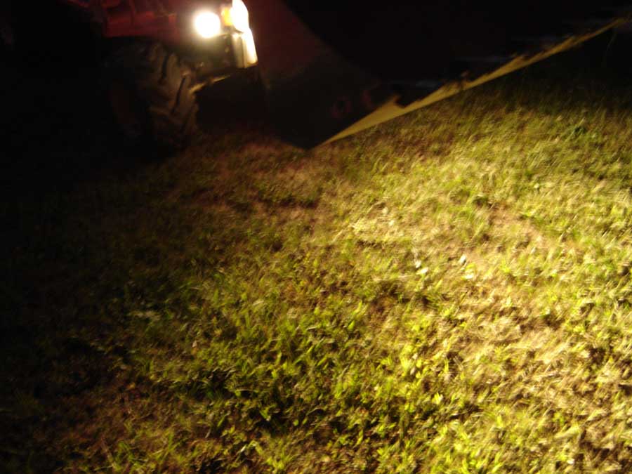

#14
Another view from the drivers seat.

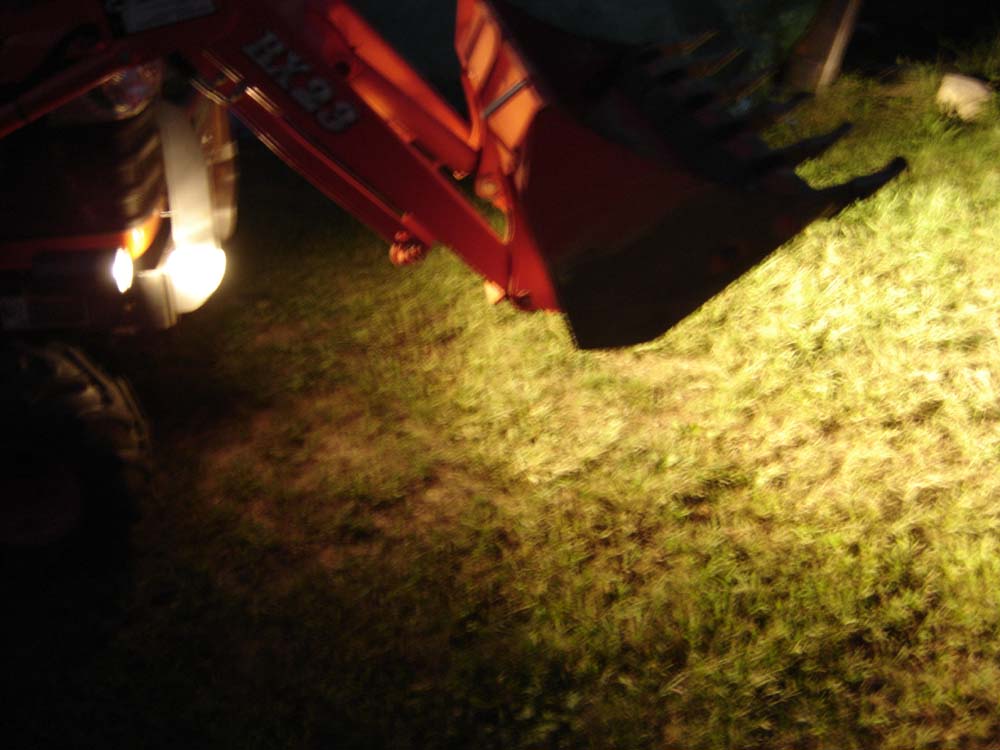

#15
With the bucket at a good carrying height I get plenty of light on the ground right in front of the tractor. I tried turning the headlights on and they contributed absolutely nothing to lighting in front of the tractor. This is much better.

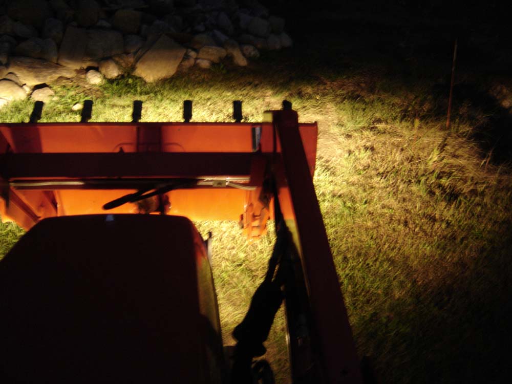

#16
Another view showing how the light goes under the bucket.

What would you see if you were to dig into that pile of rocks shown in front of the loader? Would the shadow of the bucket block out much, or would the new lights still 'light your way' ?
Your mod looks great, IMO. Will keep it in mind this winter when I plow snow, as that seems to be the big use of my tractor at night. Not too much loader work, but your mod looks very successful indeed.

With the bucket down on the ground in a digging position the headlights will light the ground because they will shine over the bucket. It's only when you raise the bucket to a safe 'travel' position that the headlights become useless.
