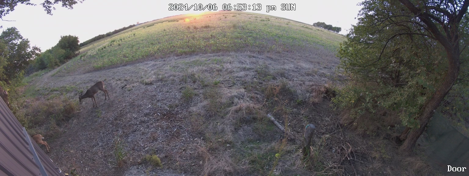

I love those! I have 3 and will get 2 more next time I order. I do wish I mounted the two on my blind a little lower though. They have a fairly narrow vertical viewing angle, so being up high and aimed down, the center of the image looks squished. If the camera was 3 foot lower, and aimed more straight horizontal, it would be much better.
Look at the horizon line in this image:
Since this camera also serves as security monitoring for the deer blind door directly below it, I need it aiming down like it is.
