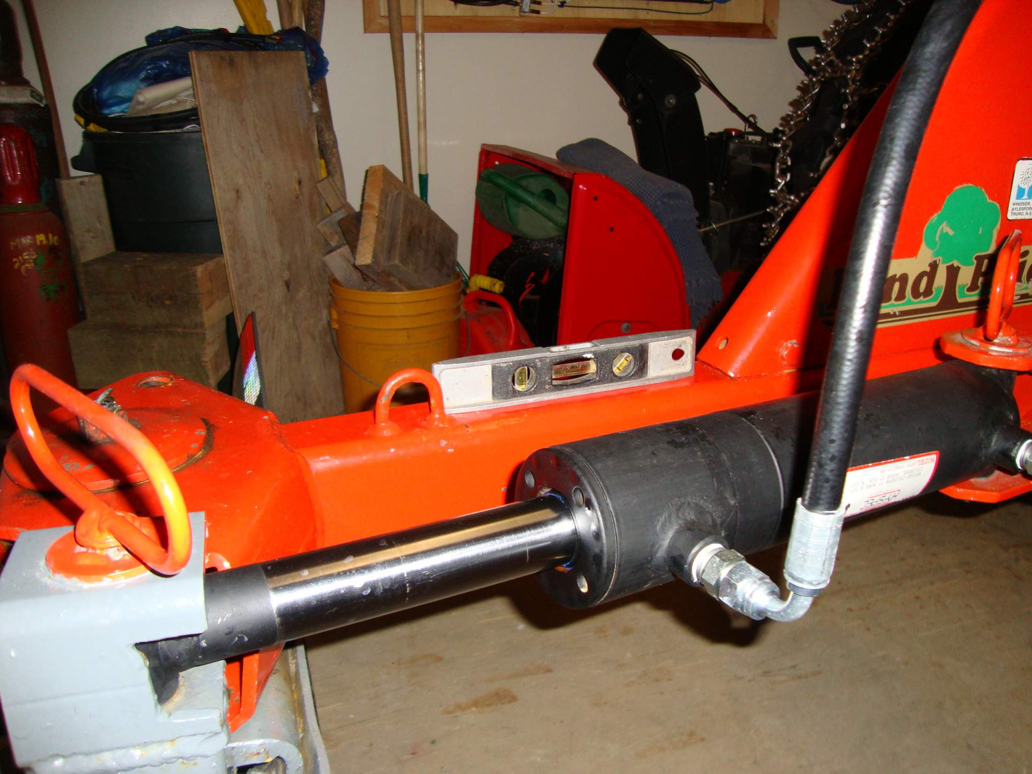

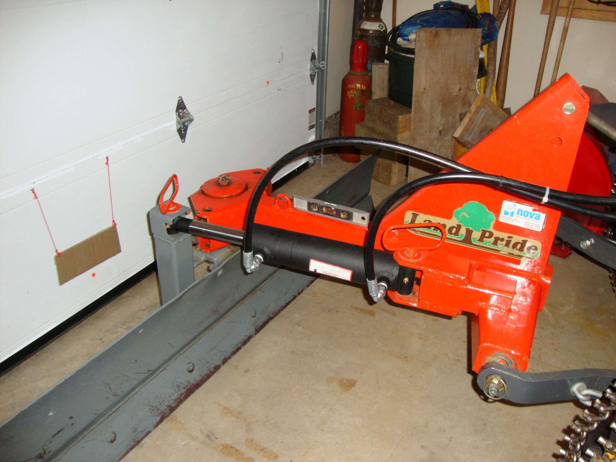

Sean, I just have to ask, are you ever going to paint that blade black?
/ SECRETS TO USING A SNOW BLADE #30
Brian,
Now that's a good question.. it was sorta blackish when I got it, but the rest of the blade was the Land Pride yellow/brown/whatever-ya-call-it kinda colour. Me being a Kubota owner (note the GREY paint on the end of the lift arms?) I decided I'd paint the blade grey, and the rest of the blade is now K-orange.
I have to admit, I'm running low on grey paint though. I guess this means I'm gonna have to buy some more.. grey paint!
Loosely translated, the answer to your question is .. not anytime soon :)
Sean
/ SECRETS TO USING A SNOW BLADE #31
Sean, I had been thinking that it was just primer from when you had been fabricating. The OEM Land Pride from Kubota dealers has the Kubota Orange frame work with black blades.
Thanks for the answer though. ;)
