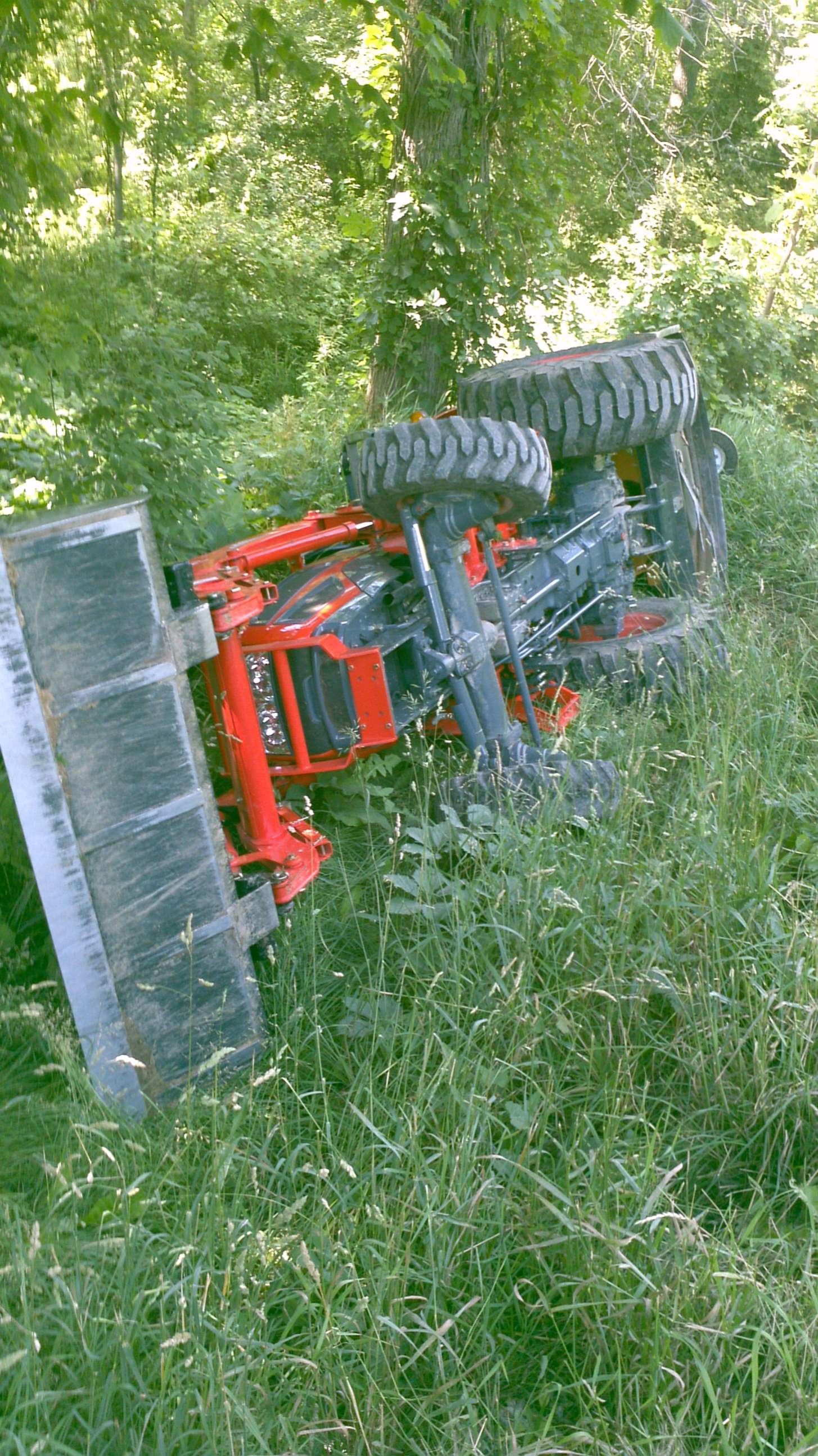

I had a very close call and was VERY LUCKY!
I was just finishing 5 hrs of bush hogging and was heading back to load up.
Driving on the gravel road trying to clip the edge of the grass and was fully aware of the ditch bank conditions as i had cut there before. No seat belt not going fast and before i knew it I was lucky to be standing looking at my tractor on its side? To keep a bad story short the front wheel dropped off in to the ditch about 8" I stopped thought i could back out and before i knew it ?
Be safe things can change in the blink of an eye.
Damage shear bolt on mower and my pride.
I hope this reminds you to use your seat belt.

So did the tractor engine stall? How did you put it back up on its wheels? Did it restart easily? How fast were you moving?
I wear seatbelt and ROPS up whenever I mow. I too follow the ROPS up=SB on and ROPS down = no SB. I need to park my tractor in a low shed so the ROPS gets folded down each day.
This thread is less about seatbelts and more about rolling your machine.

I can only go by the pictures you posted and what you wrote so if I am missing anything, forgive me. As a post mortem, my two cents:
The front wheels appear to be turned to the left and you say that you were attempting to back out. I would say that that was the fatal mistake, so to speak. As you found, this caused the unloaded RF wheel to go unsupported. This weighted the LF wheel and the RR wheel, unweighting the LR wheel. The differential would then split the traction to both unweighted wheels (they offer last resistance) What traction there was, if going in reverse, would tend to swing the front of the tractor even further into the ditch, rather than out of it. Also, with the weighted RR wheel on the ditch side it probably was too much for the embankment and it gave way.
With the weight of the loader over the front it was enough to throw the thing over on its side despite the added balance of the mower.
So in retrospect could you have done anything to save it before it went over? Is there a chance that you could have saved it if you had stayed in the seat and not bailed out? Maybe. Maybe if you had backed up straight instead of trying to steer it out, or brought a truck around and chained off the front to the truck's bumper to stabilize it as you backed it out...dunno.

Thankyou all for your concern and comments
I'm not saying that you have to wear your seatbelt! I'M glad i wasn't wearing mine. This post was to inform my fellow posters that took the time to read this of how things can go wrong quickly and to be aware. I now pay alot more attention to where i am, what i'm doing, and should i have my belt on.
NOW to answer some of your questions.
-Now that i look back and think about it I should have stopped and assessed my situation.
-I know i could have gotten out with out rolling the tractor on it's side but I made a split second decission. As for getting her uprighted I was lucky my buddy lives close bye with a full size BH. We strapped it at the rops and the top loader mount and gently set it back on her wheels. It was still on a very steep angle so he held it there until i started it and drove it down on to the level.
Quick answers
-it was still running walked over and shut it off
-i rode it out then stepped off in the direction it was rolling not sure why didn't have much time to decide.
-when we up righted it we let it sit for 30 second to let the oil drop and it started right up then went full throttle (3000/ 3500 RPM) i turned the key off but it reved for what seamed like eternity (10seconds) and blew white smoke big time. It was dieseling from the oil that ran into the air brether.
-All is well tractor and I
Thanks again and enjoy your tractor (safely)
HB
