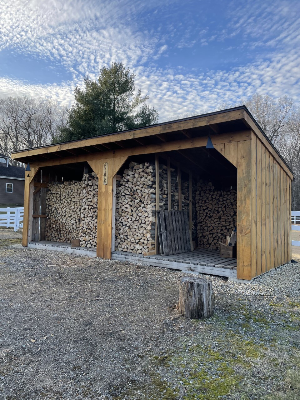

Using a moisture meter is definitely a good idea to know for sure (especially if you are buying your firewood). They are not that expensive (think Harbor Freight) and well worth it. I like to periodically check how dry my firewood is ( I harvest and process all our firewood). My goal is to keep it under 15% before burning. The stuff I am burning now is about 10-11% and has aged 2 yrs. Historically, most of what I burn is a year old.
As far as storage to dry, I got tired of tarps and pallets. Both would deteriorate over time and I always needed to remove snow off the top and some of the wood would end up getting wet anyway. Decided to build a shed a couple years ago and it has worked out great. Only wish I did it sooner. The sides and floor are spaced to allow air venting and really seems to make a difference.
What the size of that shed, I been storing wood like you past 20 year, this year a shed is getting built.

I usually get a load of logs in winter, between now and April. If winter isn't to bad I get out and cut logs into 17" pieces, in April / May I will split to size, leaved piled up until September. Usually get enough wood for 2 season out of a load of logs. The stuff I split this spring will get burn this coming winter. I never have issue with wet wood, clean the chimney and stove pipe every fall with minimal creosol.
I have been stacking in rows on pallets covered with plastic. It works but shed seems like a nice upgrade. Was going to do it last year but lumber was crazy high around here. I like the way you designed yours, hope you don't mind it will be my starting point on my build.

Its 10' by 24'. Definitely adequate for my needs.
It was a fun project. You won't regret having one. (y)

Appreciate the compliment, thanks.
Fortunately, I built it before all the lumber craziness started......guess I got lucky timing-wise. The rough cut lumber I used for siding was from a local guy and was very reasonable.
Look forward to hearing about your progress. You might consider starting a thread during your build so others can get some ideas or offer some to you. Kinda wish I did.....but I guess I was too busy building the shed...LOL.
Best of luck with yours. I'm no pro by any stretch of the imagination, but if you have any more questions on mine that might be helpful to you, let me know.
