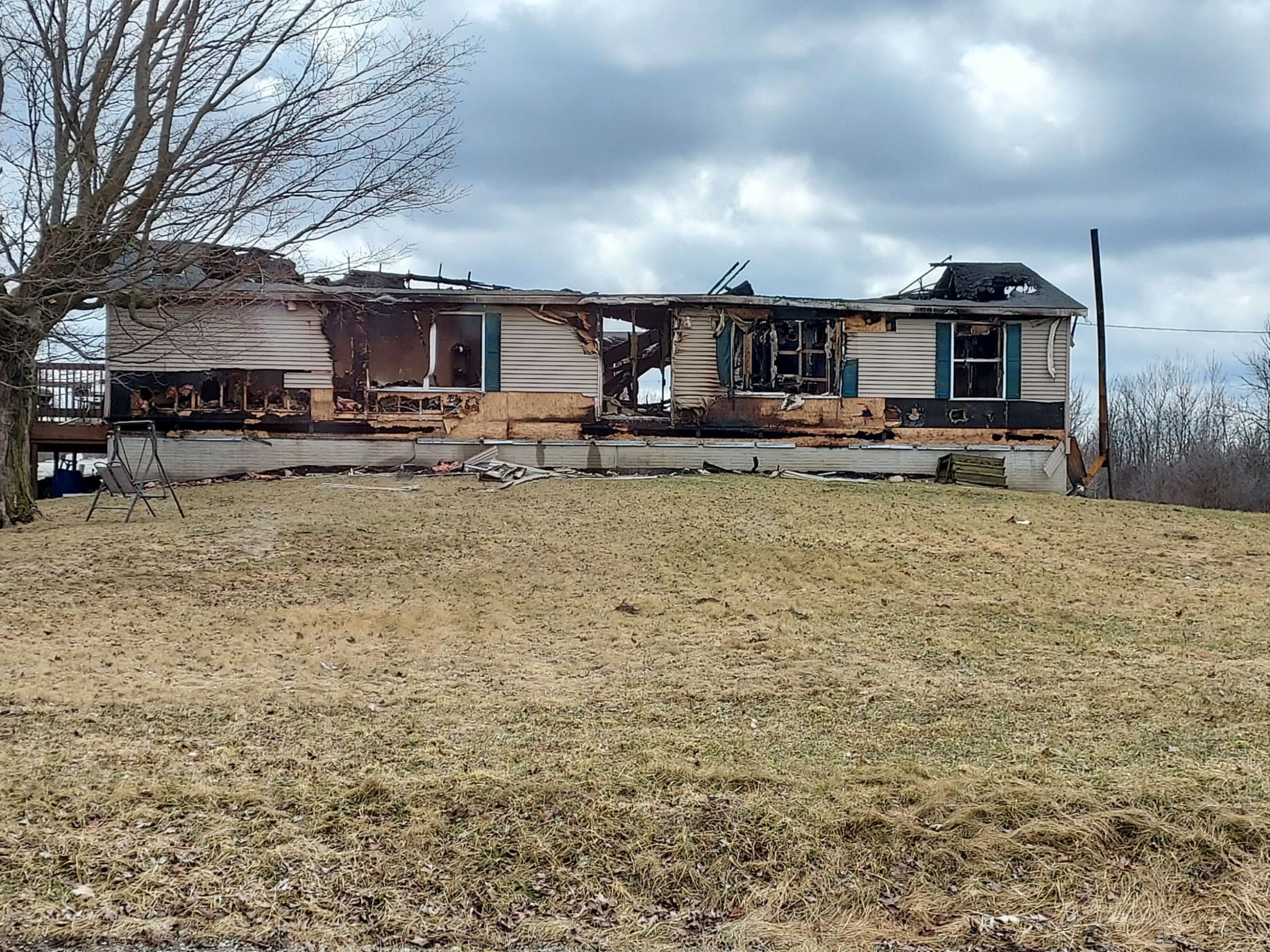

This is my neighbor's home; it happened a couple months ago and is what happens when you burn too green of wood!
as in a chimney fire!

The byproducts of combustion are co2, h2o, along with others. For every lb of wood, 50% is produced as water in the form of steam. Add the moisture content to that. That's a lot of water that can condense in a cold chimney. It only takes a few days to completely plug a pipe with creosote if you let it. As a beekeeper, I was able to create, and burn back off creosote in the smoker. Puff the bellows hard and away it goes. Fun to watch, volitile stuff.

I had a chimney fire once, maybe 30 years ago. Man was that scary! Fortunately, the chimney had a liner and at the time lived where the fire dept. was only ~10 min. away. No damage.
As it turns out there was a slight restriction about 2/3 of the way up, and creosote built up there. Made sure to be extra careful cleaning it from then on!!
