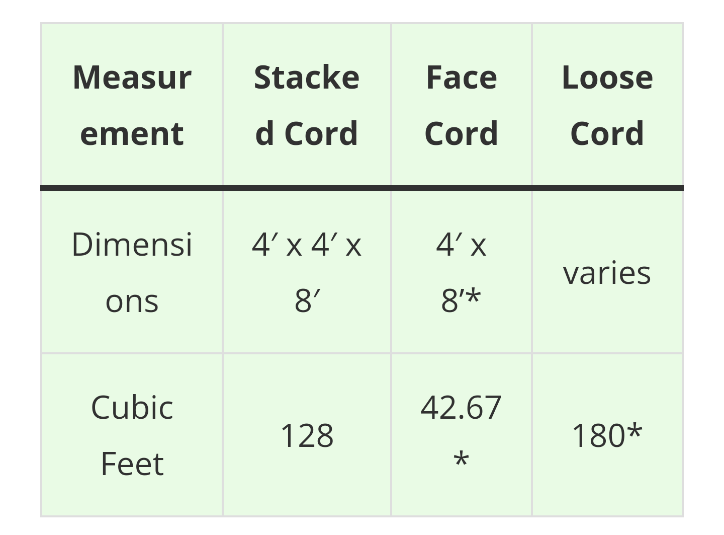

I agree on the IBC totes. I now have 30 totes and plastic lids which equates to almost 3 years of wood supply for my use. I also stack the split wood directly into the totes from the splitter and also built a deck off my back door that will hold 4 totes at a time. I have since bought 2 rubber tired - heavy duty 4 wheel wagons from Northern Tool which will each hold appx. 1/4 cord with the extended plywood sides I have attached to them. I then fill the wagons from the totes on the back deck and wheel them onto my back porch. The wood stove is appx. 20 ft. from the wagons on my back porch. My back is already feeling 20 years younger - just telling this story. The biggest impediment to this whole story is just having a tractor with a loader strong enough to lift IBC totes filled with hardwood to a height of 4 ft. to get them ont the deck.

I stack the wood in the totes and I estimate appx. 3/8 cord per tote when done this way. Currently I am burning mostly Ash - but occasionally I will fill them with green Oak and my tractor still moves them, but I can tell there is considerable weight on the end of the forks.

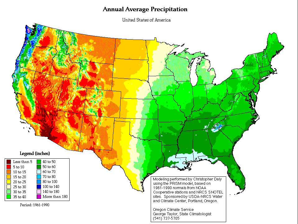

When we burned wood - we stacked it in a woodshed. Stacked because there was only enough room for five chords. We burned five chords a year. Harvested and stacked in the early spring. Burned the coming winter. Pine - by fall it was dry as a popcorn fart.

You have very dry low humidity summers where you are? Whenever drying success and methods come up, location has a lot to do with it. Here in se Wi, I can get away without top covering, then after a midsummer drought get it under cover. Guys out east or the northwest coastal areas need more time and top covers. Also hardwoods are far different than soft.

You could hear the split/stacked firewood "cracking" in the dry summer weather. Pine dries quite quickly and easily.

I would start by searching craigslist and/or facebook marketplace for "IBC". I got my first 12x for $25 apiece (275 gallon size, = 40x48x48"), with no plastic tanks of noxious chemicals to deal with.
