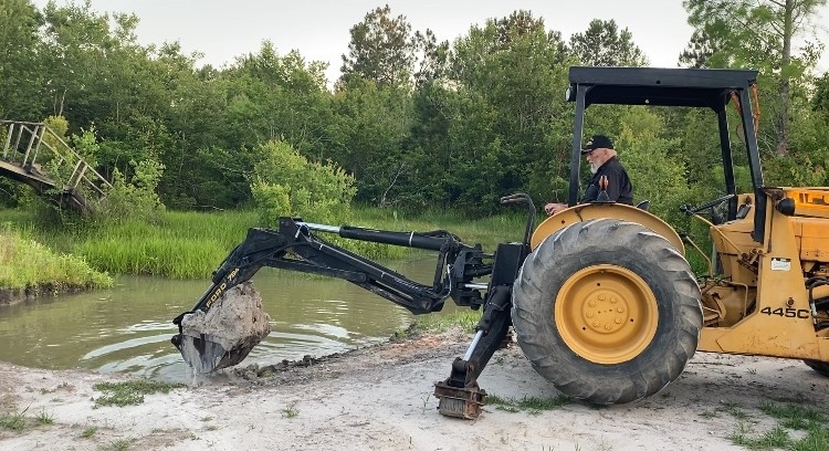

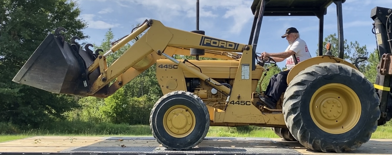

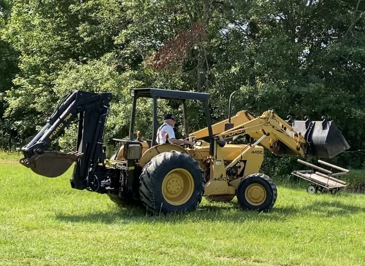

Boy, Oh Boy, the more I find out, the less I know. My tractor a New Holland Ford 445C loader 8 X 8 with a Ford 764 backhoe. BTW, I'm 90, the tractor did it's job. Anyone want to make an offer/

Wow! What a beautiful old machine that is! And in really nice shape, too. Lucky you .
Those old Fords had a common type of mechanical drive 4wd assist - the kind that you only use when you have to, and then put it back into 2wd when you are past the problem spot. There is no hydraulic pressure circulaton or filters in the front axle. It's a real strong front axle. The limitation is the type of Constant Velocity joint they have in each front wheel doesn't allow it to turn in 4wd as tightly as the bevel gear type in the more modern compact tractors.
If the only problem is in the front axle, my experience is most mechanical part time drive front axles leak a little oil after two or three decades. Mine do too - on our JD310SG 4wd that has a similar front axle. I believe there are actually three separate oil reservoirs in your front axle - one for the front axle and a wet CV out at each wheel.That's what our 310SG has & the Ford 445C looks similar. I don't believe that an ounce of Bars leak will hurt any of them.....or that it will do much good.....but it might.
If it has motor oil or trans/hydraulic in any of those front axle reservoirs then switching to a modern multi-viscosity gear lube in 75w-90 or 80w-90 will slow down a slow seep, but nothing except new seals will fix one completely. That's a lot of pain for a little gain.
If it were mine, I'd check that the levels are good, park on old gravel, and not worry about it past that.
