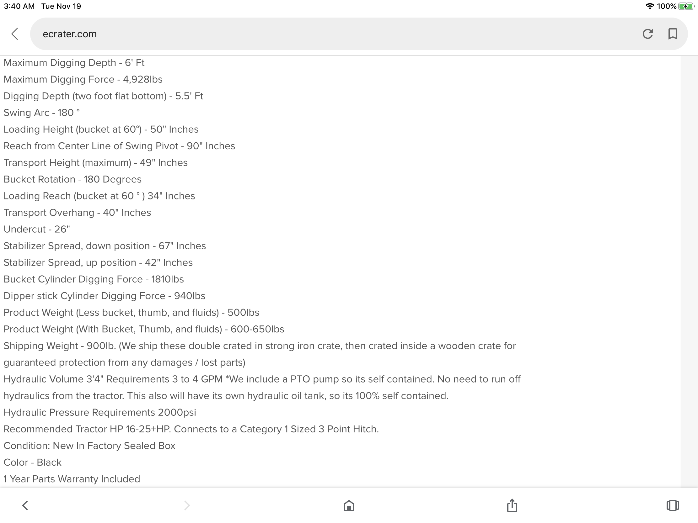

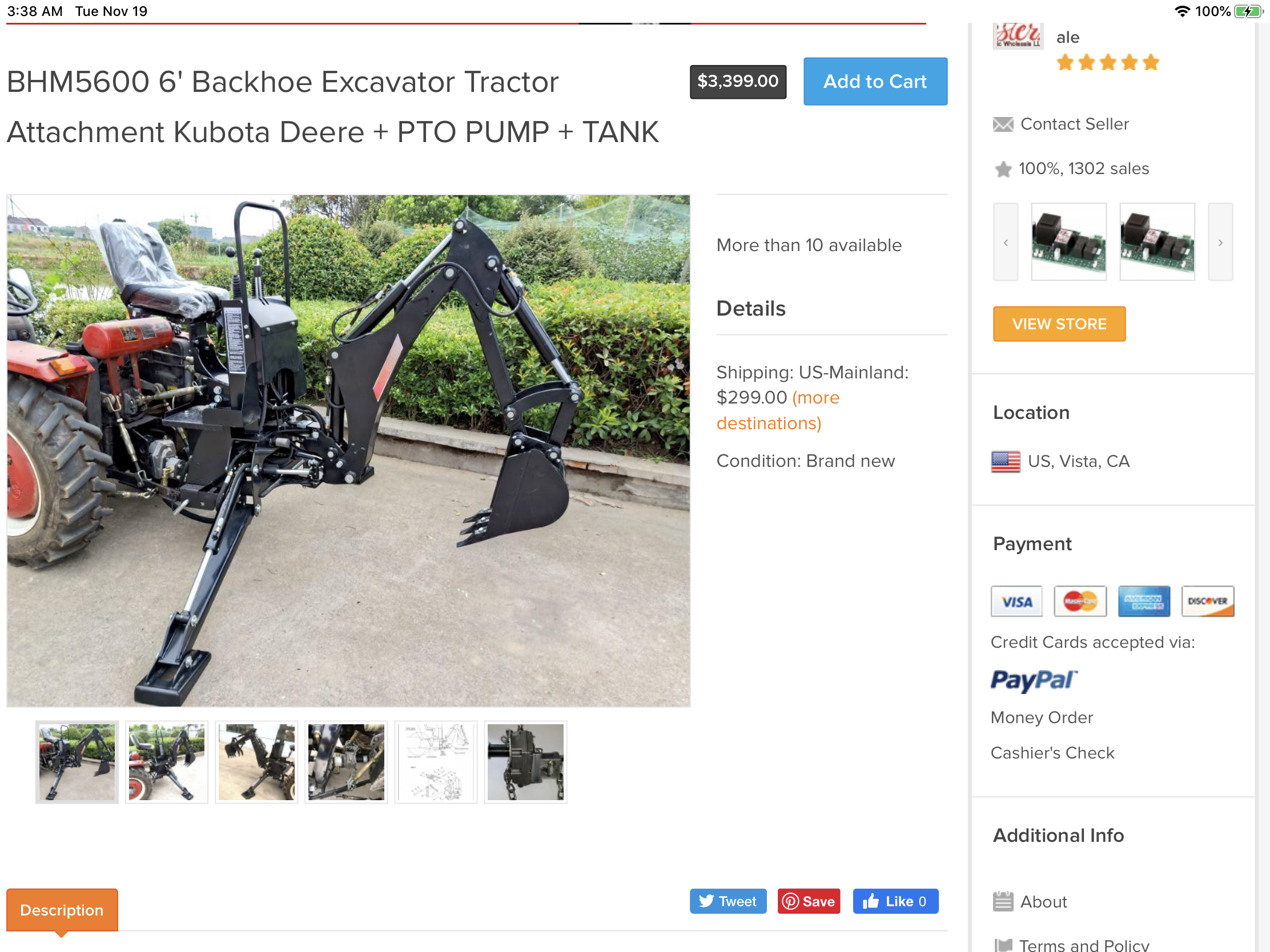

To bad this would not work on a GC1700 series scut. I really do not know why it wouldn稚 work being it is rated 16-25 hp, must be the way the GC is designed.

I'm talking outta school here coz I'm pretty new to tractors, but I see 2 concerns strapping on a 3ph hoe to a scut or cut.
1: Forces exerted to the 3 ph when working the backhoe. Well, here you got some control, just take smaller bites, don't lift to much, just be kinda ginger with the whole thing.
2: Forces exerted to the 3 ph just driving around with it back there. You got less control there, gotta make sure you drive down smooth paths, go slow, etc.
Plus your warranty is kaput going the 3ph hoe route. Overall, I'd say it's just a headache you don't need. But hey, why not just use your tractor to tow around the tow-hoe thing you were talking about getting?

I have seen one of these in person and if it was your only means to dig a few holes, it would be okay. The amount of flex/slop or just looseness in a 3PT mount would be a bad way to mount a BH. A SCUT with a factory mounted BH is a good machine for many home owners to have around. They have the additional mounting frames and were designed to carry the weight. A 3PT mounted BH would be a last resort if there were no other way to get one that is properly mounted. I haven't checked the warranty on any other manufacturers but I would not expect the warranty to be affected unless there were some other contributing factors.

No no, on the GC17xx series, it says right there, no mass warrantino if you go 3 point hoeno.

Duly noted. I had not seen that one. I stand corrected. I would say that I am surprised by that but not really. An unknowing and uncaring person could do some damage to the tractor with one of those.
I would in no way ever buy one of those anyway. Just my take but a BH needs to be designed in and mounted as an integral part of the tractor. The SCUT and CUT are almost unique in that they are designed to be removable as opposed to a fixed hoe on a larger machine.

Yeh, I think with somebody working a 3ph hoe like they're working a subframe mounted hoe, they're gonna definitely farq up their (s)cut tractor, no doubt. You gotta be way too careful there, it ain't worth the worry, and also your work with it will suffer.

I have no plans on getting that backhoe (i am waiting on a HF backhoe, looked at Jansen but just not to sure on it) I was just wondering about this 3pt hoe which seems more suited for a older tractor or a off brand tractor, I am sure it would beat the heck out of a light 3pt hitch but due to not weighing much it seems like a good option for certain tractors.

I would really evaluate my anticipated needs of one and if they were numerous enough then I would spend a few $$ more to get a used SCUT or CUT w/BH installed or even a bigger older backhoe tractor. I probably would not spend my money on one to be installed on a 3PT hitch unless it was really cheap and on a tractor that I didn't care about.
