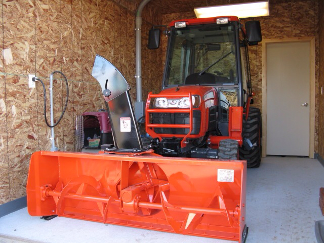

RFB: Good looking outfit, thank you for sharing.
/ SCUT with cab for front mounted snowblowing #16
Thank you, it works well.
It is Kubota OEM blower on the OEM quick hitch, it uses the FEL joystick to control raisie and lower and spout rotation. It is spec'ed at 63"
The rear glass has the defrost wiring, and the A/C operating in conjunction with the heat prevents/removes any interior fogging.
It is quite powerful; more than I would have thought.
