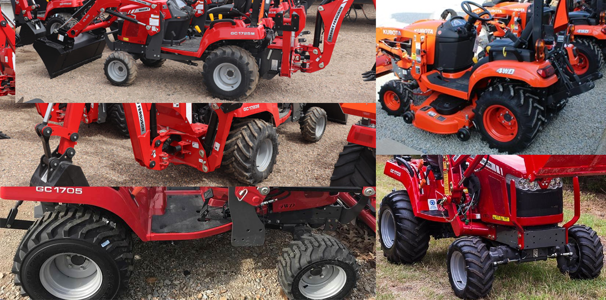

YES. another AG vs R4 tire thread.
I was comparing tires at the MF dealer recently and he had identical SCUTS with R4's and AG tires. I wish I would have looked at the brand a little more closely now.
I know people say AG for best traction, but these AG tires did not look aggressive at all compared to the R4's.
Look at this attached picture, these are just random internet pics.
Tell me what I'm seeing here, I have one at the bottom with R4's and the rest are AG tires. Are these just regular R1's?
I slapped a Kubota in there as well, and those tires are different and more aggressive.
Thanks

I remember when I was a kid looking at Kubotas and Yanmars at the county fair. Those all came with R1 rice tires. The lugs were over 2" tall. Looks like the R1's in the picture are a toned down version to be gentler on turf yards. In my book, if the lugs are straight and in a 45 degree pattern it's an R1. If the lugs are shaped like a check mark and kind of square, then they're R4's. Of course the sidewall designation will supercede my thinking.
/ SCUT with AG Tires Question #3
Yes the ag (R1) tires on SCUTS are not as aggressive as the larger ag tires. The lugs are definitely not as tall. I have had the R4 tires on both my SCUT and on my compact tractor. Never had any traction issues that 4 wheel drive did not take care of. It really depends on your terrain and what you are trying to do. On a SCUT, I do not think it would make a remarkable difference.

Center picture, left hand side. We ran those tires on our Jeeps when I lived in AK. They were Goodyear Terra Tires. Two ply - very soft - excellent for flotation. The tire was 15"wide - run on 12"W X 15"T rims. The tread would wear so fast - we trailered them to where we went off-road. At that point you would swap tires and go like mad out thru the muskeg.
/ SCUT with AG Tires Question #5
I don't have them, but I have heard of them being referred to as "Bar Turfs".

R1 tires are more aggressive then the R4ç—´ tires thatç—´ why I went with the R4s on my GC1705, less damaging to the yard but a bit more traction then the turfs. It was a toss up between R4 and Turf tires being it was mentioned that Turf tires are a bit better then the R4s in snow but again to me that is just hearsay until I try them both in snow myself plus I also bought chains.

The biggest difference is the space between the lugs. The R4s will fill with mud/dirt and become slicks, The R1s are better at self cleaning.

Do not be fooled by what the tires LOOK like. Far and away - an R-1 ag tire will be more aggressive & give better traction than an R-4. R-4 is heavy lug, designed for industrial use( back hoe or front end loader ) where tire wear is most important.

Actually those are R2 tires.
We run a few Tractors and all our combines with those. A lot of our harvest time is in the mud with our rice and such.

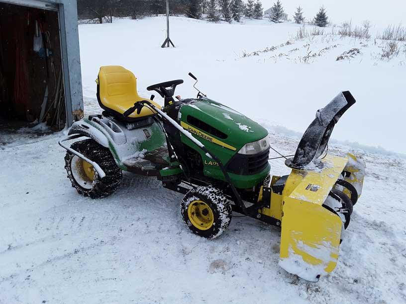

Since your interested in tires for traction on hills, this was one of the reasons that I wanted AG tires on my tractor. I only have 1.5 acres and it is all hill with the exception of where the house is sitting and about 15 feet behind the house that needed to be leveled (cut out of the hill) to put the house in and an area at the back of the property that hired a guy with a bulldozer to cut out of the hill and level off in order to put in my solar panel array. From the road to the back of the property the average angle is 15 degrees (not 15%). There are places that are less, not many, but there are places that are more, some approaching 45 degrees. I mow on slopes that would make some people pee themselves and I've been doing this for 20+ years. My driveway is also pretty steep.
Below are some images I have that can give some idea of the slopes on my property. The JD tractor is what I used to use. The JD had filled tires because without being filled it could not make it up the hill without spinning the turf tires and even with it filled tires and ladder style chains it would spin all the way up the driveway in winter.
I don't know how steep your hills are, but if they are anything like mine I would recommend AG tires. Or I would say to go with something like Versa Turf R14s discussed in the other thread.
