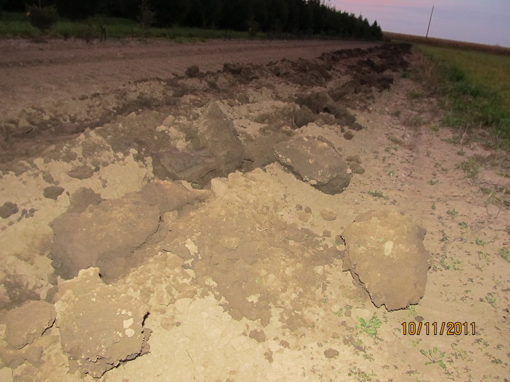

Just thought I would toss this in about the current thinking on agricultural purpose ripping/subsoiling. The point of ripping is to shatter the hardpan created by traffic from equipment, etc. A few years back, the thinking was to rip really deep to get the job done and 24" to 30" was typical. That's all changed.
It is now believed that ripping only to the depth of the "plow pan" ,where packing occurs is all that is necessary or desirable. Further, going deeper only tends to invert the soil structure and does more harm than good because it brings up marginal quality soil. Around the clay ground here, where compaction is an issue, you never hear of anyone going more than 12" to 14".
Let me add that ripping is best done in the dry part of fall so the soil can be fractured better and compaction broken up. It doesn't work so well in the wetter times of the year.
