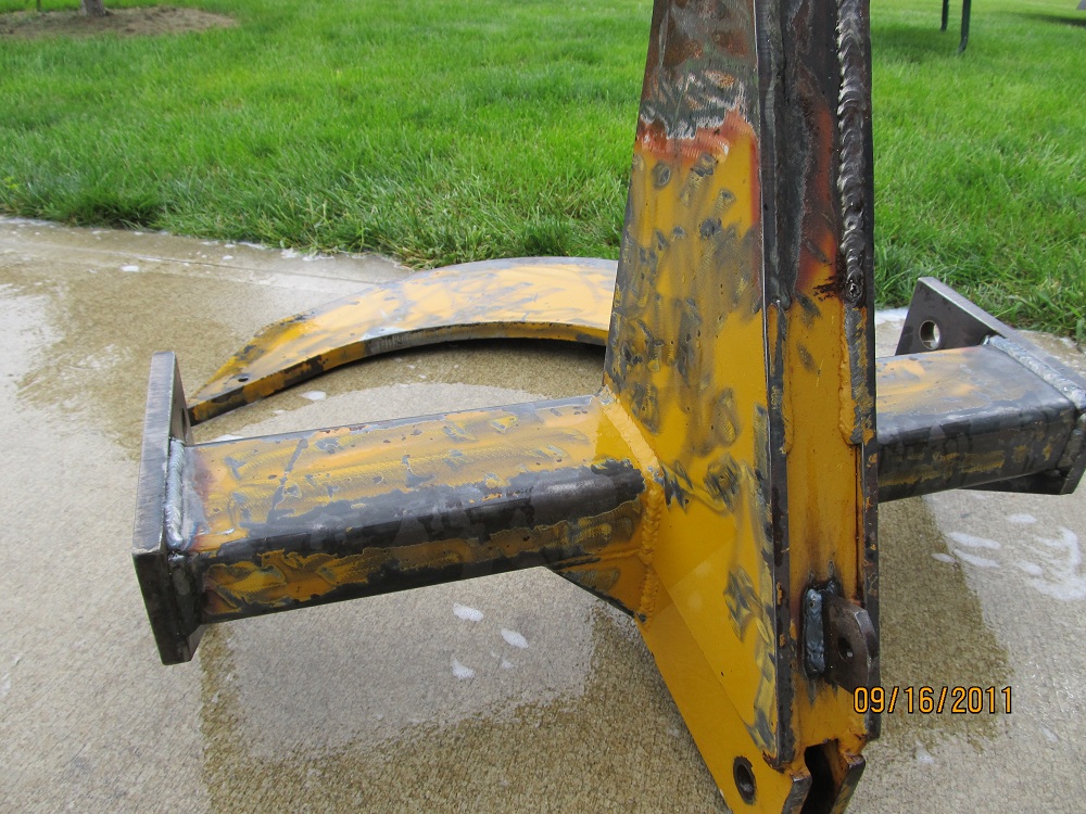

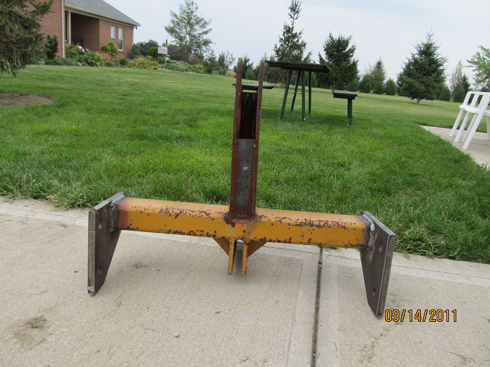

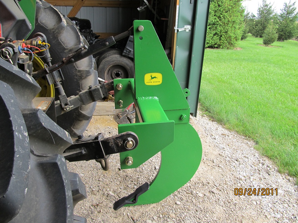

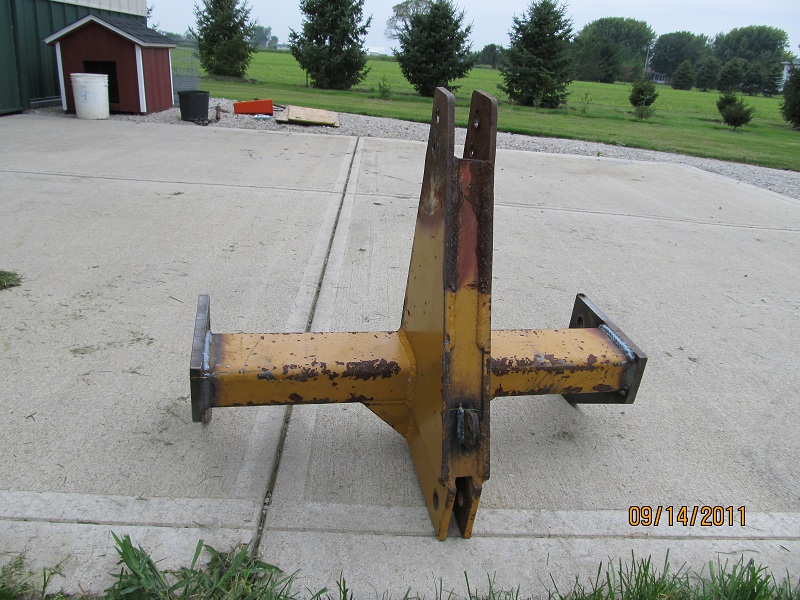

Found this one shank subsoiler "ripper" recently and thought you guys would like to see it and my plans. These are great in clay soil to fracture the plow pan and allow better drainage. This one weighs 230 lbs but had been twisted by a guy that changed the grade 2 shearbolt for a grade 8 and hooked it to 150HP. Anyway, a welding shop fixed it and I found it. It's good for maybe 100 HP and down.

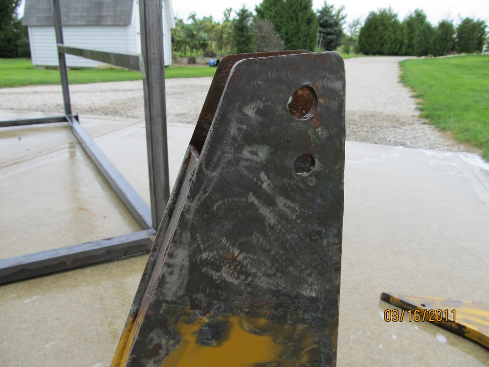

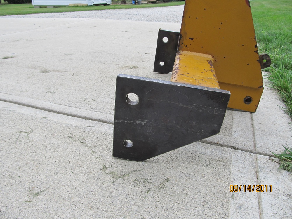

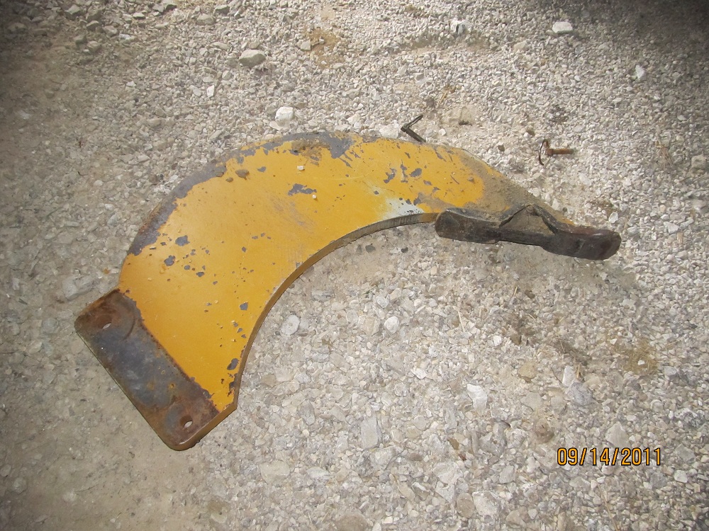

The photos show it in two pieces since it's so awkward to handle and I needed more welding done. You need a little vision. I had the side plates cut off and new 1/2" plate ones added that also give a cat I hookup 5 inches below the cat II. You can see the new plates in the photo. In a separate photo is the ripping shank that is maybe 28" long and is really heavy. You can also see a little stub eye I welded on the back to put a parking stand on. This is one awkward piece of equipment of unknown but quality origin.
Anyway, my plan is to use on my bigger JD5520 (75HP) around the house plus also hook it to my Kubota L4300 for local gardens. I'll go 14" deep.
As well, I'm going to clean it up and paint it JD green and put a Deere decal on it. Laugh, and I'm not selling, but green paint brings way more resale $$ around here.
I'll post more photos as work progresses.

bullbreaker---good catch in post above. It does look like an early version of a Worksaver model. It is painted that "puke yellow" color but these things are so desirable I can get away with a quality Deere green paint job with decals.
Baby Grand---Clearance on the L4300 is why I had that step-down plate welded to the sides. It "raises" the implement on a small tractor sufficient to clear the ground--and clear loading on my trailer. That's the theory at this point so I will update. And yes, it was twisted pretty good. He was using it to pull stumps and replaced the grade 2 shear bolt with grade 8 because it kept shearing. OK, sure...
SandburRanch--Yes, indeed they are "Utility Line Locators" and if anyone else is reading this with similar plans don't go deep unless you are certain what is below. Phone wires especially but old timers often ran electrical stuff too shallow 'twix the house and barn.

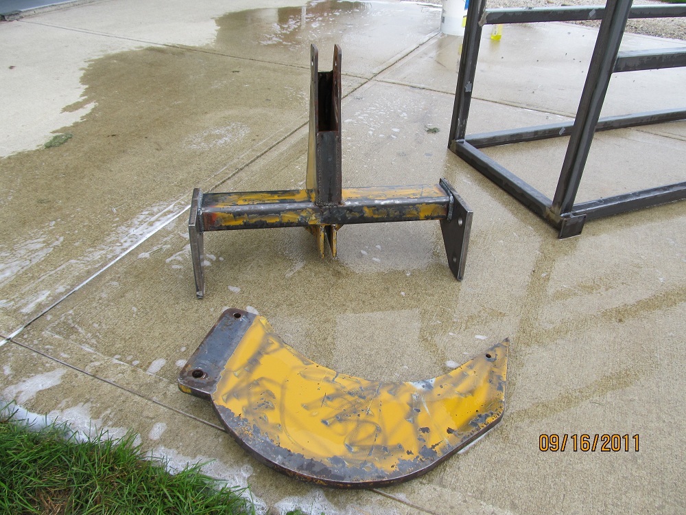

Got the wire wheel out and ground the loose paint and stuff the best I could.
Then I washed it it with a scrub brush and detergent. Here's a couple photos of it after the wire brush and cleaning.
The thing in the background is a metal table that needed paint.

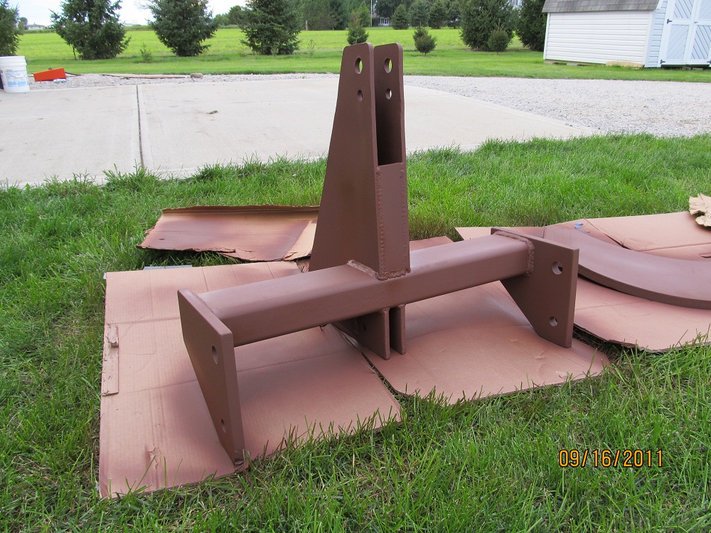

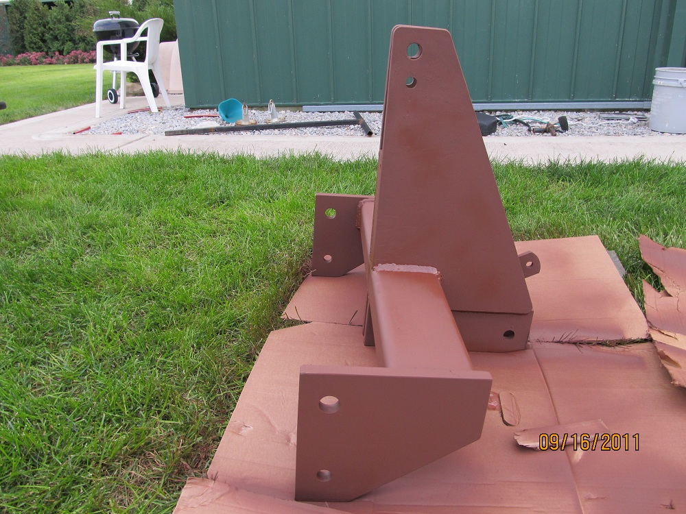

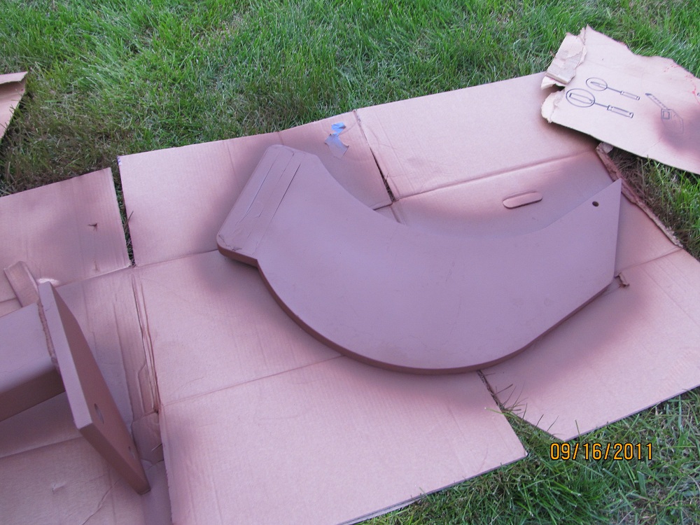

Then I primed with Rustoleum rusty metal prime srince I have had great results with it. I also picked up a can of Deere acrylic enamel green but that's a couple days off. Here's the primed parts.

What's the tab for that's hanging out the rear with the hole it it? That's a stout piece!
/ Scored a one shank ripper-subsoiler #11
I believe its for a stand to store or for easier way to attach to 3 pt.
Boone
#12
It's for a stand to hold the thing up. It's so heavy and awkward I needed a better plan to hook it up. The idea is from a photo of a similar item I saw--see attached photo--ignore the circle--it was for the welding shop to make new end pieces. And it is stout--I'm upping my guess to 250 lbs.

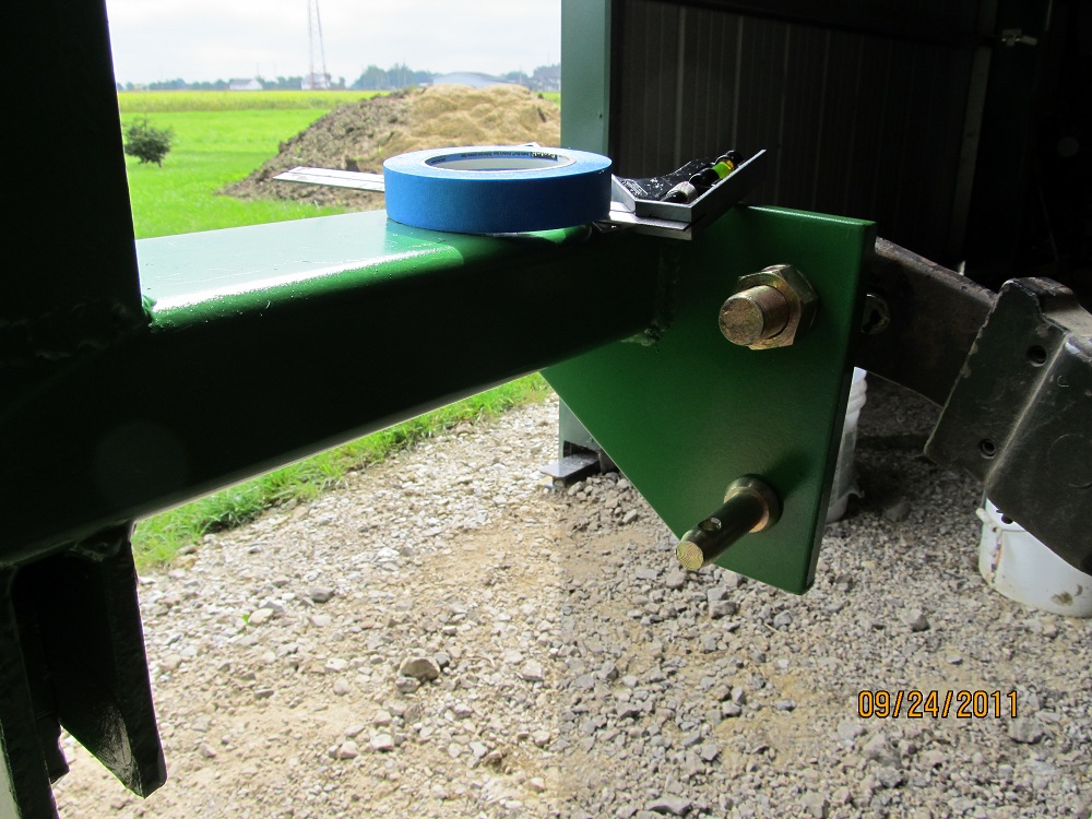

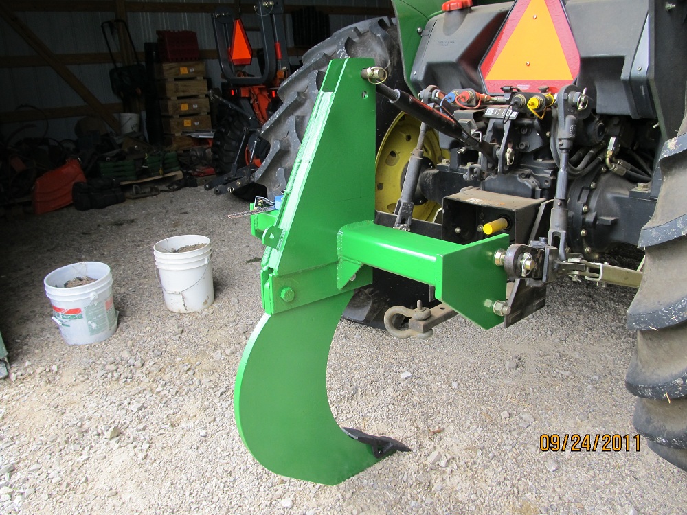

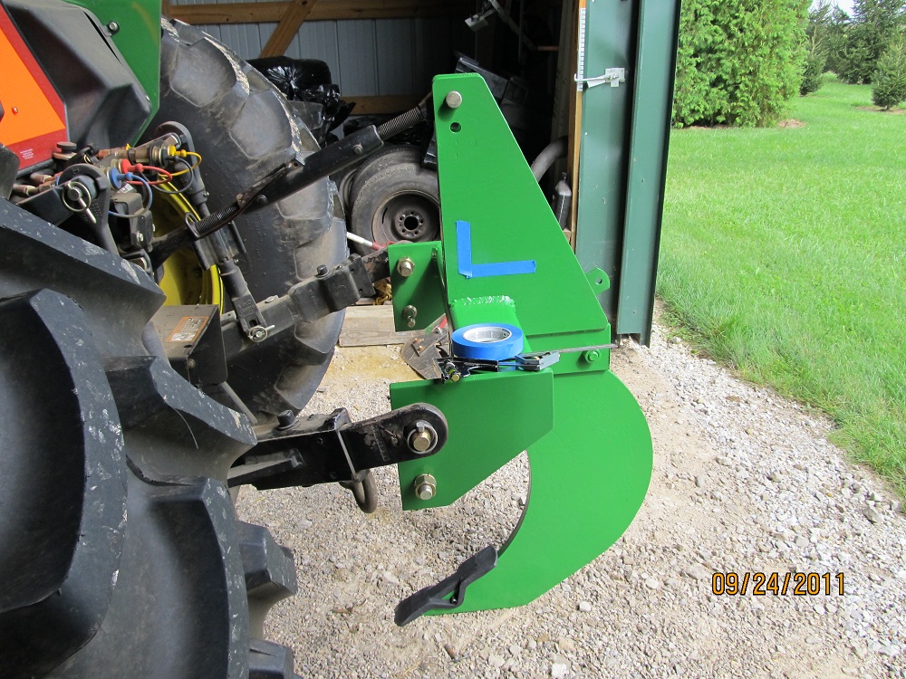

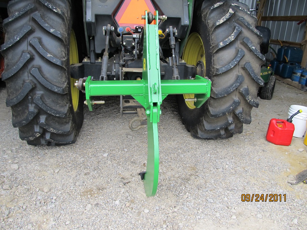

All done.
Picked up a quart of real John Deere acrylic enamel from the dealer, painted it in two pieces, and assembled it. A little grease on the shank at the top.
Here's a photo of it assembled and painted. Also is a photo of my setup for the decal and then the finished product.
You can also see the side plates I had made with the dual Cat I and II pins in place. This way I can use it for my Deere 5520 as well as use the lower pins (for ground clearance) for my Kubota L4300 so I can load on my trailer for doing gardens. Not sure if the L4300 will work but I only need to go 12 or so inches deep so it should. The little tab on the back is for the parking stand.
