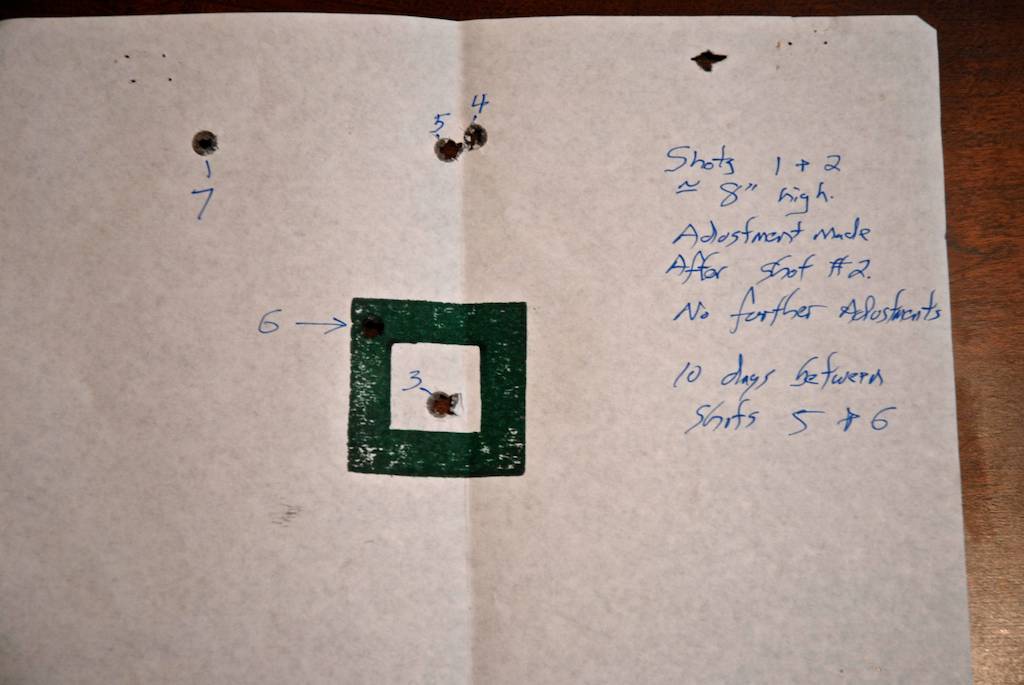

Here is some follow-up. Below is the target from about two weeks ago. Shots 6 and 7 were made yesterday.
Summary:
Gun completely pulled apart (stock, rings, bases), cleaned, bore cleaner, etc etc. Put in new stock, bases and rings snugged down with loctite. Adequate cooling time between all of the shots shown.
*First two shots 8-9" high and centered. (not shown)
*Scope adjusted.
*Shot 3, perfect.
*Shots 4 and 5 and I quit in frustration.
*About 10 days go by and I shoot at same target.
*Shot 6 is close enough to make me happy at 100 yards.
*Only cools down about 2-4 minutes but barrel cool to touch
*Shot 7 and I quit. Probably for good.
Could it be a hot barrel thing? I guess, and even with cool down times this seems the most likely answer. Something loose seems less likely since shots 3 and 5 which were with a stone cold barrel hit pretty close and the same pattern occurred with different stocks and scopes.
So at best, this gun is a one shot wonder and probably adequate for 100' or less deer hunting.
End point: gun goes in the closet for the foreseeable future.

Check the crown and see if it's damaged.
Find out what the rate of twist is and post it with the barrel length.
Next time you punch some paper and post, include information regarding bullet weight and type.
Current model Seven rifles chambered in .308, are manufactured with a twist rate of 1 in 10. If this is the case in your r****, the gun will stabilize heavier/longer bullets better than lighter/shorter ones.
Examine the spent cases from the suspect r**** closely for imperfections around the neck.
Is the bolt ever difficult to close when loading the chamber?
Do you have any idea how many rounds have been through this gun?
Is the bore perfect when examined with a bore light....carefully?
Do you know if the barrel was ever removed from the receiver?
You said you had the original wood stock but you didn't say or I missed if you put it back on the gun. as the other robert stated, it could be the new stock giving you problems.
I don't know what the crown is.
Will check on barrel length. Do you measure from the end of the receiver? It is very short. Shorter than my newer Model 7 in 7mm-08. Does not appear to have been cut. The 7mm-08 barrel looks a little beefier too. Not sure how to find out rate of twist.
I thought I had posted that but it is a very long thread now and I may not have. Remington Core-Lokt 150g. (I know, I know, everyone will blame it on the cheap ammo but I shoot this stuff in several guns and get perfectly acceptable 100' groups in other guns including the 7mm-08. Never has a problem dropping a deer with it.)
Good to know. Maybe when i'm experimenting with the Husqvarna I try some longer bullets. Really don't want to get in to hand loading and all that voodoo.....but I'm starting to get the itch just a tiny little bit.
Don't see any problems there.
No, its about as smooth as a Remington action can get. No feeding, extraction or ejection problems.
No, purchased used by my Dad many years ago. Probably more dents and dings than you'd expect but bottom plate and trigger guard on these guns is cheap painted aluminum (or pot metal) and are pretty worn looking.
Yes,after I ran bore cleaner, patches, brush and patches again I looked it over real well. To my untrained eye it looked fine. Lands and grooves look nice and sharp.
No way of knowing since it was used. No obvious signs of it other than a scraped area out towards the muzzle but that looks more like wear and tear....not a duffus with a monkey wrench.
Problems discovered when it was in the fiberglass stock, which was made by Remington. I put it back in the wood stock which I think, but can't confirm is the original but the grouping pattern did not change appreciably with changing the stock. The wood stock is not glass bedded but seems to free float beyond the action.
Thanks for thinking this through. It could be that different ammo will change things and since I'm kind of getting into this I may get some different stuff for the Husqvarna and run it through the 7. I hate shooting in the summer heat so now is probably the time to do more anyway.
