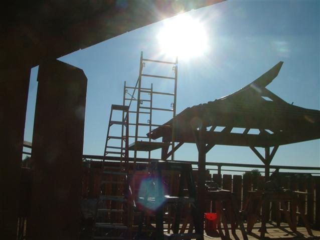

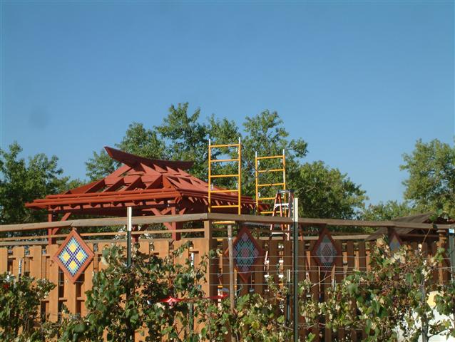

Has anyone made a scissor type man lift? I was thinking about trying and using one of my Cushman trucksters as the frame. They have Hydraulics so that's not an issue but am conserned about stability. Wheel bases are about 3.5-4 ft wide x 4ft long. I'd be look at going 20-24ft high. I'd be using it to assist in installing a pole barn. Around were I live (low Alabama) the lifts go from $100-250/day. Even if it cost me $600+ to make it would be worth it.
Don't waste your time trying to jury rig a DIY manlift--the injury risks are too great. Get some good scaffolding.
Scaffold Mart has good stuff and good prices and free shipping on orders over $600.
Scaffold Mart. Scaffolding at the Best Possible Prices
Here the scaffolding I got from SM to build a Japanese pergola last year.
Bakers Type Scaffold Ladder, Scaffold Frame - from ScaffoldMart
I only had to go up 10 ft. I'd use one of their other packages to handle your height requirement.
http://www.scaffoldmart.com/scaffold-tower-packages/26-scaffolding-tower.html
If I were you, I'd stretch my budget a little, get the scaffolding and be safe!!!!
