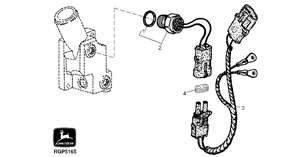

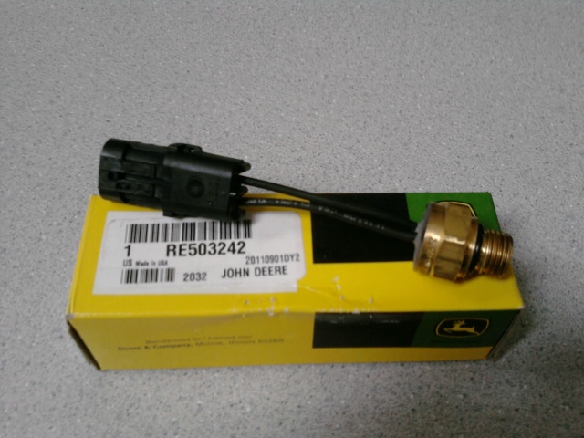

Part # RE503242, the thermistor is located on the thermostat housing and connected to a two wire harness that goes to the injection pump and not the fuel shut-off solenoid. More information on the cold start advance can be found in manual that goes along with the engine. If your engine model is PE3029DLV52, the John Deere manual is CTM125.
The actual cold start advance is located in the injection pump (there are 2 models of injection pumps for the 3029 engine). I have attached a page from the manual that shows the connection and more information on how things look inside the pump.

I have CTM125 and the page was posted from it. There is no schematic/wiring diagram in the manual that shows how the thermistor gets power.
The thermistor also called a thermo-switch does need voltage to operate. I have not read this, but have concluded that the cold advance gets power some how from the wire that runs to the fuel shut-off. Since no other wires are on the injection pump (other than a ground wire), plus when the thermistor shorts out it blows the fuse for the fuel shut-off. So looking at this way your picture is correct.
Yes the fuel shut-off solenoid is in the injection pump.
