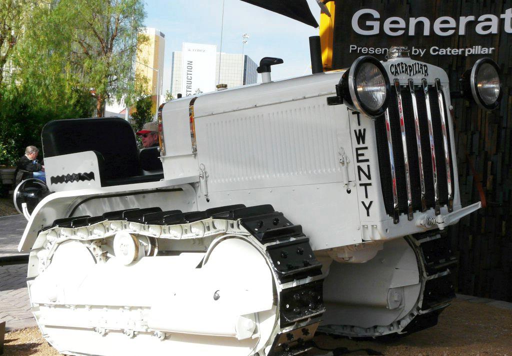

It's tough some times. I just don't sleep very much. Having a plan drawn up in CAD has helped more than anything else.
In an effort to save some time, I made a visit to the waterjet table.
I finished drilled all the holes though.
Then I started putting some things together.
Been turning a lot of pieces on the lathe as well. I've been making some decent progress just haven't been taking a lot of pictures. After I got it running, I feel that going back to posting pictures of pieces of steel is a little boring.
My brother in law is working on rolling my plow and cutting out a few more pieces. I also need to get moving on my hydraulic parts order.
Also, now that the end is getting somewhat near, I need to start thinking about paint. The real dozers have metal tracks and the whole thing is painted yellow. Being that I have black rubber tracks I wasn't sure how it's going to look.
I've done a couple of different colors schemes. I'm between #2 and #3.
I did a grey one like the Model Twenty I saw at the Caterpillar visitor center. (And a darker grey just for the **** of it). Just to see what it would look like.
