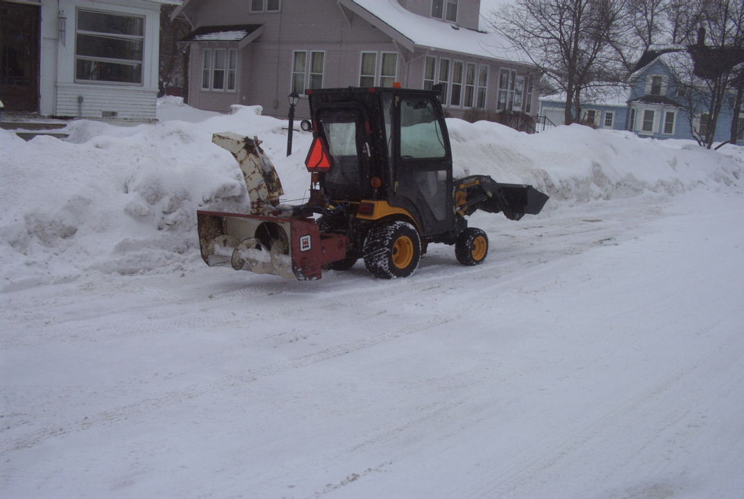

But **** is this thing a snow machine now

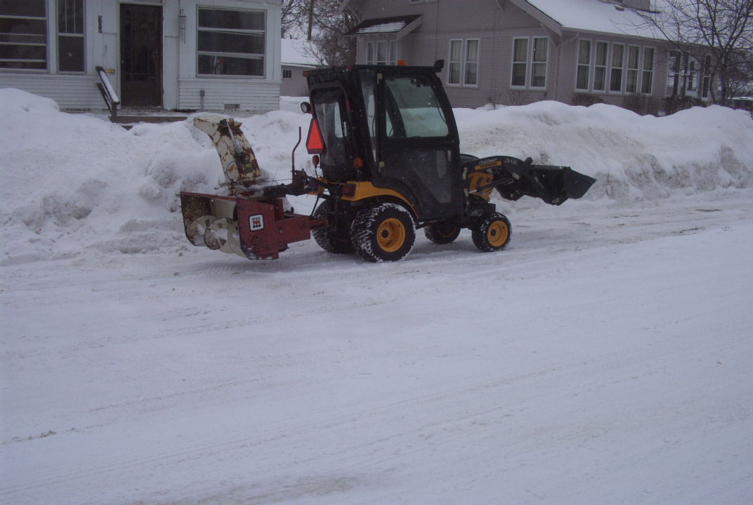

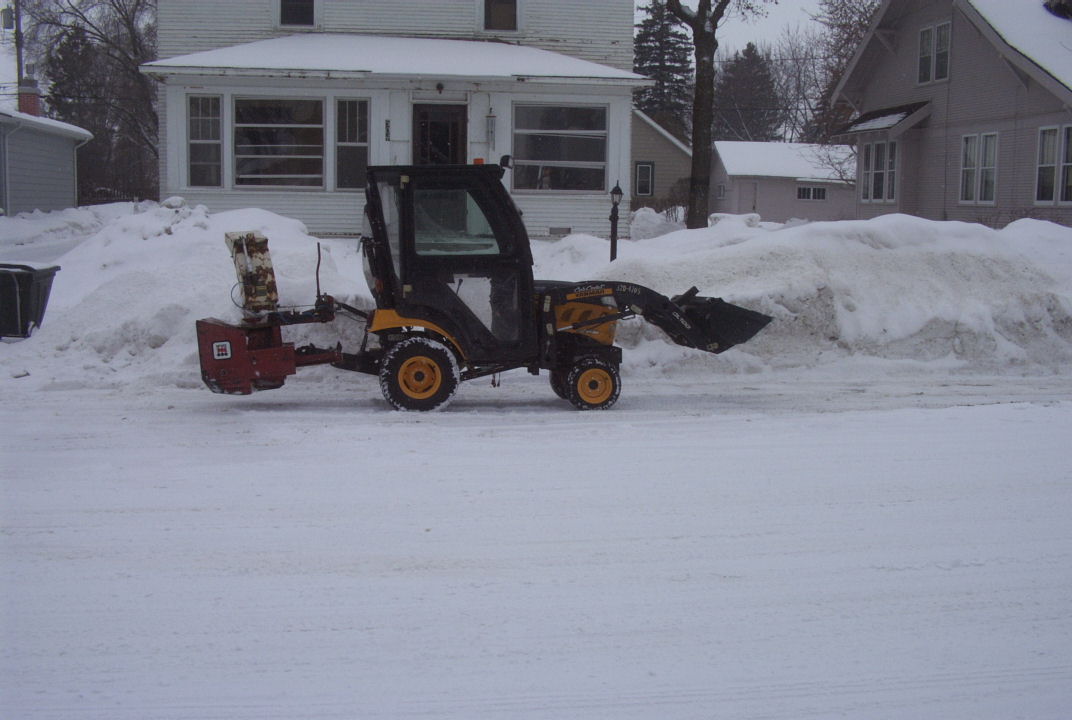

/ sc2400 SB45 BLower problems #24
here are a couple pics of it
talk about your urban snow unit
can you use that thing in reverse without having to hold the reverse safety button in, i think some won't let you reverse with the pto running without cutting the pto off, or is that for the mid pto?
