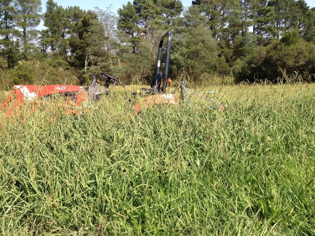

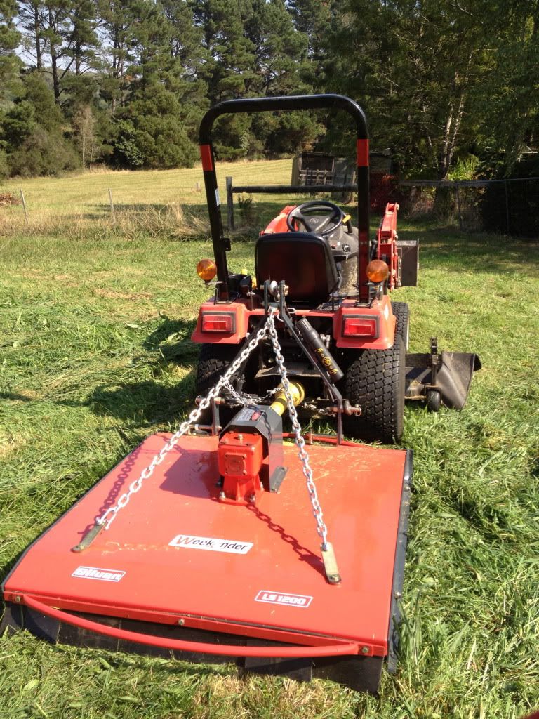

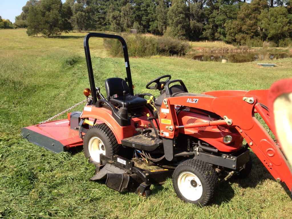

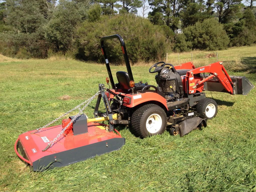

Finally got my "slasher" (rotary cutter) and used it for the first time.
Ended up going with a 4' model.
Am very happy with how well it cuts. No bogging down of the motor at all although the grass wasn't super long.
3 point hitch has no trouble lifting the slasher's weight and the position control is great!
Here are a few before and after photos.
MARK

Nice setup and nice job mowing!

Thanks Scoutcub.
Only issue I had with the 2400, which I had never really thought about before, was when I bush hogged an area which hadn't been touched in a year, the tyres slipped right into some ruts. If I had a tractor with larger tyres I wouldn't have even noticed it. But that would be a problem with any Sub-Compact Tractor due to their small tyre size.
Mark
