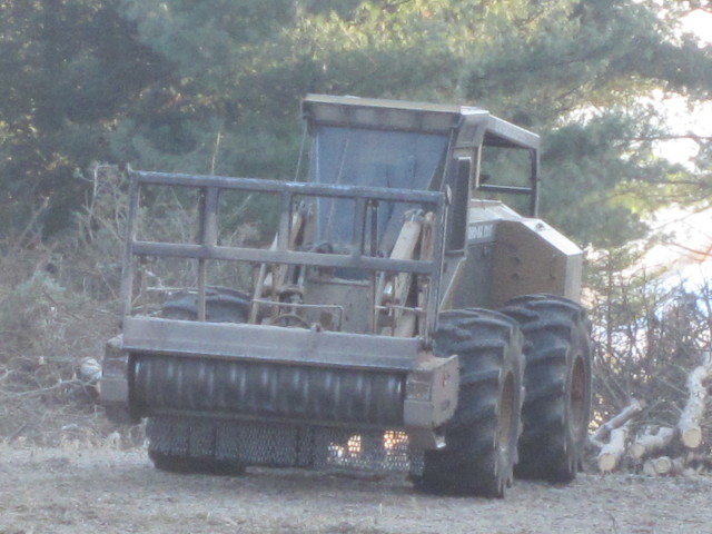

Sometimes bigger is cheaper in the long run, like this Hydro-ax

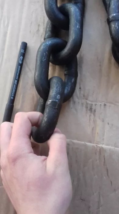

The small chain we use is 3/4" high strength chain.
To clarify - here chain size measures the diameter of the metal in the link (the "wire" size), not the distance across of or the length of the link; each 3/4" chain link would be about 4" (10cm) long.
Does your cutter use that, or something more like a 9mm (wire size) chain?

The chains hold fine and are not too expensive to replace. With time and work, the last link of the chain ( the one that gets the most abuse) will get thinner and actually sharper over time. I need to take a picture of mine, next time I take the mower out again. It is getting a shape of a blade lol.
It's also not that expensive to replace. For instance, my 50" mower, takes two pieces of chain about a little over a foot each.
Yes, I know that but that's a good point to clarify. It's actually the diameter of the "wire" as you called it. So it's a big a chain. The length of the chain link I don't really know but looking at specs, they mentioned a bit over 2". Doesn't seem to be anywhere near 4" though. It's been a year since I've use mower. I will only start my mowing/land clearing "season" in a month or so.
It's grade 80 chain by the way.
Here a link from a US supplier I've found. It's easier for you to get an idea.
KWB Chain By The Foot - 3/4" Grade 8
And picture:

Thanks for clarifying; I couldn't get a good notion of the chain size from the pic where it's attached to the mower - lacked perspective.
