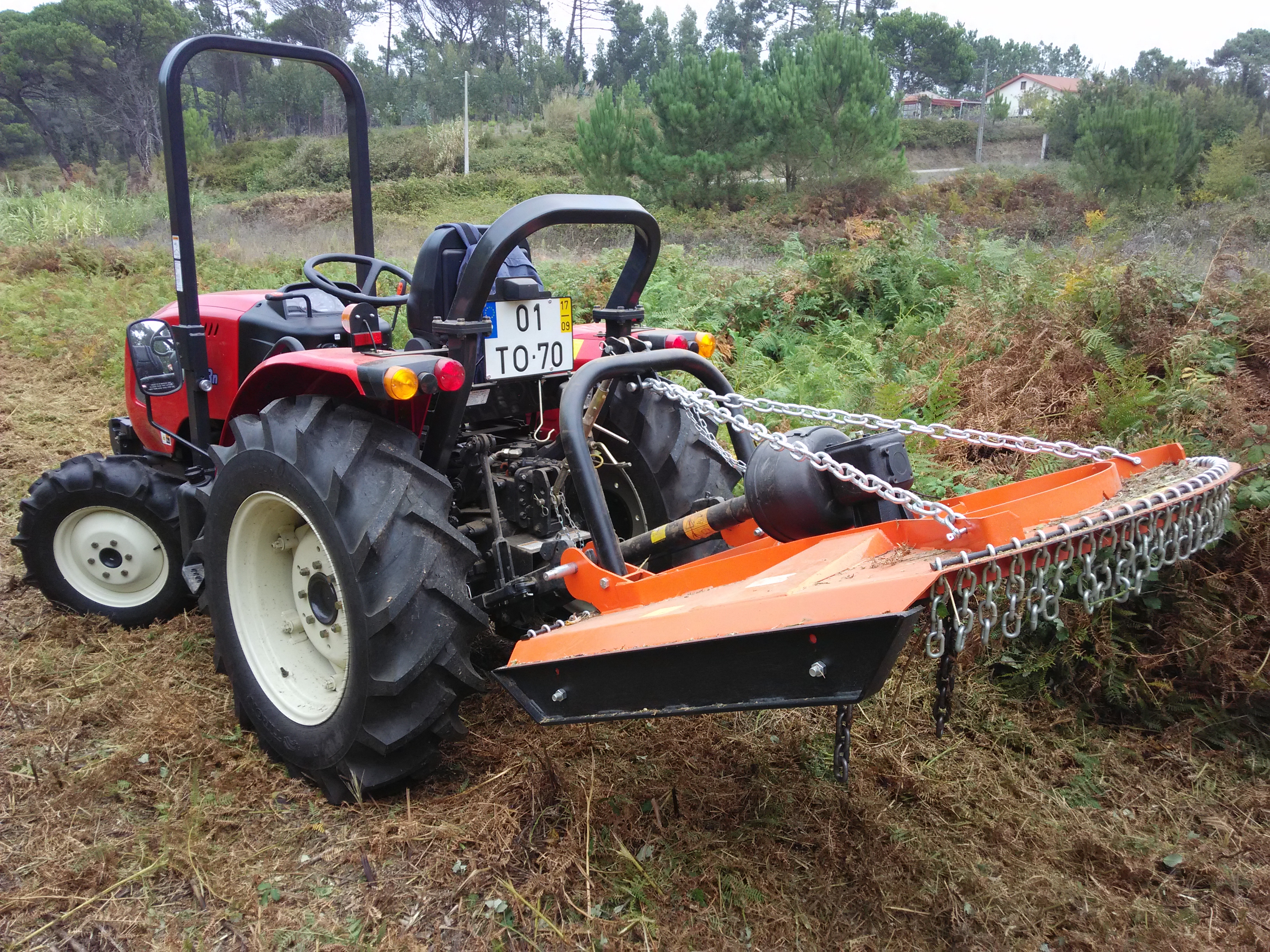

It doesn't seem like chains would work for the 2" saplings I hog.
It handles it with absolutely no problem. I've cut 3" stuff easily, some times even 4" going a bit slower.
We do mow a lot slower because most of the time we are just backing up against brush higher than the tractor. Sometimes there are some hidden surprises there like open old water wells anywhere from 6 ft to 15ft wide.
Here is a video. Not mine and it's a bigger JD though but doesn't matter anyway.

Chain guards are a must on mower IMO. We only have mowers with chains guards here. We also use chains instead of blades for the cutting, that will throw big things, really far away. A band guard wouldn't last 3 hours.
It won't get all bent up when reversing over hidden stumps, rocks and etc.
It allow for a better spreading of the mowed stuff.
PLUS 1

I'm not trying to be argumentative, but the video makes that hogging look labored. As a matter of physics, there is no way that chains could be as effective on large diameter material as 3" or 4" long, 1/2" thick, swinging blades on a rotary cutter. For instance, my cutter is 3" x 1/2" in cross section and have much much more weight and inertia behind them, and when I back into a swath of 2" to 2.5" pine sapplings that are 8' tall, my hog makes them disappear in seconds. Now I agree that chains would be handy when dealing with foreign objects and unknown materials on unknown land, but there is no way that they could be as quick and efficient as rotary blades.
I should make a video to demonstrate what I'm talking about. Unfortunately I've had a tractor mis-hap, and it might be a little while.

This is the second cutter I have seen on line using chains rather than blades. Sure not the same person. No doubt heavy chain rotating a high speed would do a lot of damage to small trees and while we don't have much of a rock issue here would be safer. The chains would have to be on the short order of they would drag unless rotating rather fast and if not short enough they could not touch each other they would have to get tangled upon start up.

I understand your reservations. I had it myself before I tried it.
When I had the smaller Kubota B7000, I built the mower for it and at the time I just made my own blades, which worked just fine. Then I upgraded to this bigger tractor and bought a mower for it, that come with the chains, like 95% of mowers here. The difference on the ability to mow bigger and thicker stuff was just night and day for the type of brush with deal with.
I don't claim that the chains are more effective than the blades. Most likely it isn't, since you need more HP, although it pulverizes and spreads the mowed stuff better. But chains is what works better here, with our type of brush, terrain and all that stuff. Blades is probably what fits better the US stuff.
This is the cheapest option for land clearing, then we have the bigger flail mowers, but that is an entire new game with all the options for blades, hammers and so on.
