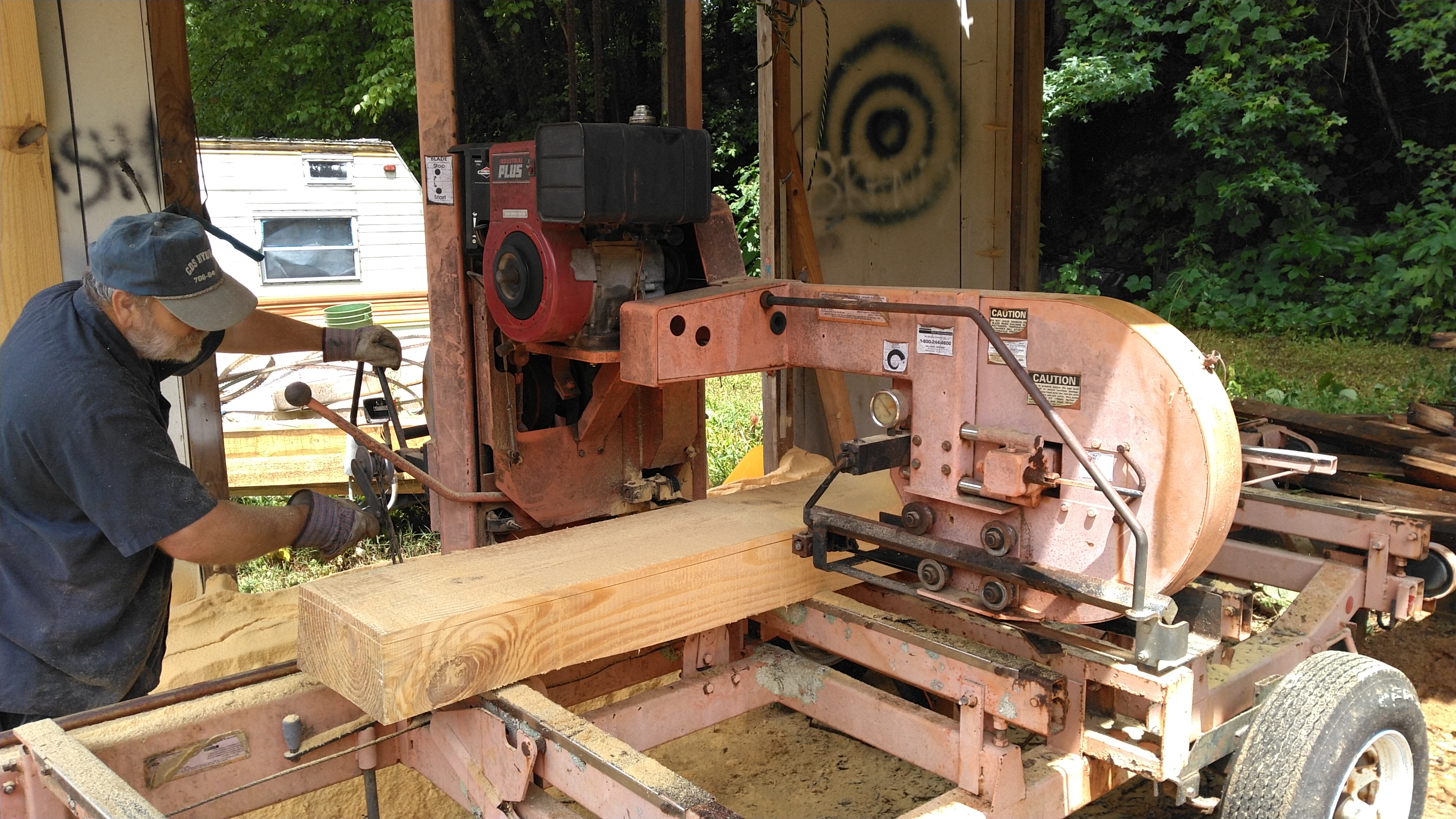

Or even one fellow by himself !
30' beam on a 21' mill:

I like bandsaw mills, no kickback and fairly safe, a friend of mine says 'if it has big teeth it eats meat and that includes circular saws', those big round blades frighten me but the sawmills still use them.
/ Sawmillin' #5
Low horsepower, easy set up, mobile (many of them), low kerf loss, accurate sawing, fairly cheap entry...perfect machine for a small homestead.....what's NOT to love ?
