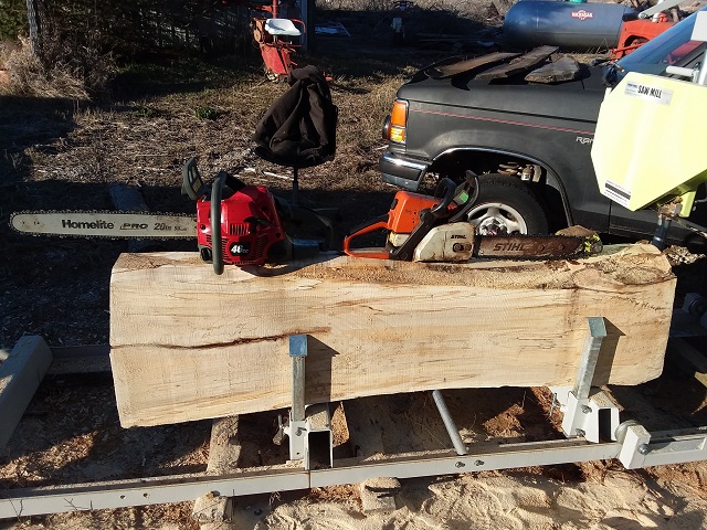

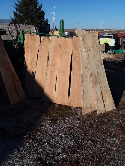

Got started on the log pile today,--got a few pix. I have only small logs but it's for my personal use.
I cut slow due to 4 spinal surgeries, but I can't give up!--Besides I like logging and making boards, when I'm not in the garden! thanks; sonny580

Nuttin' more satisfying than makin' dust fly and getting interesting lumber!--I saw a few logs just to see the grain inside.--some is odd and finishes up super! thanks; sonny580

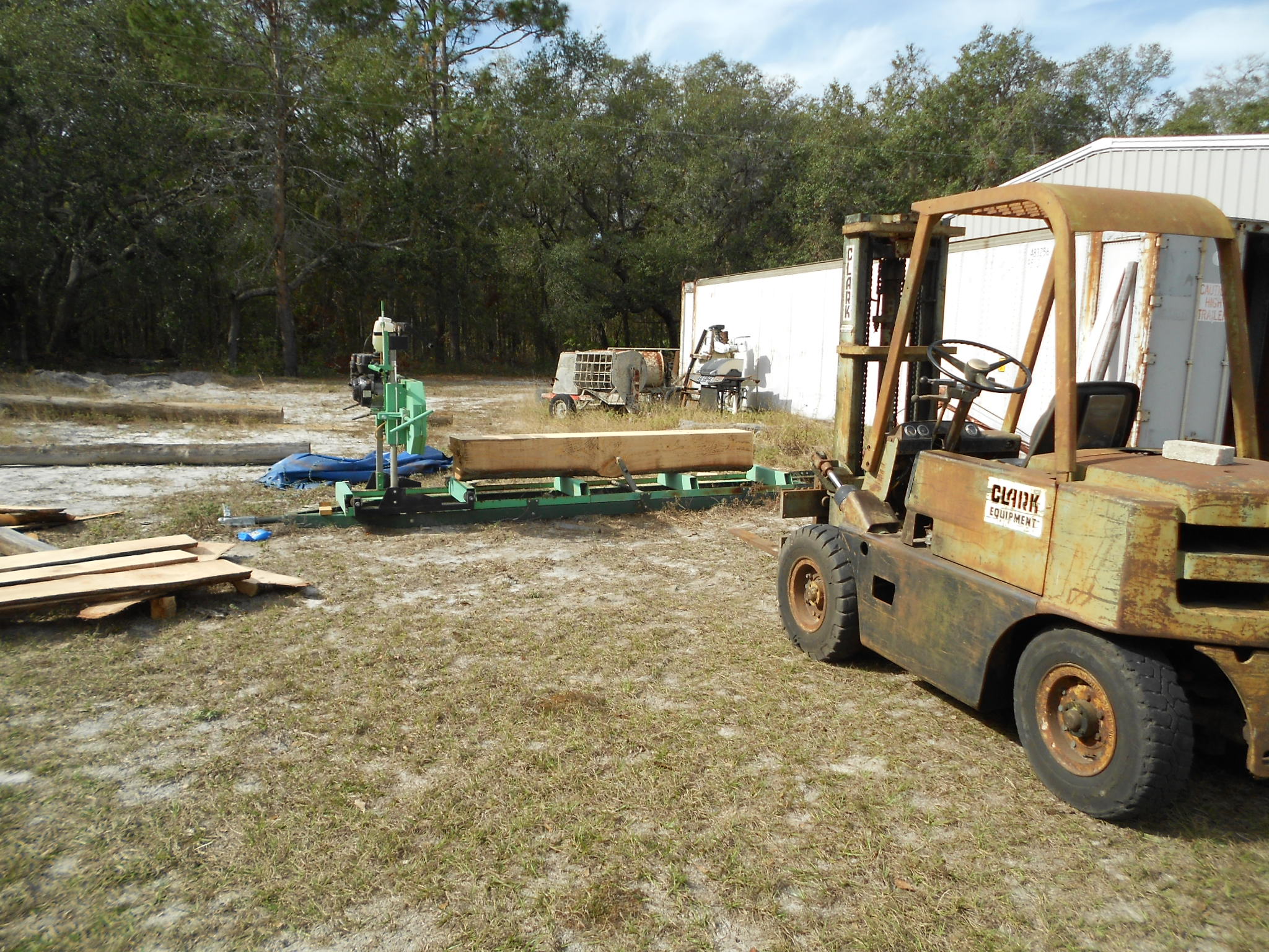

I saw a little from time to time also for projects around the farm. Here sawing a 30' beam on a 20' Woodmizer. :D

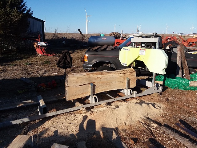

Steve, the boards in the pic. are cherry and maple. You guys have some expensive mills!! NICE!!!--- mine is a little Timber Tuff mill. It does fine for my logs, and if I run into bigger log, I just skin it down with the 36" Granberg chain saw mill until it fits the band saw.
I do have a bit of walnut,and hackberry to cut.--Also want to do a big straight hedge tree that we have at the farm.--hedge finishes up to a golden orange as it ages! thanks; sonny580

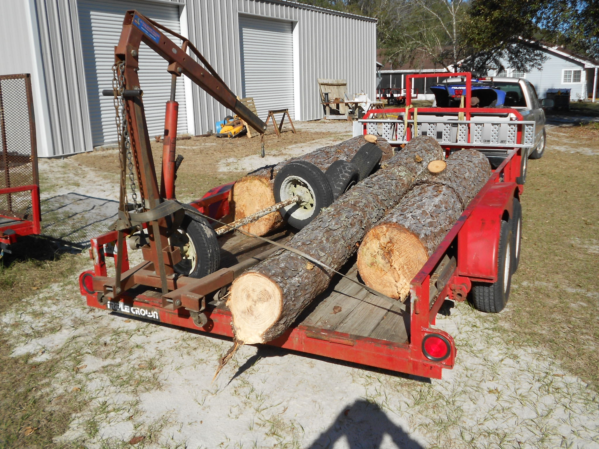

Man, what a pretty log....very little taper and dang near straight as an arrow.....amazing for a 20' cherry log here. What use will you put 20' cherry lumber to Rob ? I usually cut my cabinet/furniture stuff into 8-12' lengths, and just saw framing material in longer lengths.
/ sawmill time #13
Yeaaa, I got a pretty good tally out of THAT log,
and much of it was clear,
One of the reasons I cut the log out so long is, I had planned to use it in a room that is 18' long and the trim would be full length... AND I could always cut some of it down shorter to build the cabinets out of...
SR
