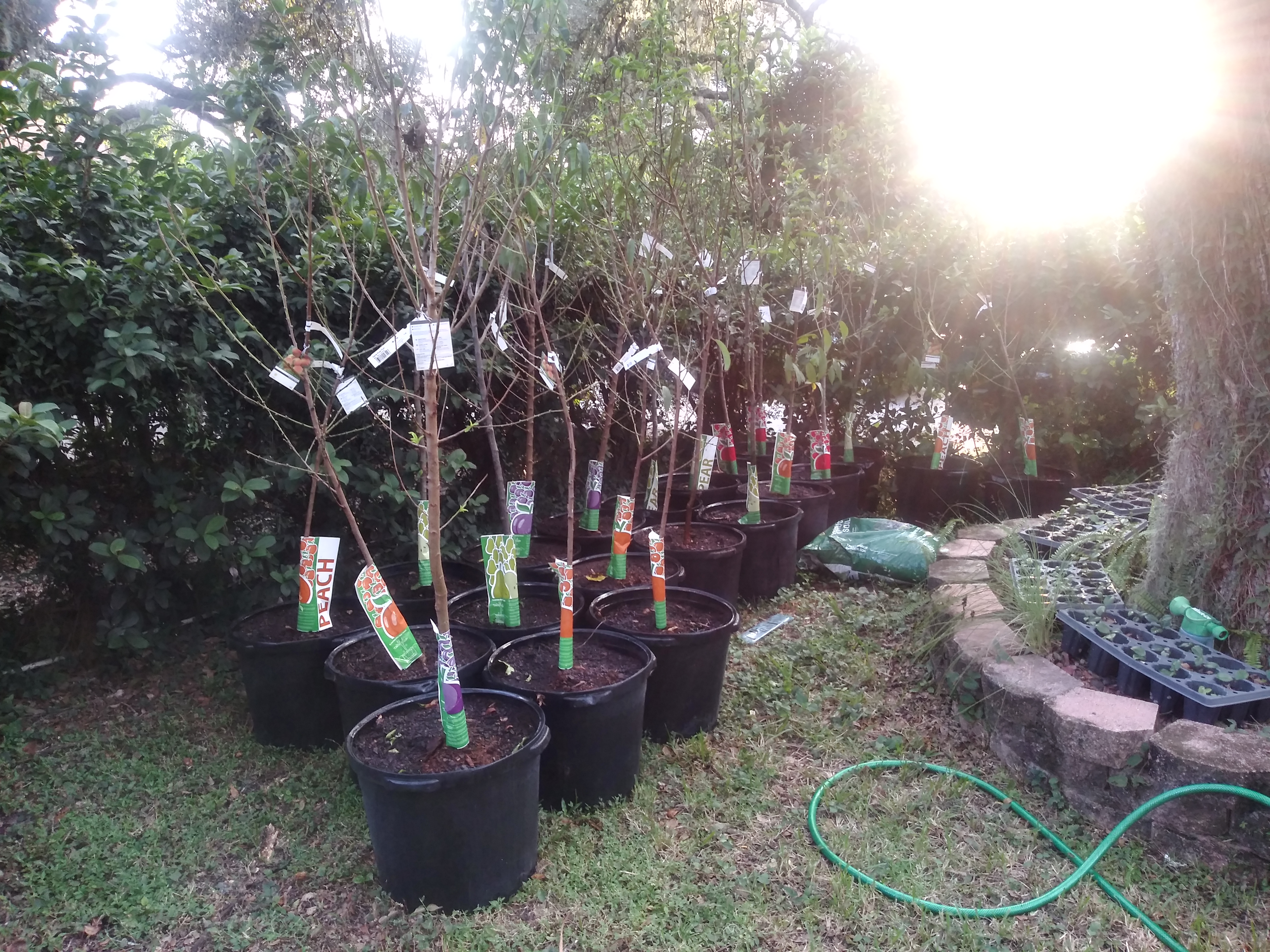

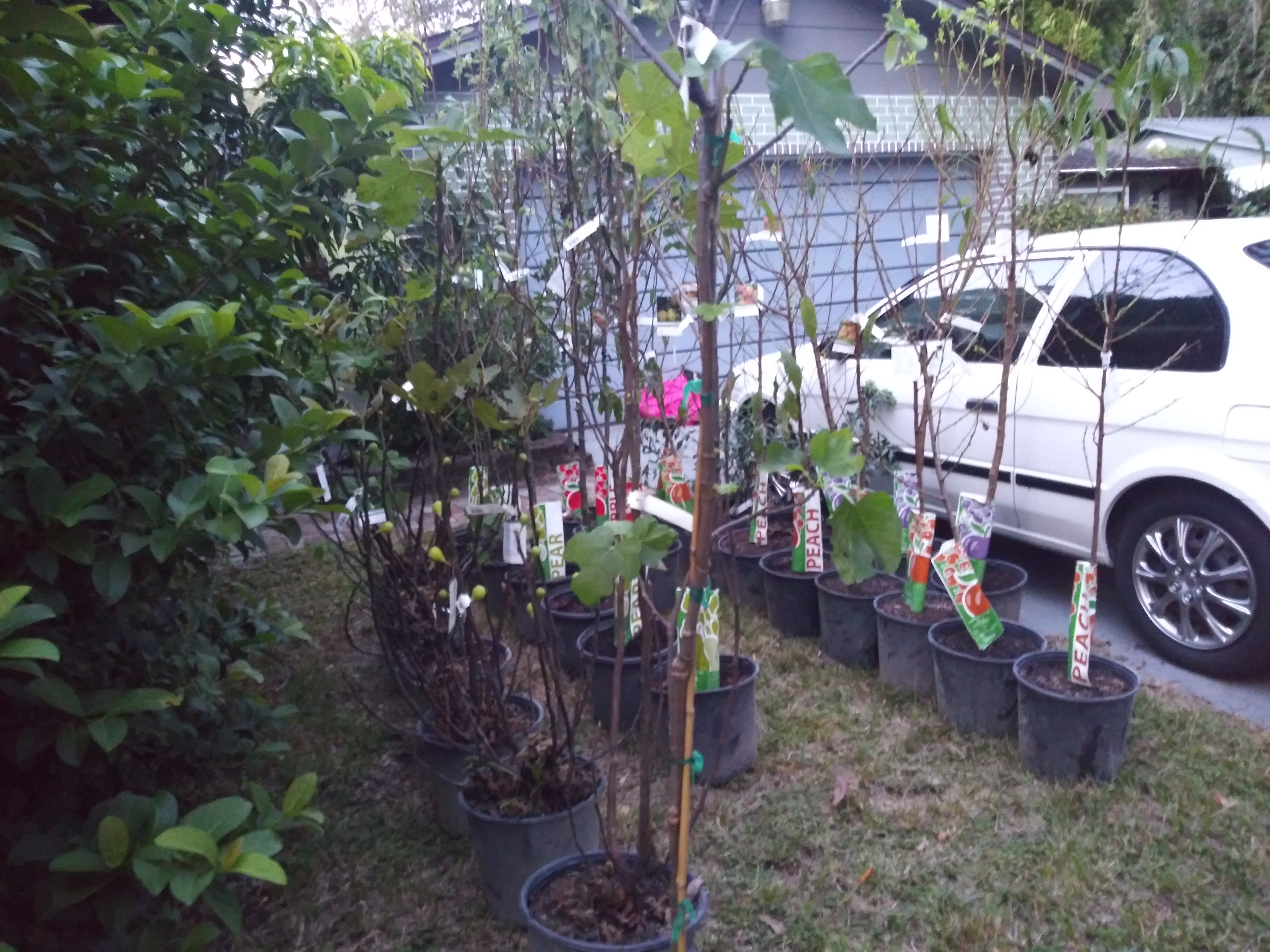

Tractor supply had many trees under an overhang completely neglected, more than 30 of them were fruit trees, I was able to buy them for 5 dollars a piece. Average height is 8 ft some 12-14 and some 5-6 ft high so nice sizes.
They need help, the pots were much too small, they werent watered in who knows how long, some had completely defoliated, some of the varieties will never produce fruit in Florida so why they were even in Southish florida Ill never understand.
I brought them home Thurs evening, same night put them in 15 gallon pots and added some cheap Lowes tree and shrub potting mix. I also gave them some liquid miracle grow stuff cause its all I had.
Some are showing improvements, some dont look much to any better. There were also 7 fig trees, they spruced up almost immediately with the sunlight and possibly the miracle grow helped.
Ive already put the fig trees in the ground on my property. Ive noticed fig trees appear to be a very hardy tree.
Id like to save every one of them regardless of wether Id see fruit or not. Im sure they would make very nice looking trees.
Can someone please tell me what else I could do? Thanks

I would keep putting the water to them. If you scratch the bark and it's green inside the trees are still alive; if the inner bark is brown they probably are dead. Still, for $5.00 you can't go wrong.

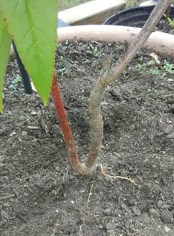

I got a real Charlie Brown type Nectarine tree from them a few months back. I thought sure it was a goner, very little green anywhere and not more than a foot tall. Soaked it, potted it, fed it, watched it. No signs of new life, but what little green there was stayed green. Maybe a month later new small leaves appeared in the two leaf sections. They grew a bit, then stopped. Some time later a nub appeared just above the soil line. What popped out of that nub is now close to three feet tall with a few branches. Next Spring, I'll nip off the old stem and let the new one take over.
Water and fertilizer, Miracle Grow if you have it.

The nub is below graft line and will not be same as top portion of tree,
It might become an attractive tree but fruit will be inferior or non-existant. OP should watch for this and base decisions on keep or destroy on fact tree will not produce desirable fruit. It would be wise to prune heavy during apporate month for each varity to balance top with roots next growing season. A small but vigours top is more resistant to disease,drought and insects that a large weak top.

There is still green in the cambium layer, not badly root bound but still in need of larger pots.
Yup. Fruit trees are made by grafting the desired strain onto a "rootstock". The sucker that sprouted down low is from the hardy rootstock and will not likely bear any desirable fruit.

Mine was in a small cardboard tube/package like a rosebush, not a bigger tree bucket. Not sure there is/was a graft, but I'll look closer today. It does have new growth on the old/original stem, so that is probably still viable.

Left side is the new growth, right side is the old. Neither is more than 3/8" diameter. The root is showing because I scraped the dirt back a bit for the picture. Are you saying I should nip off the new side?
