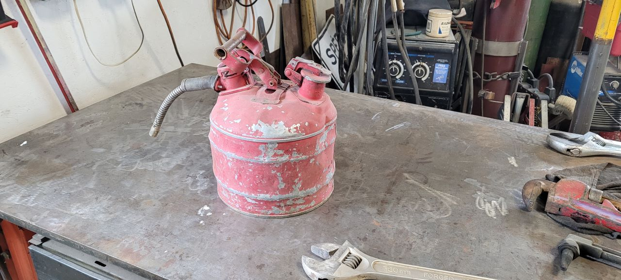

According to Posts #1 and #5 OP has a somewhat battered metal 5-gal. gas can that "has developed a little leak on the bottom". It is unknown, but likely, other leaks are developing. I am with ruffdog and 3 Horse Ranch, it is best to retire or discard the old can. How much time, aggravation, and money are you willing to spend to extend the life of the can? While I and others can relate anecdotal accounts of how we purged flammable liquid containers to work on them with heat or an open flame without blowing ourselves up, there is still some risk.
For around $70 - $100 OP can purchase a new "Justrite, Type II Safety Can" that has flame screen, overpressure protection, and a spout, that in my experience, works better than those plastic contraptions and that will probably last as long as the old "Eagle" can. If cost is a consideration, a plastic 5-gal. container is around $25. I discarded the plastic "no-spill" spout and cut a disk from an old plastic container to fit the hole in the treaded ring and thereby seal my new plastic container. I remove the new "cap" and pour directly into a funnel as OP likely does with his old can. There are many blogs and videos of ways to modify, adapt, and vent the plastic containers.

I fixed a small pin hole on the bottom of an old Evinrude gas tank with JB weld and it's holding up just fine. Just sand it and clean it up good and put a glob of JB epoxy over the hole. For regular gas cans I really like the plastic "utility jugs" they sell at TSC. They will hold 6 gallons and will empty very fast compared to the crappy ventless EPA cans.

Eric, JB Weld is a very good product. Applied to the outside. I'd want the hole to be evident enough that I could squish the product thru the hole into the can a little. This would give it the best chance of bonding and staying put.
Keep us posted.
Awesome can!!! I have a smaller version with the more modern cap/vent system.

Good grief, it's just a gas can. From the looks of the can the OP posted, that whole bottom seam looks kinda sketchy. Buy a new poly one, an aftermarket spout and it'll last you the rest of your life.

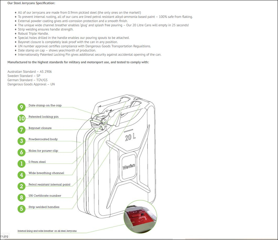

NATO Jerry cans are not cheap to buy, but are the best and lowest cost in the long run.
They are available in 2.5 & 5 gallon size.
