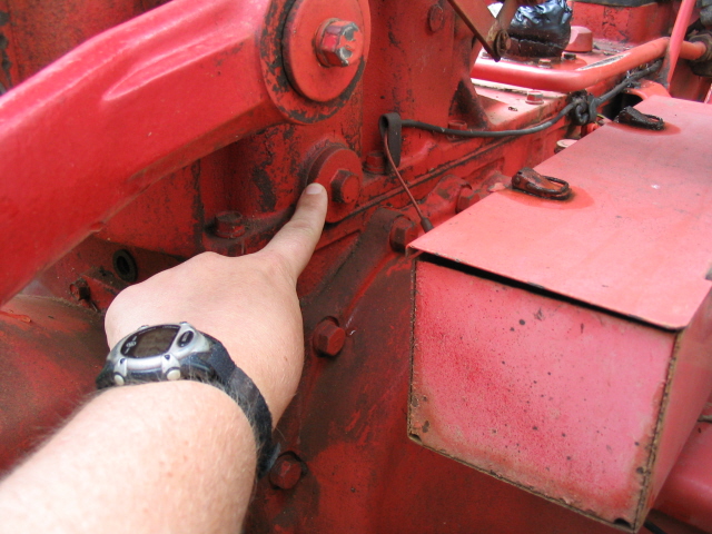

I'll second the pipe wrench idea if the head is rounded. Also, take a hammer and lightly tap the bolt for a few minutes. Just light to moderate tapping will often help a siezed bolt.
You mentioned a drain plug. Where is the drainplug located? If you removed the one on the belly of the tractor, you drained out the 80W-90 gear oil from the transmission. You may already know, but he 650 has a seperate reservoir for the hyraulics and the tranny. Tranny takes 5 gallons of 80W-90 gear oil. Hydraulics use approx. 1 gallon of universal hydraulic fluid.
/ Satoh S650G tractor
#22

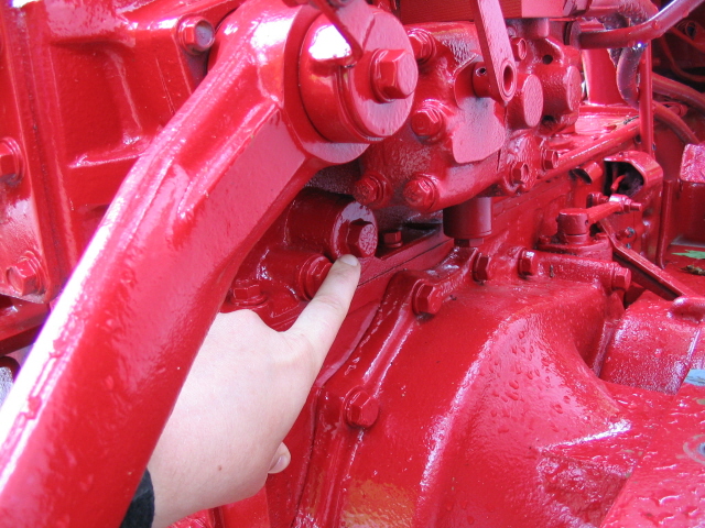

B/8...the drain plug I removed is EXACTLY where you pointed in the pic for where the SCREEN Filter was suppose to be.Except when i removed this plug,,it was MAGNATISED on the end of the bolt and had NO screen WHATSOEVER behind the bolt.Just a Magnatized bolt. So,,,I was tring to remove the OTHER bolt in the pic which was a BIGGER bolt in hopes this was where the screen filter is. This bolt is like maybe,,,twice the size of the drain plug for the hydraulics and DIRECTLY in front of the bolt which you showed me in the pic. If this bolt ALSO doesnt have a screen behind it,,,then my conclusion is SOMEONE else who owned the tractor BEFORE us,,,Removed the screen filter and REPLACED the bolt with a magnet on the end of the bolt instead of the screen.
And Kernopelli,,,,Yes I tried a BOXED in wrench as well as a 6 point scocket and YEs its rouned on a point or two on the bolt,,I havent tried a pipe wrench yet but NOW Im not sure this SECOND bolt Im trying to remove is a bolt or not cause directly on the opposite side of the tractor in the SAME EXACT location is another bolt the SAMe EXACT size and it WONT budge either. If you look at B/8 s pic where he is pointing,,,I removed that bolt and all that was there is MAGNATIZED bolt instead of a screen. Now DIRECTLY in front of B/8s finger to the RIGHT of his finger is the NEXT bolt Im trying to remove to see if the screen is there???????
Hope this makes since to Both of you guys and Ill wait to hear from BOTH you guys before I proceed any further...Thanks my New Found tractor friends

I am not familiar enough with your tractor to say for certain if that is supposed to be the filter screen location. My Mitsubishi is quite different even though it is a "family" member. Bl8tant does however seem to know quite a bit about this model so I am confident he has given you good information and if a screen isn't there, it is MIA.
This leaves me to think that someone probably has removed the screen and replaced it with the magnet.
I would contact Bill at Valley Power 1-800-609-5110 vppinc@cox.net satohparts.com he is a Satoh expert. Explain the situation and tell him about the post you have made here on TBN ( he is a member here and he may want to look at the thread to better familiarize himself with the situation). He can probably supply a new filter and give any additional help you made need.
Let us know how it all turns out.

just a hunch here. not familar with your model but the filter screen is normally on the suction of the hydralic pump.this position has to be near the lower portion of the transmission.on my tractor it is in front the rear axle. same side where you remove the bolt.there is a plate secured by bolts.behind that plate is my screen.

I removed the ENTIRE top plate to see what type of hydraulic screen I DO HAVE and its about the size of a small cigar in diameter and goes completely from one side of the bottom of the tank to the other side,,,,Filling the ENTIRE floor of the tank. There is a BIG bolt directly in line with this screen on the outside of the box,,,On the right hand side of the tractor,,,And using 100 psi of air pressure and a HIGH dollar 1/2 impact wrench and a 6 point socket,,,,I CAN NOT GET THIS BOLT to BUDGE,,,,Any suggestions???????? ON the left hand side of the tractor,,,in line with this same screen is a METAL tube with the same size bolt and washer and I REALLY DONT want to remove this side in fear of maybe starting another LEAK in the future. Awaiting any replys. Thanks Guys and SEMPER-FI to ALL

Since you have the top off can you clean it in place?
Other alternative is a really good 6 point wrench and a looooong cheater bar. Of course, sometimes things break when doing this.
I have a satoh 650 but have never tried removing the screen. Is there any chance this has left handed thread? I can't imagine why it would.

Yes Greg I can clean it,,,,BUT,,,It has holes in it and would like to replace it,,,,Will try a pull bar with a pipe or go buy a LONGGGGG wrench and try,,,,Dont know how else to get it off after attempting it with an air-impact driver?????? thanks for the reply & Semper-Fi my friend
