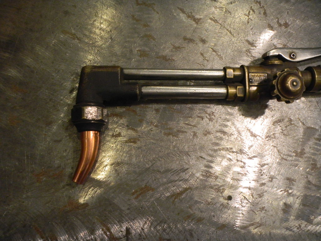

One thing nice about plasma cutters, if you get one that can scarf! In most cases I'd rather use my plasma than my carbon arc torch. But then again you can buy a scarfing tip for your oxygen & acetylene outfit too.

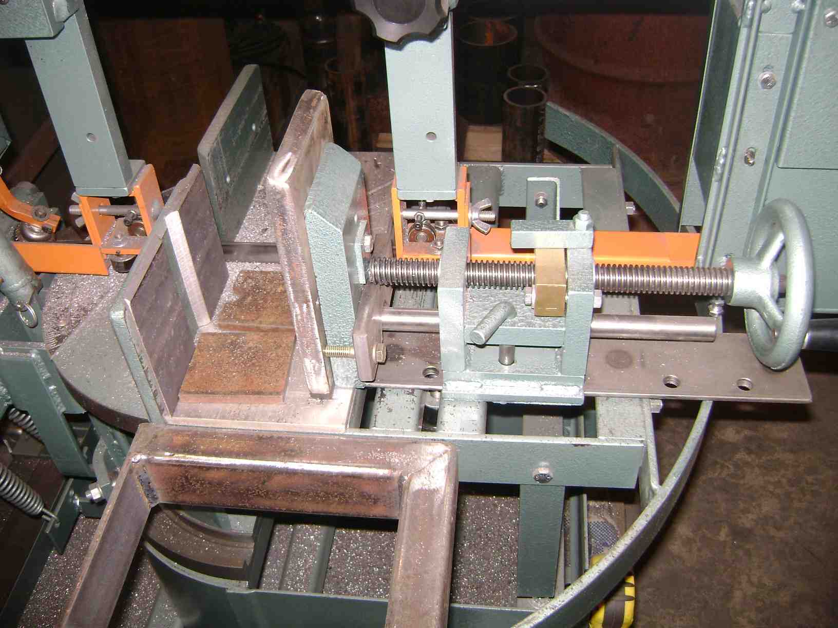

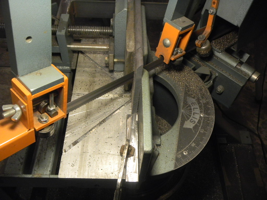

Just a little more saw than I really need. Nice to have, but hard to justify for hobby work.
   / Santa was good #18
I'm just a hobbyist myself. ;)
Well you would certainly be on the on the high budget hobbyist allotment with very nice expensive toys where somebody like me would be on the ultra low budget end of the hobbyist spectrum in regards to metal working.
Of course skill factor (you on high end) and me on (low end) as well - LOL.
I am pretty sure your Ellis saw cost more than my entire metal arsenal
