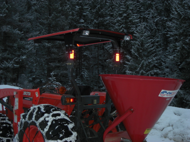

I have a King Kutter seed spreader that I use to spread sand with, no salt. My driveway is 1/3 mile long all up hill. It gets really icy and the sand alone works excellent.
The spreader works great for the price. I have to bounce the 3ph a bit to keep the sand flowing. I just keep the RPM's down to keep from waisting the sand in the ditch. I'm sure it would be easy enough to fabricate some type of shield to keep the spread more narrow but I don't have a need.
One thing to consider, is to filter the sand prior to putting it into the spreader. I use some expanded metal placed over the top. It keeps the rocks and larger stuff out. I learned this after breaking the agitator during the iciest week of the year.
They are hard to beat for the money.
Here are a couple of pic's.
Craig
