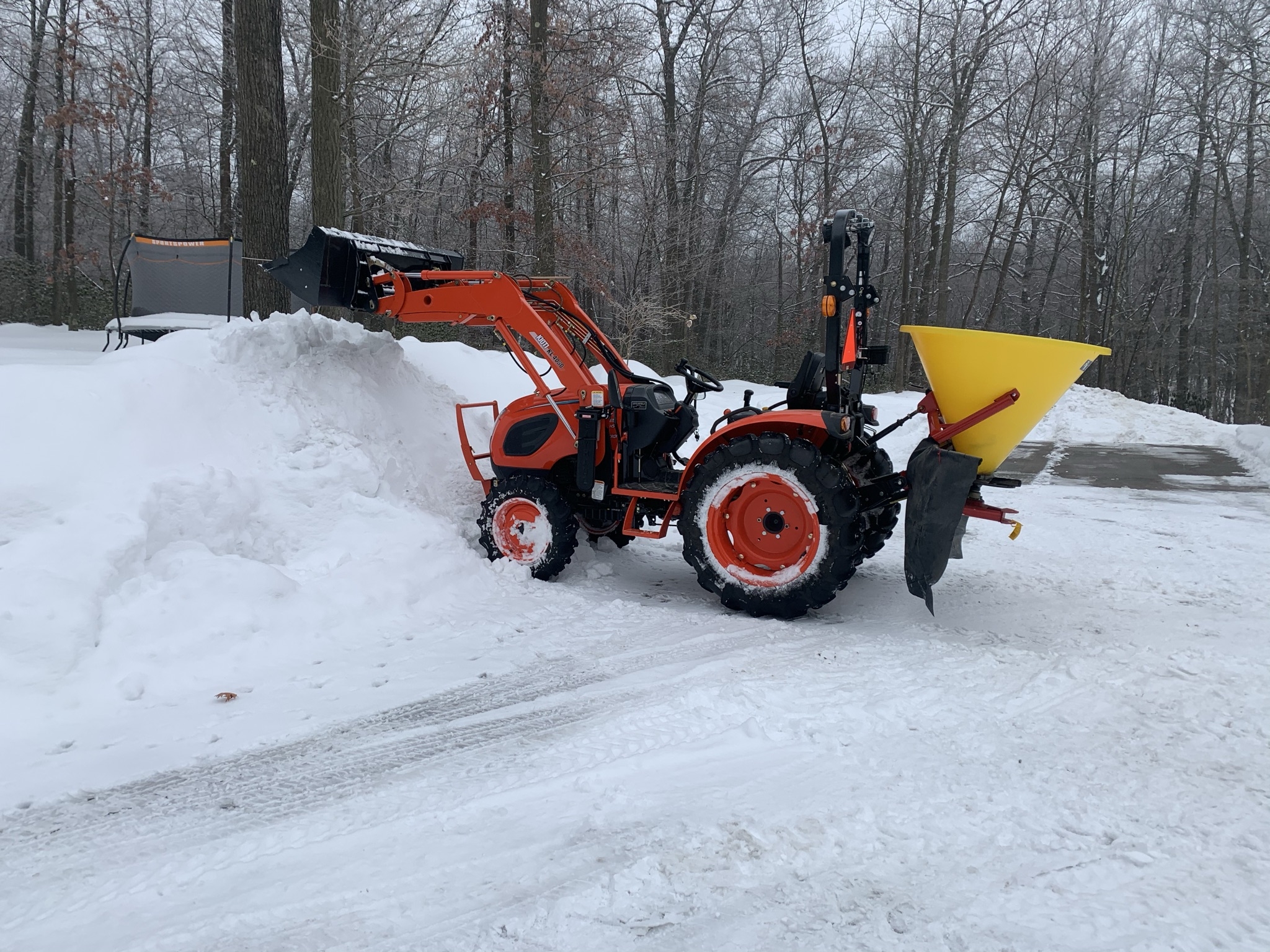

It is the poly hopper. Here is a pic of it on my prior tractor.

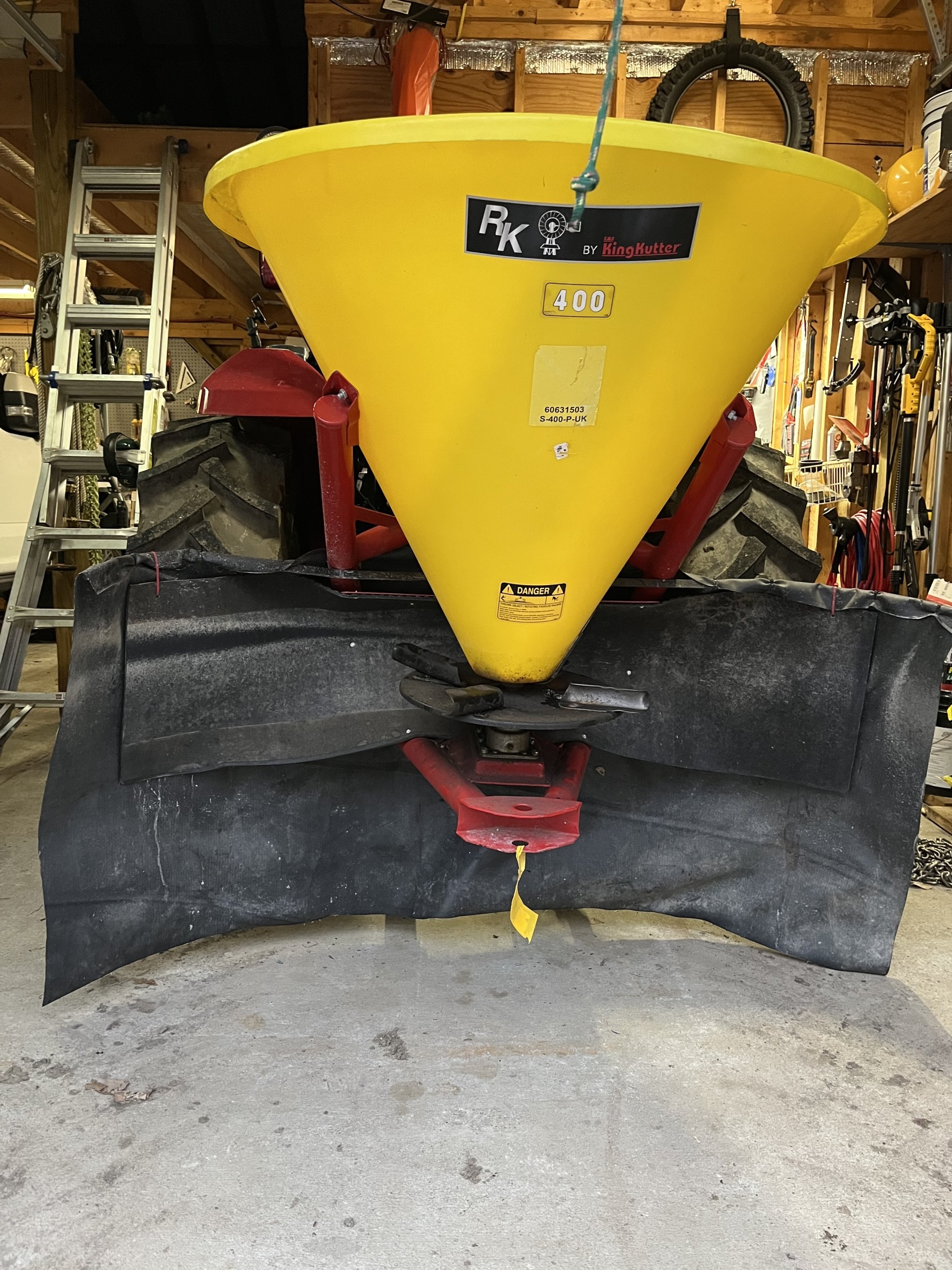

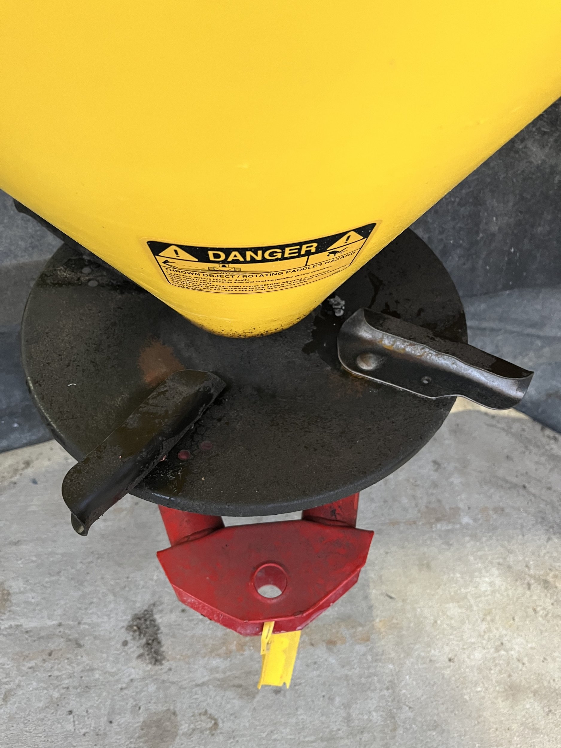

Kieth, could I pester you to remove the bag and take a picture of both sides of the spreader near the back?
If you have had this problem since the beginning of ownership its either an adjustment issue/missing shield or
a defect of some kind as these machines were designed to prevent this kind of mess that you have to deal with.
Leon

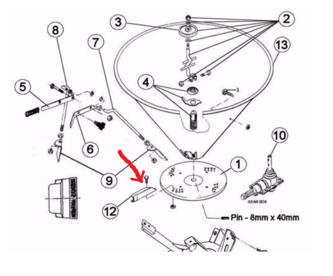

Instead of cutting the distributor vanes, why not make some shorter ones out of angle iron as an experiment?

Hello Kieth, my other question is this; do you operate the spreader fully elevated
like this when spreading the No. 8 limestone and rock salt?
The pendulum should not be any higher than the centerline of the rear axle.
It will work ok with the spreader near the ground level.
