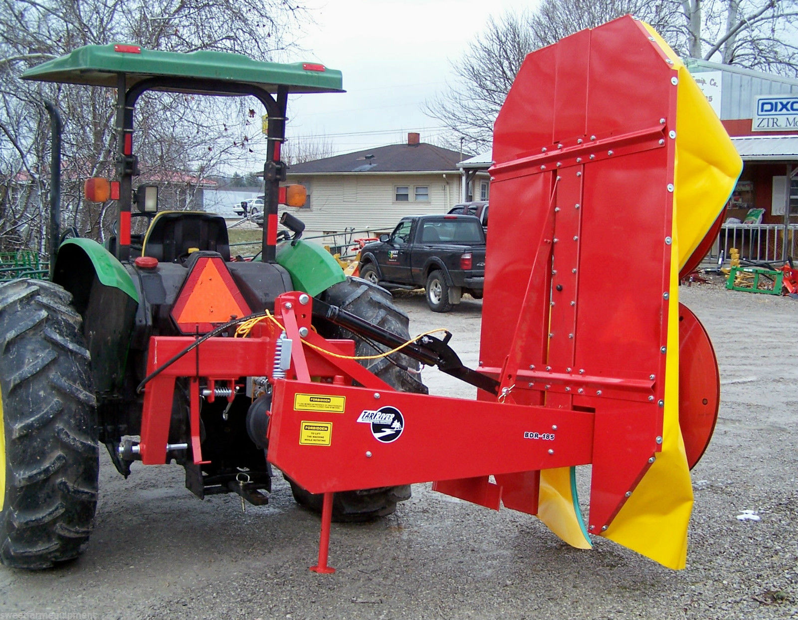

We have the 185 Tar River drum mower with or without hydraulic lift cutter bar. $3995 or $4295 with free shipping to Oklahoma. Ken Sweet
