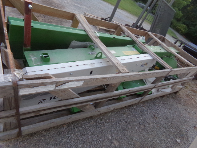

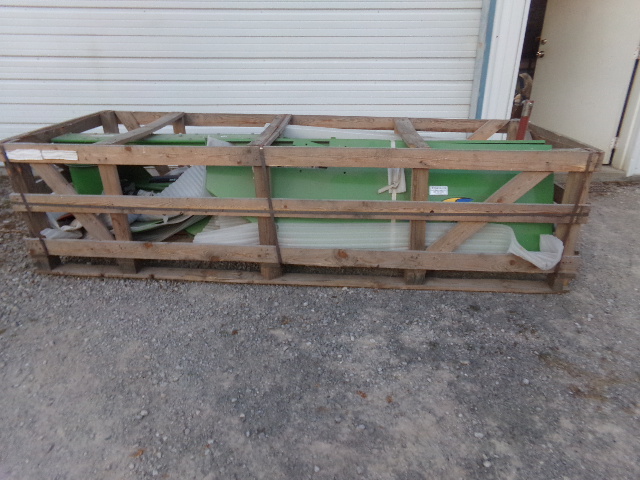

Got it this week. Just got to unbox it and put it together.

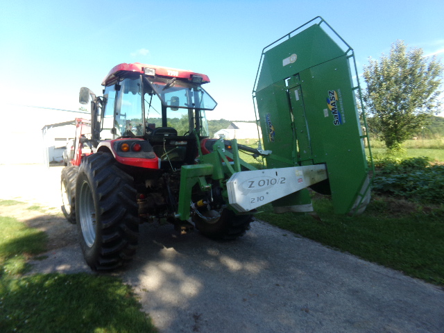

Just about got it leveled out today.
Here what it looks like on my TYM 754.

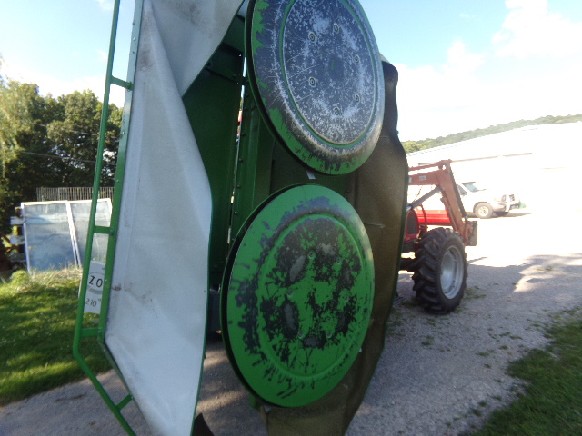

It floats good front to back. It's side to side that I do not have it level yet.
With this one you have to adjust the lift arms and then use a chain, that runs from one arm to the top link on the tractor to level it from side to side.
The two smaller ones I had, work just like yours.
This one has hydraulic lifting on it. (see picture in post #4)
See how all the paint is off the drum at the top of the picture and the bottom drum has lost very little.
I see what you are talking about.
