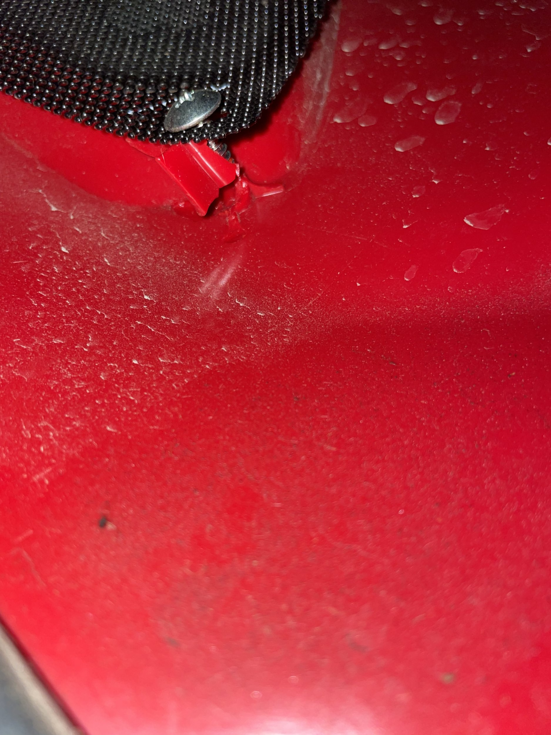

Bought my SA325 after years of tire kicking and research/comparing every tractor made. Have had it for 2 weeks with 3.6 hours on it.
I have noticed that at cold start up, it will spit and sputter before clearing up. This is regardless of air temp and following the manuals glow time. Did it at 60 degrees as well as at 40.

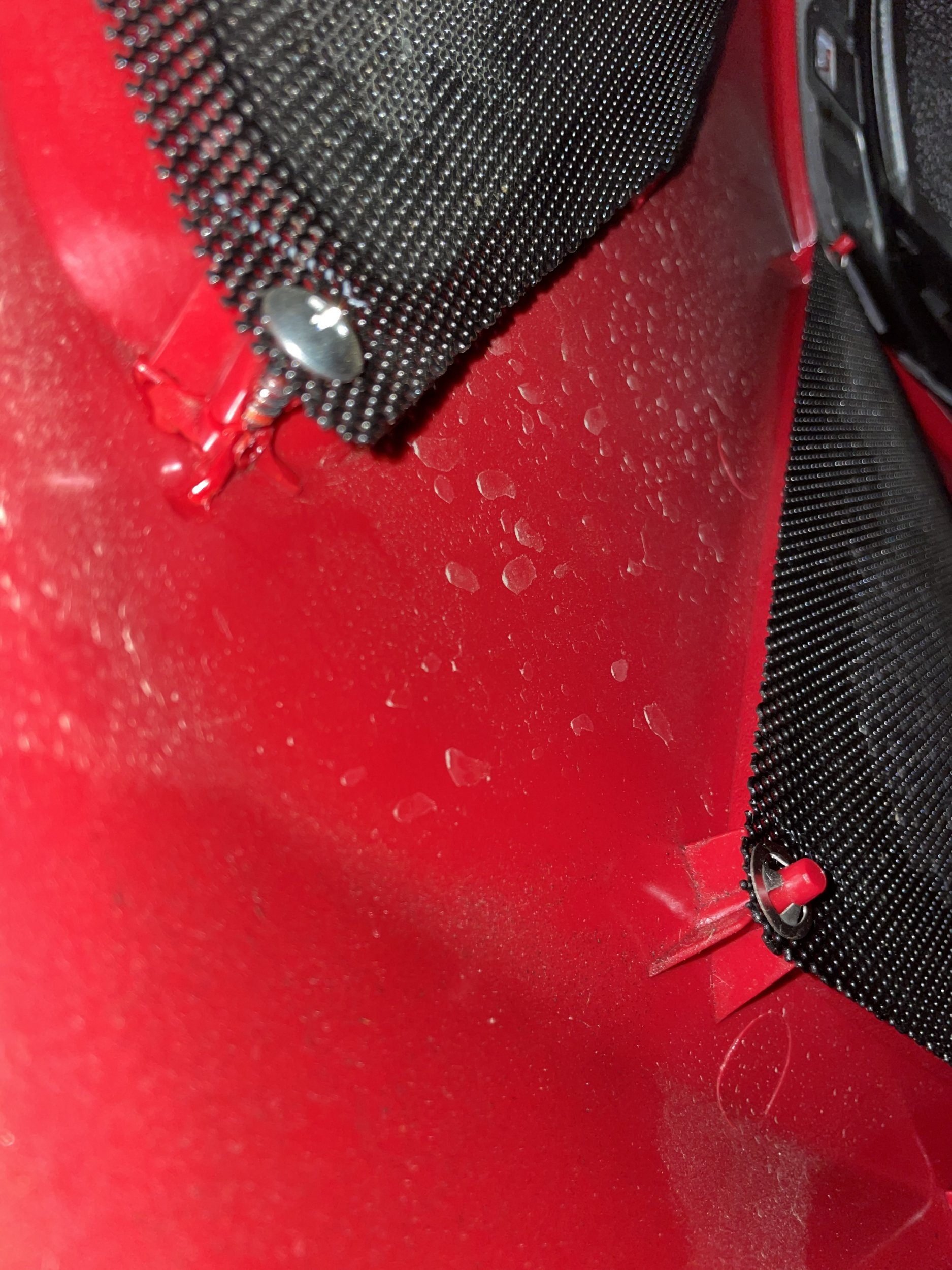

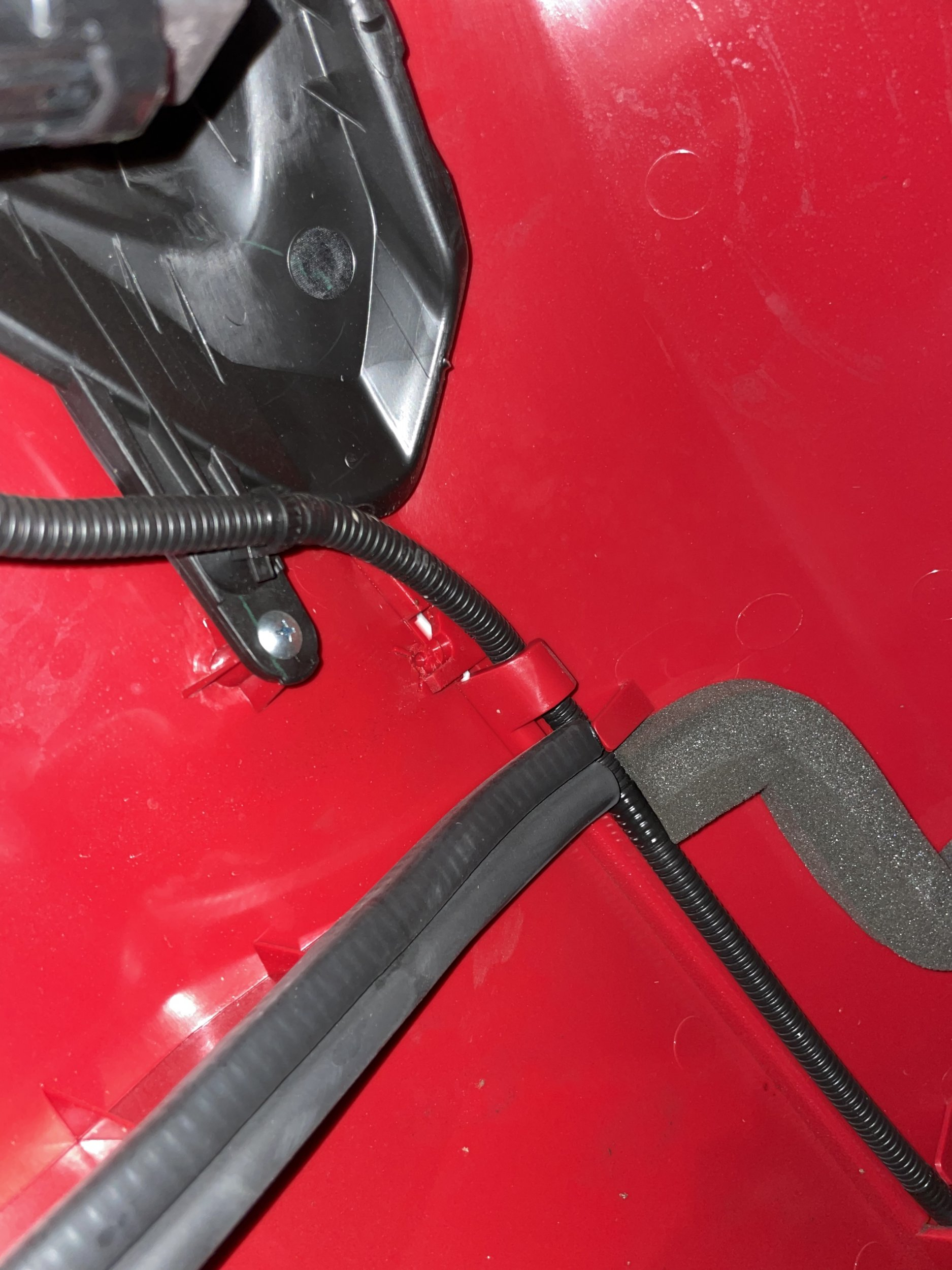

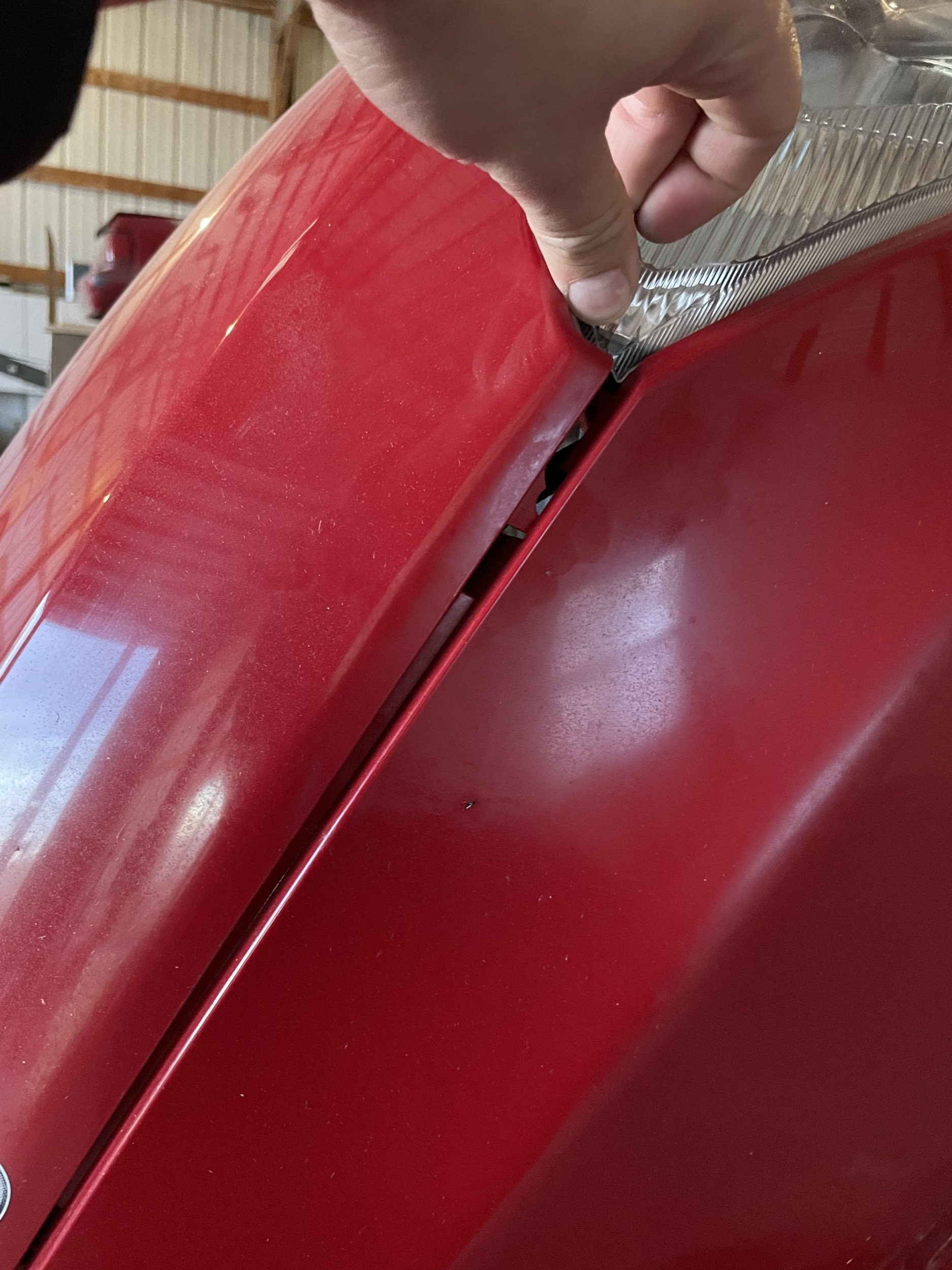

2nd, today the father in law stopped by to see the new purchase. When I went to open the hood we both heard parts fall. Come to find parts of the plastic hood had busted off causing the side panel and front grill to separate… left me feeling a little embarrassed.
Starting to wonder if this was worth the lower price compared with the kubota I was wanting… anyone else experience similar issues?
Going to find out if yanmar stands behind the warranty better than kioti does😬

I don't know Yanmar, bought Kubota as it was more appropriate to my needs. I found a couple nuts not correctly torqued. Given your issues I suggest going around your tractor and checking tightness of various nuts and bolts. Get a torque wrench and check wheel lugs and loader torques, too.

Yeah, this was the first time I personally opened the hood, didn't even get a chance to slam it shut. I think they went a bit overkill on the shock for it. Takes some effort to close the hood. Any other times before was done by the dealer showing it to other tire kickers. Still, brand new you would think the plastic would be a little more resilient to use, after all the motor is just going to rattle everything at startup and shut down. :unsure:

Contact the dealer. This will likely be covered by warranty.
/ SA325 issues #6
Yep should be covered under warranty, I would question what it went through and/or what the dealerships did before you received it ie overtightening screws etc. Not sure on the sputtering, mine will if it's cool out and haven't cranked in a couple weeks but that's about it

Finally an update!
After contacting the dealer right away, they said a new one would be on the way. Finally this past week, they let me know it was shipped and on the way.
I would check in about once a month for an update, and dealer wouldn't have any new info from Yanmar on timeline. Yanmar definitely needs to get their supply chain figured out if they want to survive here. I know my dealer is not the issue.

I had the exact same thing happen, shut hood too hard. Plastic piece broke off. Luckily it didn’t separate from side panel, now l close it oh-so gingerly.

Yes the hood where it connects to strut is a known "issue" and will be covered by Yanmar. I have not experienced any issues yet but I close mine by pressing down at that section. The only time I've had sputtering on startup was after 3 weeks sitting and temps in 40s F and only let the glow plugs heat up for about 5 secs. has been sitting at least 6 weeks since cold and solid rain, let plugs go 10 secs and fired right up and purred no issue. Man this rain needs to let up just for a week so i can get out and bush hog and not be mud riding
