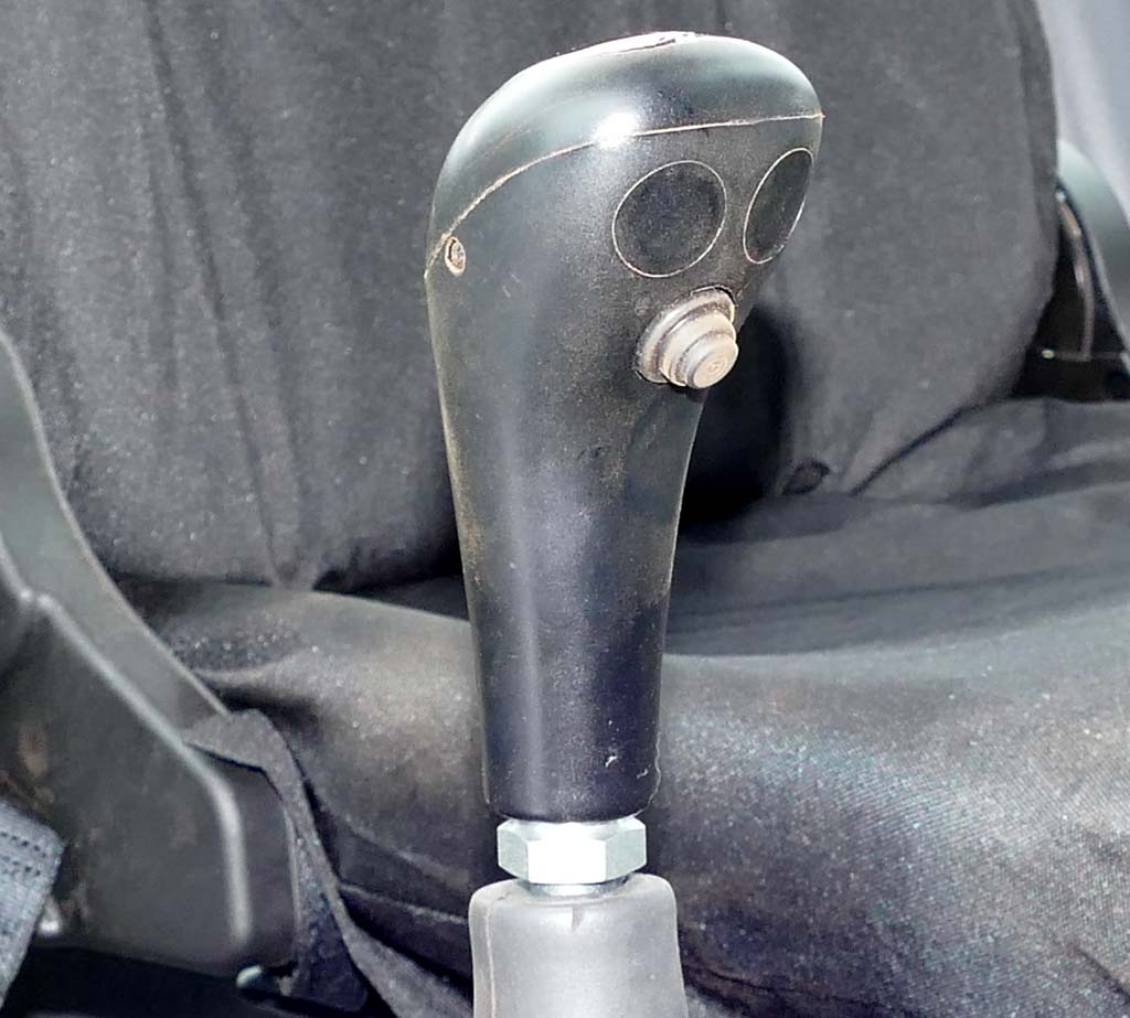

I've had my RX8030 (power shuttle with cab and factory-fitted loader) for only a couple of weeks now, and this is the first time I've used a 4-in-1. I'm curious though regarding the single button on mine, vs the two buttons I've seen on others here.
Am I right in thinking mine is a "diverter" function? ie - I can use open & close OR curl & dump, but not simultaneously, as opposed to a fully fledged operation where all six functions can be used simultaneously?
I'm also thinking (twice in one day - something of a record!:D) that the Australian/NZ RX8030 is an RX7320 with different emission protocols. 76hp vs 73hp.

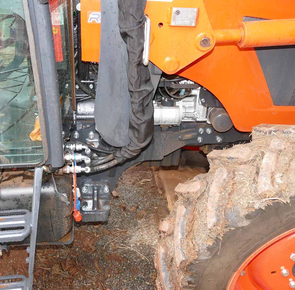

For info, the hydraulic hose setup near the base of the loader tower looks like this on mine - well clear of the front wheel:

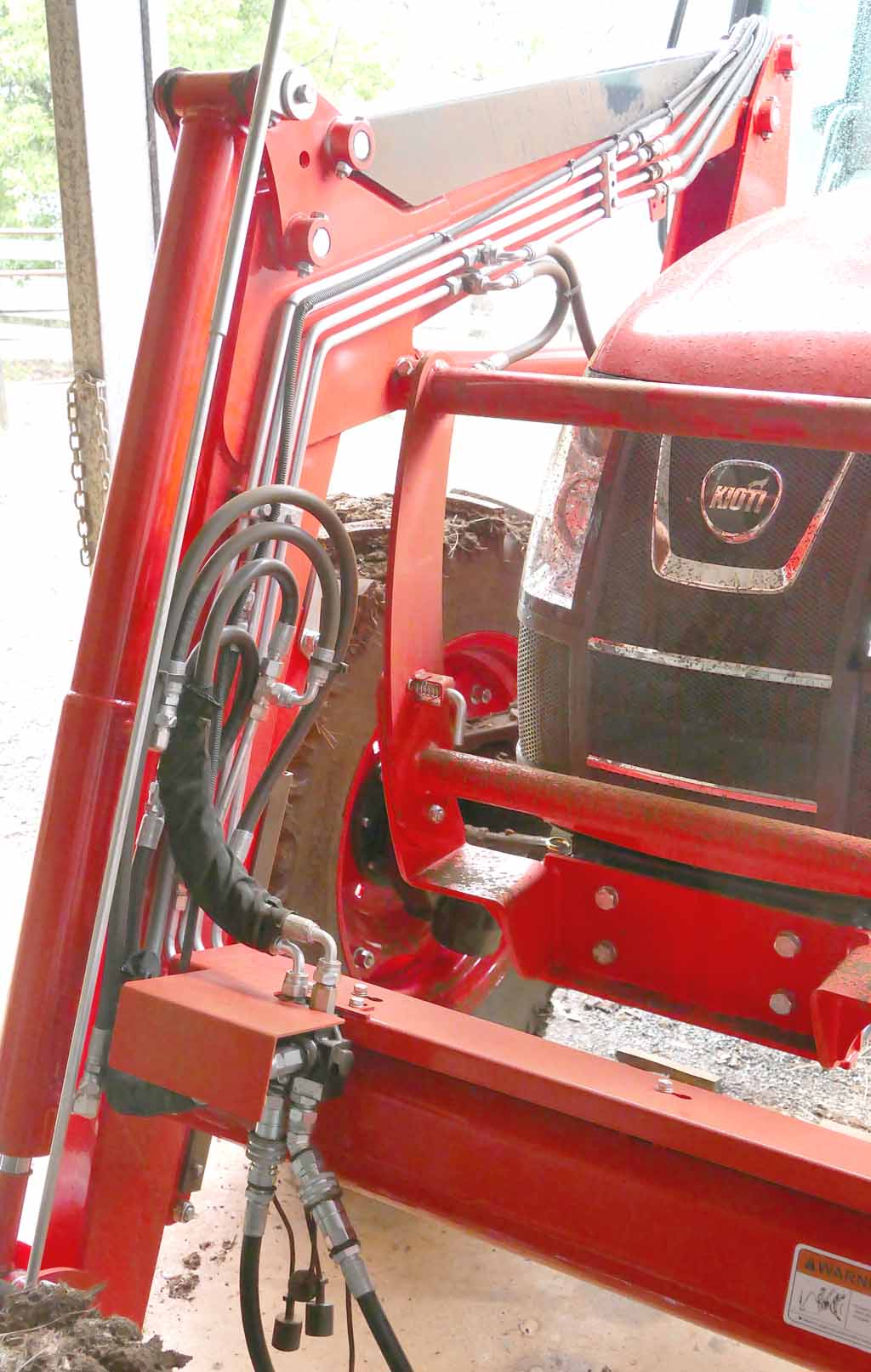

and on the loader:

Yup, thatç—´ a diverter valve vs a 3rd function.
And I壇 guess youæ±*e right about it being the same tractor. The NX4510, NX5010, NX5510 and NX6010 all have the same engine - just a different tune for 45, 50, 55 and 60hp. And I believe very few if any other changes except tire size.
View attachment 679632 View attachment 679633

In order to use multiple functions AT THE SAME TIME, the joystick valve must be piloted, and ours are not. You can feather the joystick a bit, but under load it is pretty much one function at a time. With two buttons on the electric over hydraulic diverter valve, effectively, whatever ram has the LEAST RESISTANCE will receive the fluid. Again you can sort of feather things, but under a load, it is pretty much one function at a time. That said, I really like the home-made setup I made as it looks like the third function the factory should have provided with hardlines, custom-fitted hoses, matching hardware, et cetra, but never did.

So here are the pic's of the Kioti 3rd function for the RX7320. It is a very nice clean setup. I only wish it included hard lines along the loader arms like the other hydraulics.
Where does the new valve get it pressure line from? Is it fed straight from the gear pump?
I'm revisiting the idea of 3rd function; been using hoses from the rear-remotes for the last year and now with a bale clamp I'm finding that I could be more efficient if I had all controls on the joystick instead of having to move my hand.
cutthroat, I was looking again on your pictures and it looks like part of your setup is attached right to the loader frame on the tractor, that big 1" thick steel plate. Do I have that right? I'm likely to order the kit and install it myself but I'm not sure I want (or have a good way) to drill holes like that. I wonder if the WR Long kit might mount differently. Can you confirm if holes had to be drilled into that frame? Thanks.
