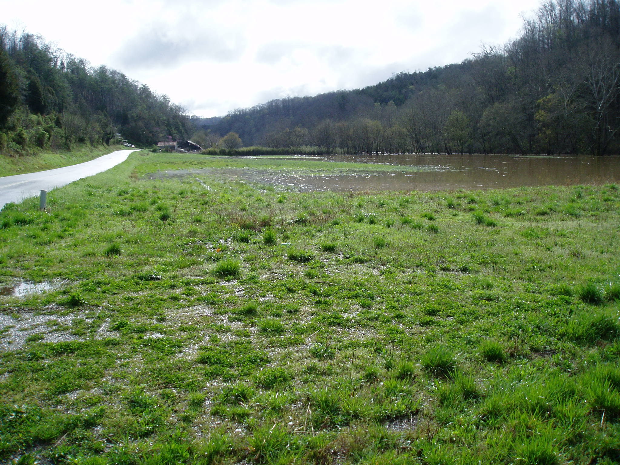

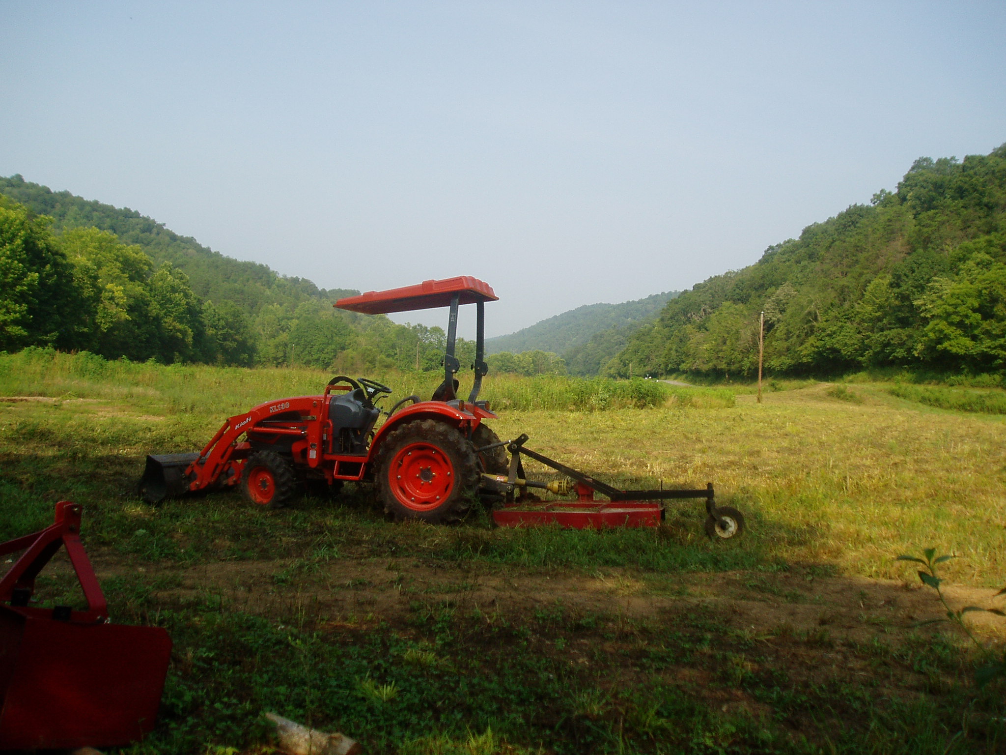

I just finished hogging 2 of my 3 pastures for the first time-about 12 acres. Half of the west pasture and part of the middle were really rough, i mean rutted. I was mowing in mid range, but had to back off the throttle alot and crawl over the bad areas to keep from losing a kidney and the occasional vertebrae. Where it was smoth i could run at full mid range speed. You could not tell the surface was rutted because the grass hid them well.
I suspect that the previous hay-ers have been in the fields when they were wet. Also, the creek floods a couple of times a year putting the pastures under anywhere from 0 to 3' of water, would this cause a rough pasture surface?
So what is the fix? What attachments are designed to smooth out an established pasture, or do i have to rip everything up and start over?

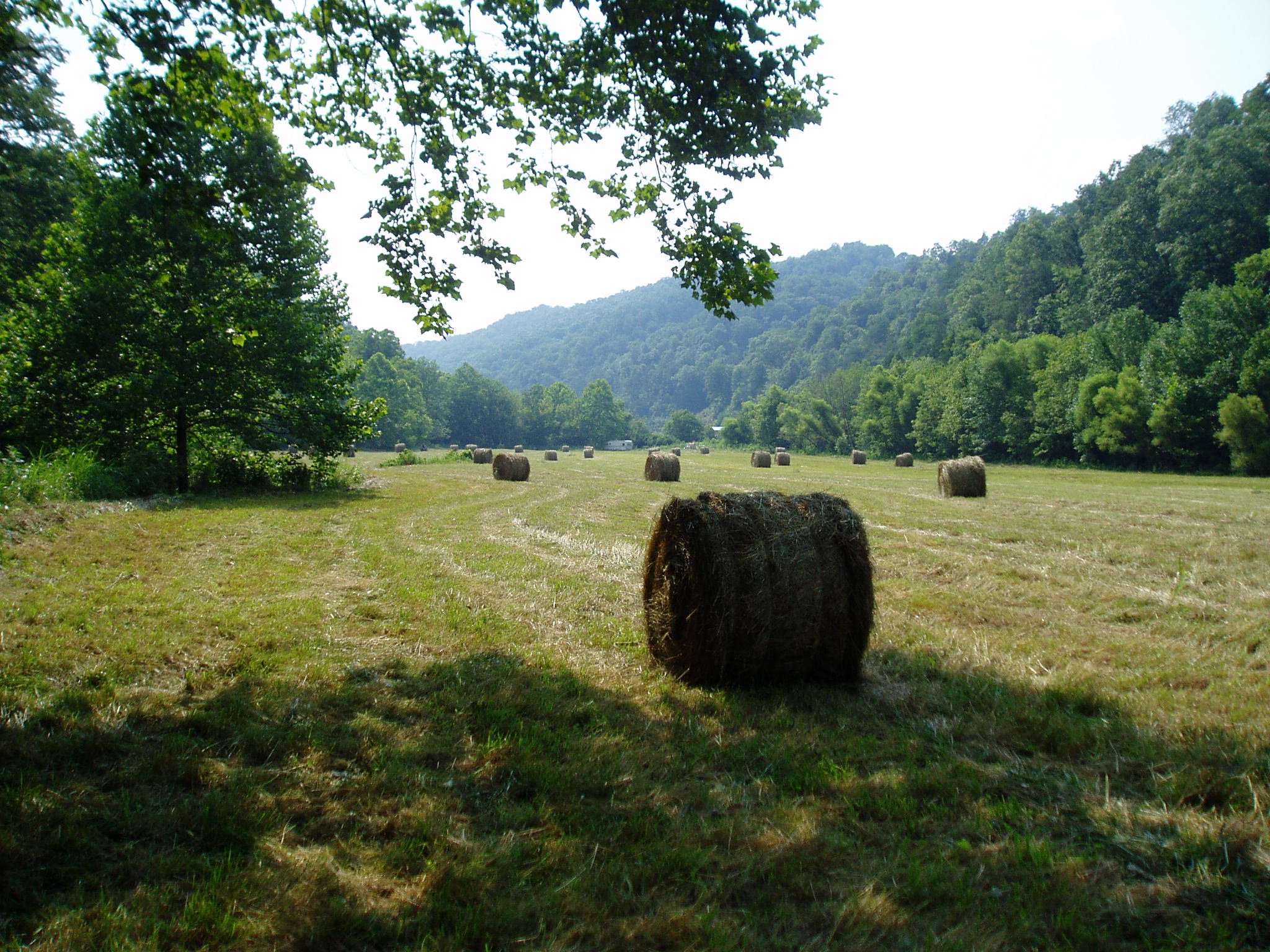

I was fortunate enough to get a local guy to start haying the whole place. He promised to spray for weeds if i could get everything hogged, so it is done. He did hay the middle pasture(9 or so ac) and took 44 wheels off of it. The other two pastures had gone several years fallow, so they need some attention to start producing better grass. Btw, it is all johnson and fescue grass, so attempting to seed anytheng else would take a huge amount of time and money. I understand that it would all be for naught the first time the creelk flooded and re-spread the hardy J & F. I talked to a local wildlife biologist who said getting attempting to eradicate fescue may cause insanity:D !

Thank goodness my neighbor has a "big" tractor so i can attempt to ignore the little voice saying, "You need a bigger tractor":) Here are acouple of pasture pic's:
