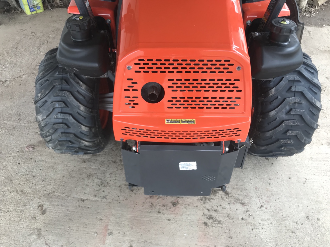

I just put WT300 tires on my ZD326P this spring and really like them so far. Much better traction and they don’t seem to scuff the turf as bad as the original tires that came on it. If been running ZD machines since 2002 so perhaps I operate the machine better now than when I got my first one. I’m glad I upgraded
Too bad my machine doesn't look as clean as yours! Way too dusty here...

Do you have a side view of mower with new tires?
