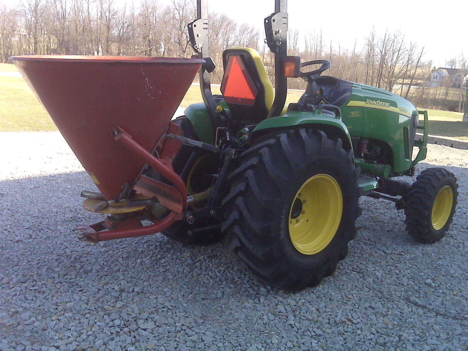

I have a 3520 and I have taken the entire loader off the front and put on a large spreader full of fertilizer, and 6ft brush cutter, and never pulled the front end off the ground ever. I would defintely try it before I spent the money for a bracket and weights. I don't think you will need them and you want to stay as light as possible when you are doing yard work. I don't think that arerator is as heavy as a 6ft brush cutter.
What are those tires??? :confused:
