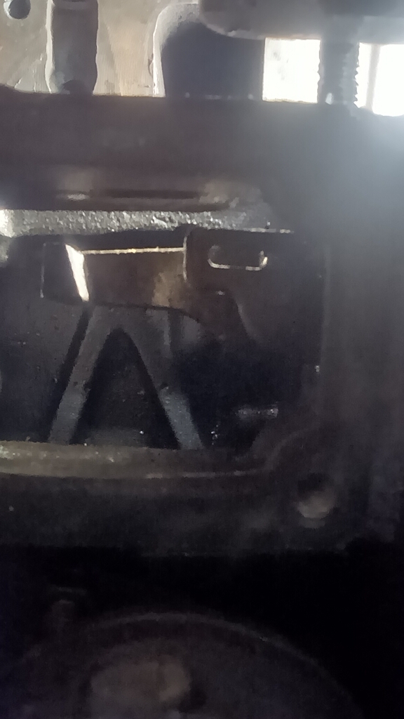

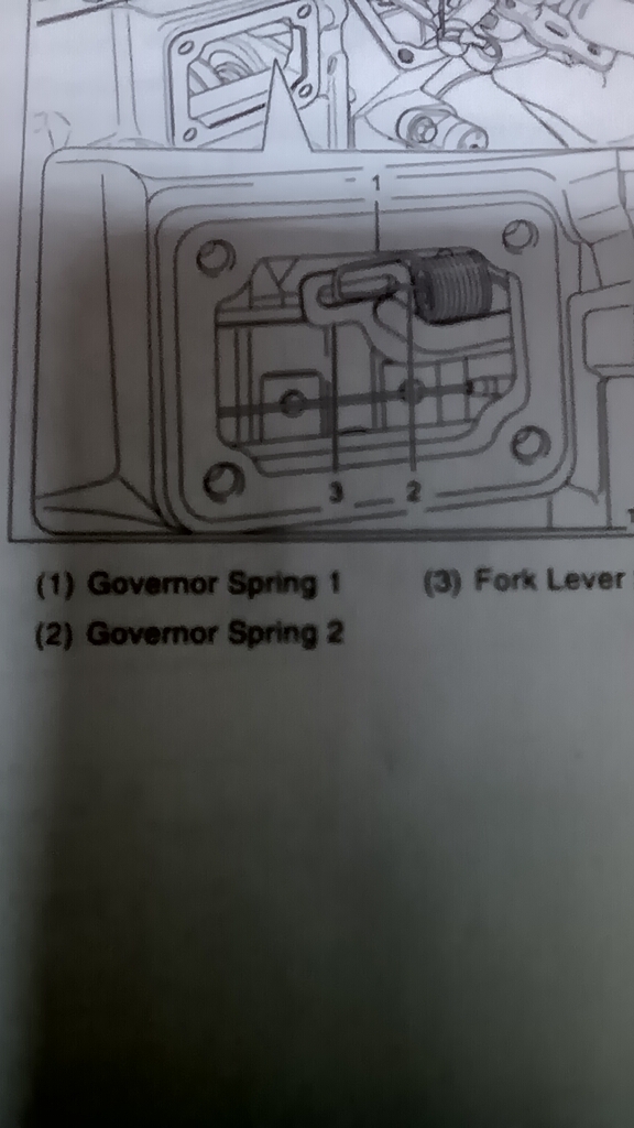

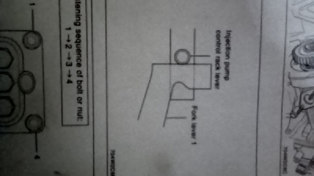

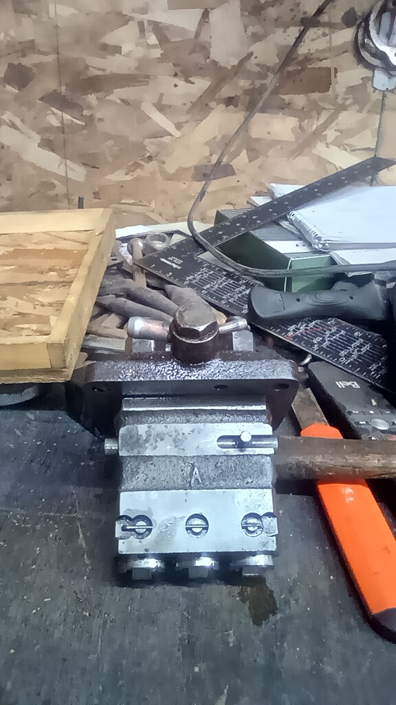

Hi. Folks, I had to pull the injector pump from my ck25 kioti to have it seviced.( Broken plunger spring). When I put it back in and started it up it went to fill throttle. Luckily I was able to plug intake quickly.looking through the service manual it looks like I may have had the pump control rack leader in the wrong position but I'm not sure.The diagram in manual is not very clear. I'm hoping someone may have some input.
