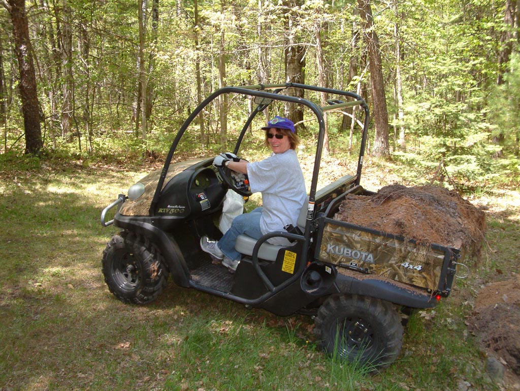

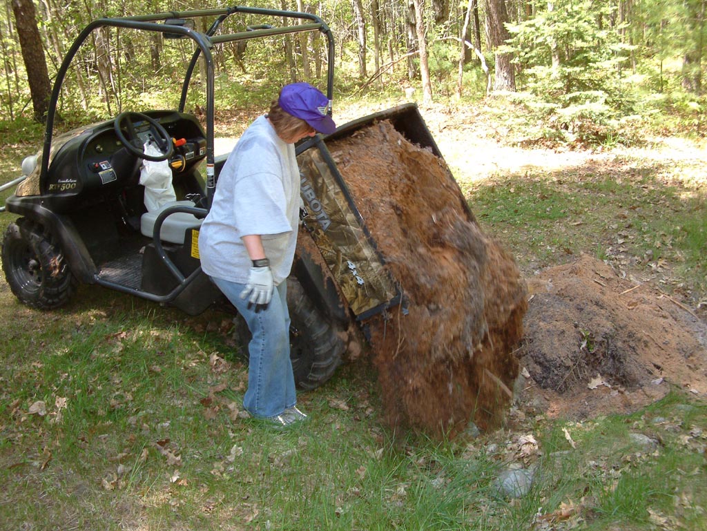

Here is my automatic bed dump. She's having so much fun she works for free.
This does show you how well balanced the bed is.
