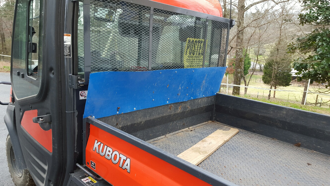

It seems every time I load my bed up (which is almost daily due to cleaning the horse stalls and barn out), I am always getting dirt, hay, leaves and sticks falling between the cab and the bed on top of the motor. At the end of the day, I try to remember to go to the shop to blow the area under the bed out but that does not always happen and the next time I use it I smell the manure or hay getting hot. I am sure someone out there has the same problem and has a good solution. Attached is a picture of what I have done until I can find a permanent fix. I took some leftover plastic skirting from my race car and screwed it to the bed. It is not pretty but works.

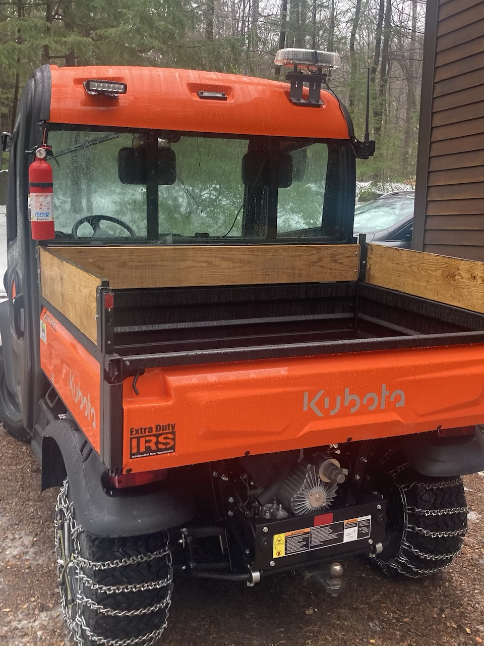

/ RTV1100 solutions? #5
I had side boards and headache rack built to keep it in the bed. Zip tied cardboard sheets inside when hauling mulch.

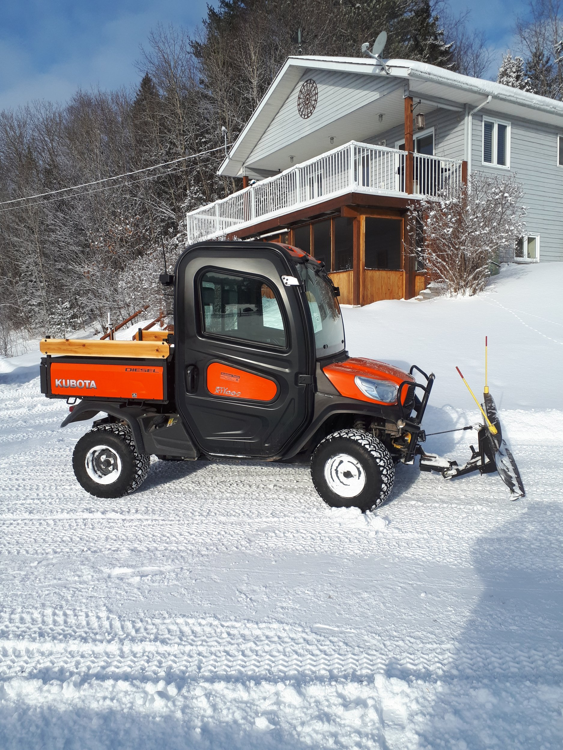

/ RTV1100 solutions? #7

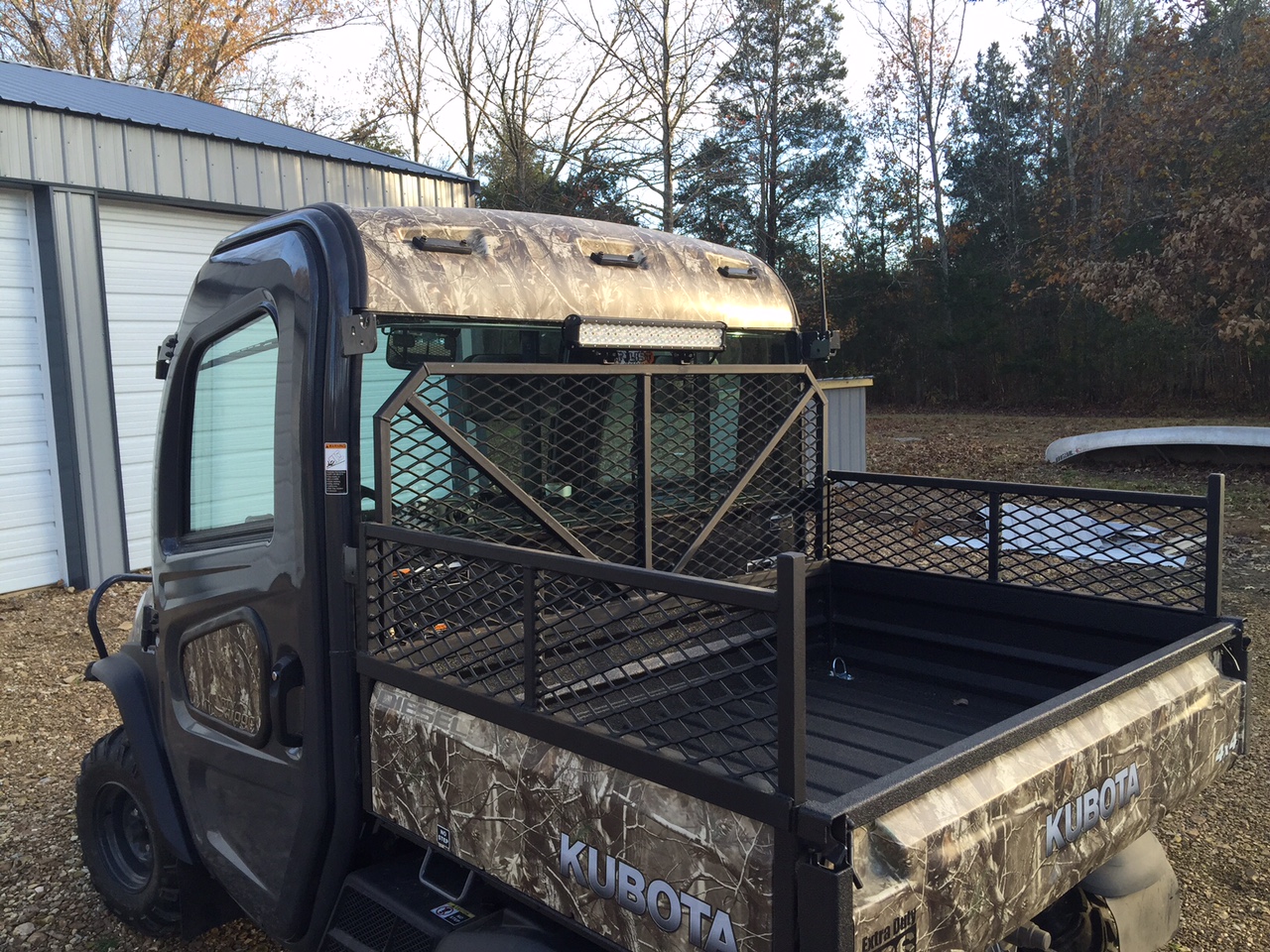

On my X900, and now my X1100C, I built a bulkhead and side extensions that work really well. If I hauled a lot of loose materials frequently I would add a firm rubber flap to the top of the bulkhead extension that seals off the gap between the bottom of the rear window and the bulkhead.

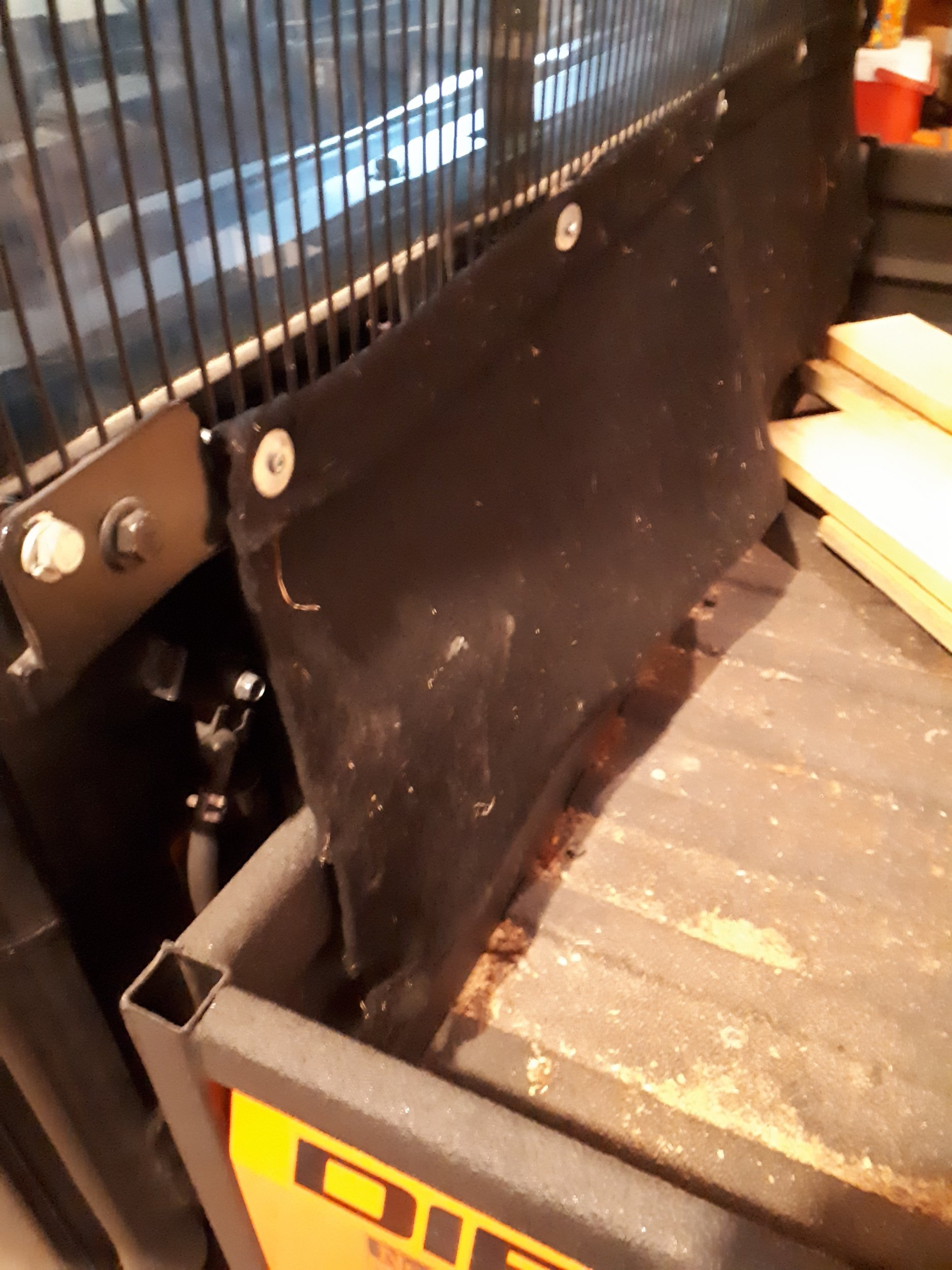

/ RTV1100 solutions? #8
I kept it simple, some heavy fabric ( black felt from fabric store) attached to my rear window screen. As bed goes up it moves out of way . When bed closed it us hehind , but with quick pull of corner it us back on inside of bed so hay or gravel etc won't get between window wall and bed wall.

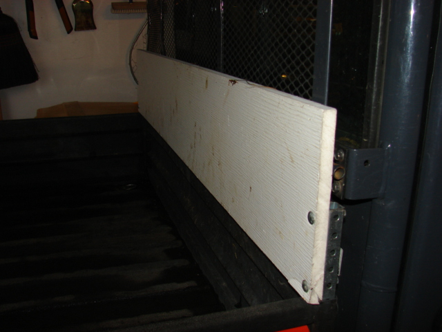

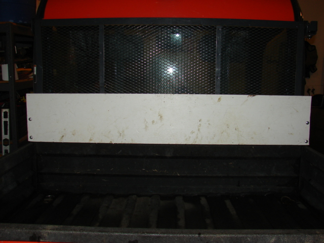

/ RTV1100 solutions? #9

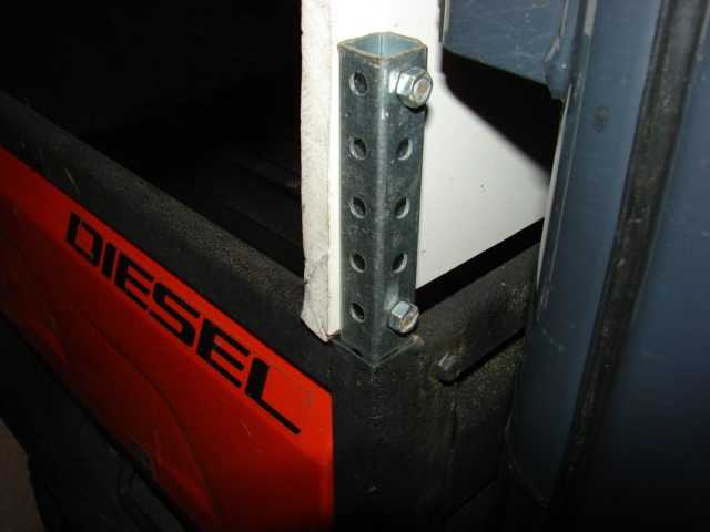

This was my solution. Square tubing with some scrap plastic wood (like trex) attached. Solved my manure hauling issues.

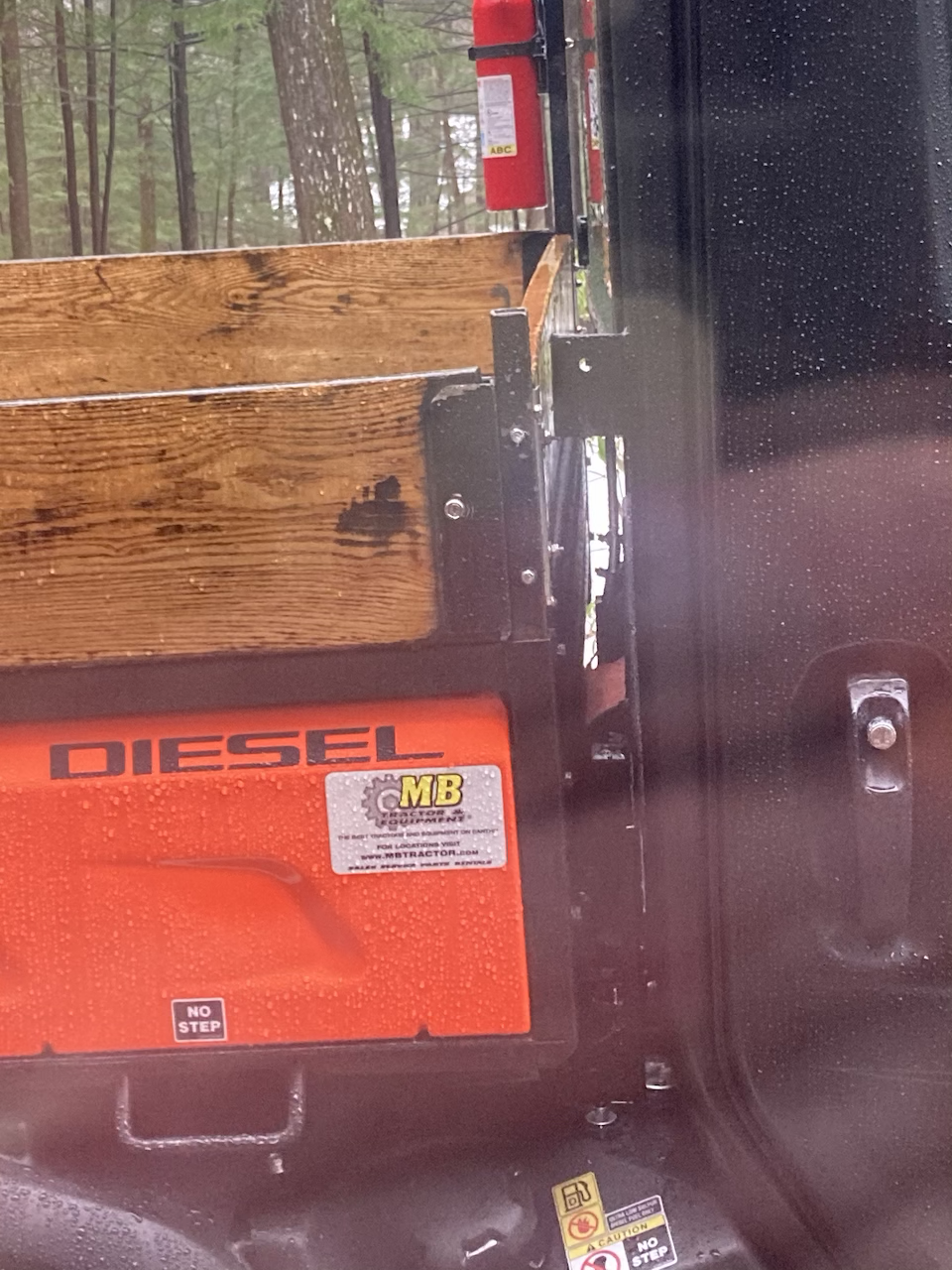

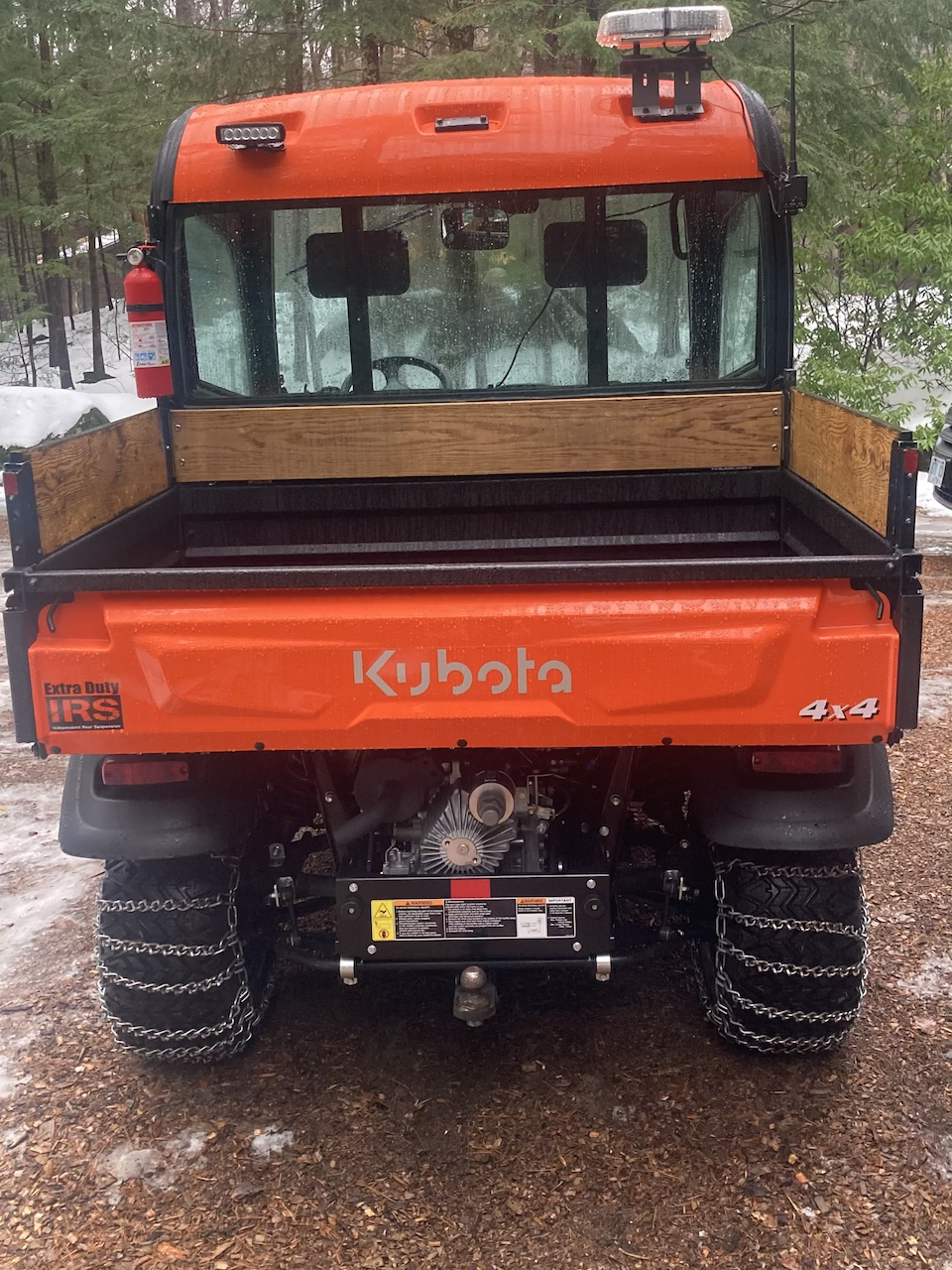

I added these cedar sides with hardwood stakes, for looks and to keep grandkids in. :)
