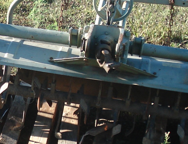

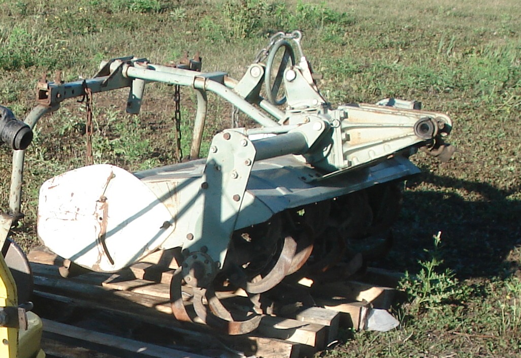

First picture is well worn original Yanmar tines. Second picture is the ones available now.

Well it's obvious now. I have the original tines, and they are well worn too! About like the ones in your picture. So I guess my work is cut out for me- removing them when I get the time, one or two at a time. Are the nuts important? As I recall they are well rusted. Might get a cutter for them- one of those screw-in jobs that wouldn't mess up the bolt. Or does the bolt matter? If not, it's going to go a lot quicker!
I sure appreciate the effort to take those pictures (even if they weren't just for me) and post them. I will not retire for another few months and I actually can afford the loss on this tiller, but I would feel a whole lot better about the whole thing if I could recover some of the cost. In other words, I wouldn't feel so stupid when I pull up to the recycle center with something I just bought! It wasn't until I really got to working with the thing that I realized the case was an oil bath issue, and that the break went right through a bearing race. I don't think it ever had a chance.
Thanks! I will post pictures when I get them, just for the sake of everyone's curiosity.

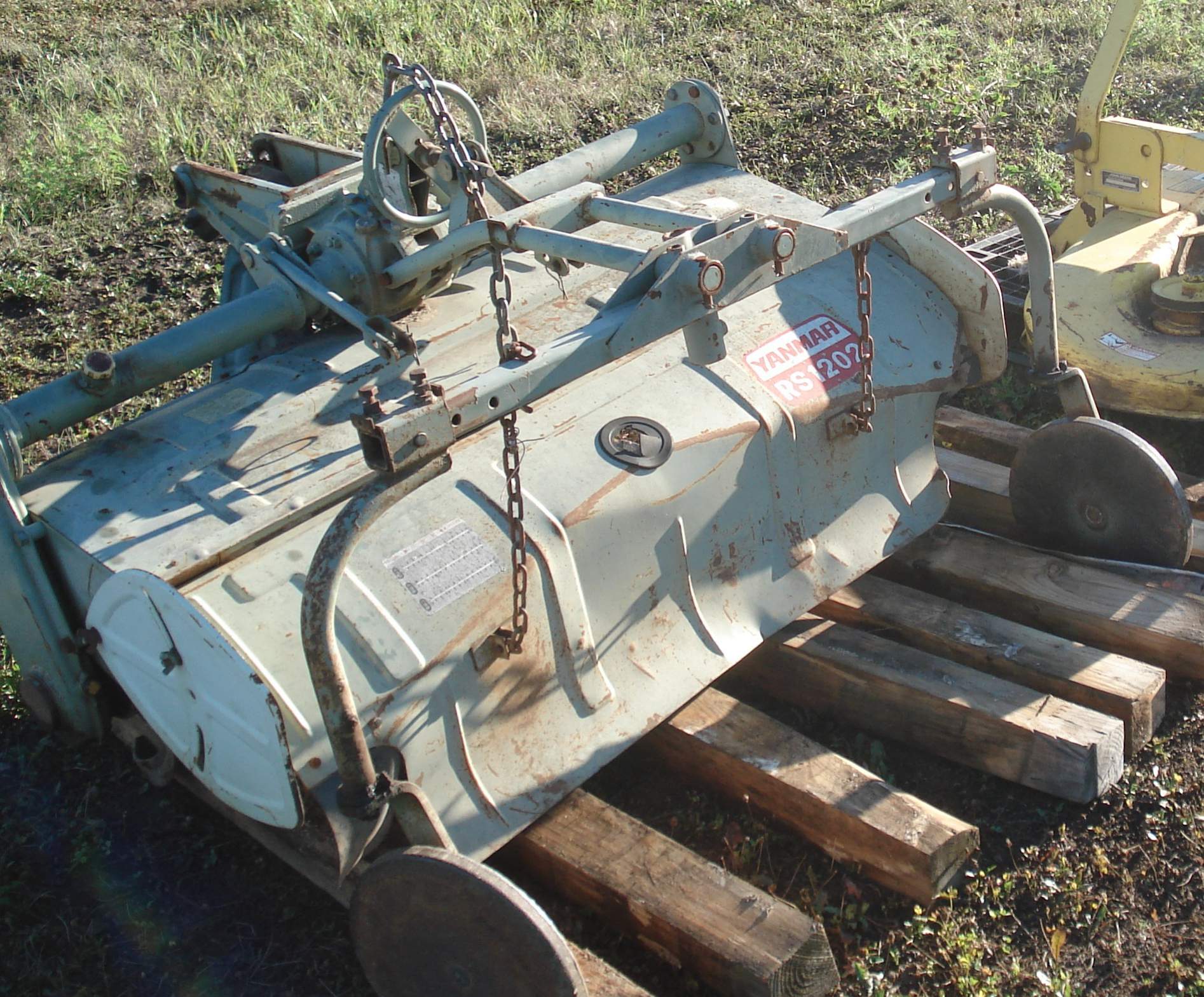

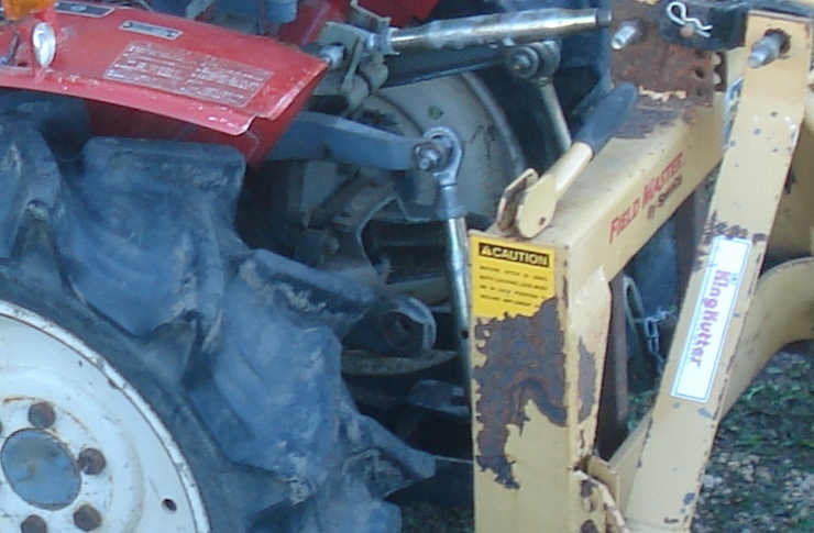

My 1510D came with a 2 point attachment RS1202 tiller. Here are a couple of photos. Sorry that you really can't see the tractor side bracket very well in this photo. It's very much like a shield around the top of the PTO with a couple of ears with holes where the bracket from the tiller attaches.

Whoa! I think I better stay away from these things- too confusing! I would not appreciate that if not for all the help. I am currently fishing in Wyoming but when I get back home, shopping for a different tiller will resume. Meanwhile, if anyone wants dibs on tines, they will probably start coming off next month. The short PTO shaft will also be available.
