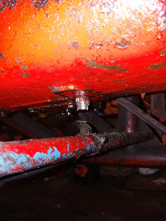

Pipe wrench has been tried again and again, both by myself and two others more experienced. Same result each time, material being sheared off the plug. If that result is due to improper grip and/or operator error, that's down to the lack of clearance around the wrench adjustment knob itself.

So pipe wrench is out. Dang, we have to think of something that will work.

The material the plug was made of is the problem. When time and the work load allows remove the obstruction and drill a hole then make 2 cuts 180ー apart with a hacksaw blade then the 2 halves will come out.

Actually, kidding aside, in any of the now almost 2,000 posts has anyone suggested THIS? Which is forget getting that plug out.
It's stuck tight! However (drum roll please), pick out a spot close by...and drill/tap a new hole!!!!!
Better location...away from that bar in the way. Start small, then working up to the correct tap size...then let it drain!!!!!
Next day tap it! No mess, fluid is gone.
I'd tap it slowly, removing chips.
Then pour kerosene or other cleaner through. New tap.
Fat lady sings, curtain closes.
FINI
Fill the tap flutes with grease and the chips stay on the tap

Cold chisel, sharpened good, applied to cut into the surface in such a way to produce torque to undo the thread. First direct blows to cut a notch in a close to radial direction, then when a good notch is established, shift the angle to being closer to tangential to the surface to make it rotate out. This is my standard method with nuts that strip out. In your case it is a plug, but apparently there is still a bit sticking out that one can access.

I had to replace fan clutch on my Ford truck a while ago. 38mm nut I think it was. I tried everything, nothing worked. Then I used my air chisel with it on left edge of nut corner. Wow! It turned, then next corner, etc. It spun off in a minute.
New one I installed with wrench, locktite on threads.
